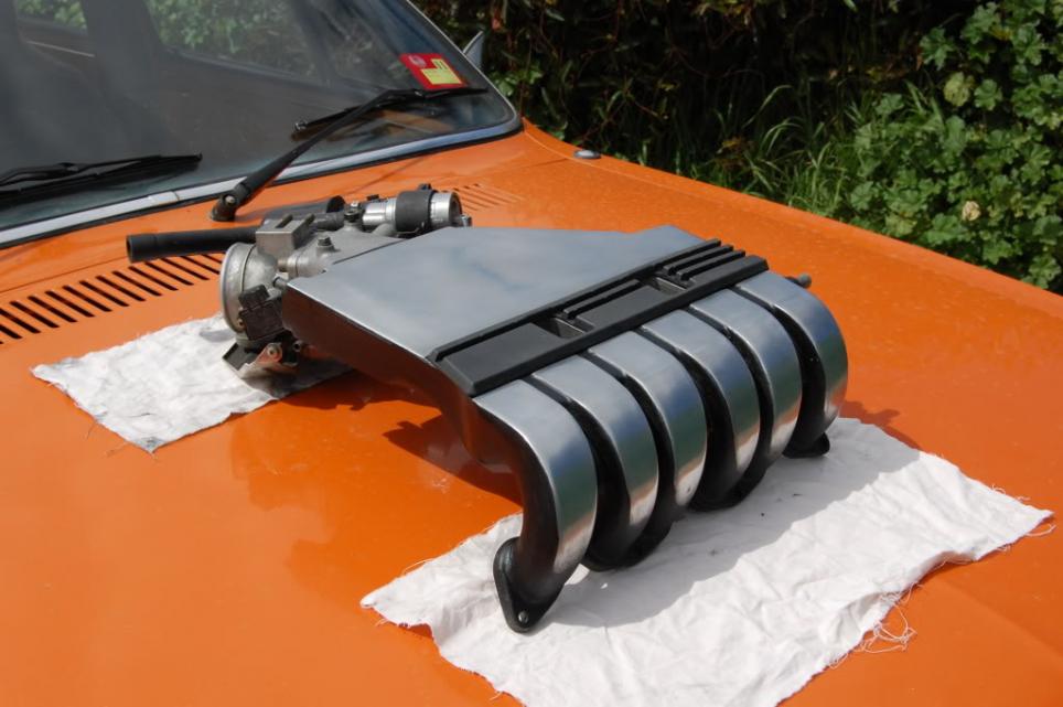

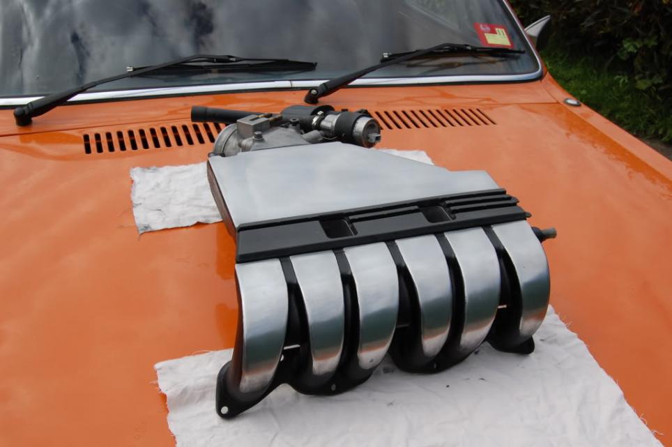

    well guys, while the VR is off the road (only for another week, yay), I thought id might polish my inlet manifold.
    So here is the progress. all i need to do now is buff it and do a little more detail.
    I went for the polished top look with black detail. Hope you guys like it
    cheers
    eric

    faaark thats nice man. so fricken smooth. loving the effort. it'll look freakin sweet back in there
      cheers buddy.
      yea i dont reckon ill be doing that again lol.
      cant wait to see what it looks liek in the engine bay. so damn keen to get this VR back on the road

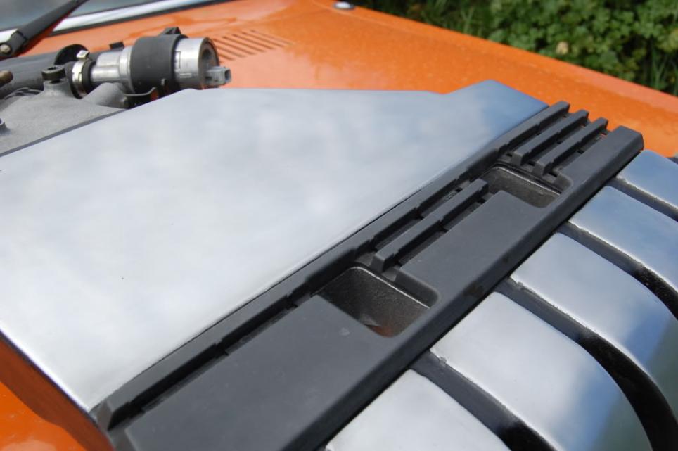

            thanks guys. i didnt polish all the way down cos, lets face it, with the fuel rail there and the manifold curving inwards, noone is gonna see it and less work for me lol.
            i didnt have access to an electric sander so it was all done with wet & dry sand paper and a block of corck lol

                Well i had it for a week so a few hours here and there. if you get an electric sander that will reduce the time heaps. the original texture surface is a nightmare to sand lol.
                just started with 240 grit paper and worked my way down to 1500/2000 grit. finished it off with a bit of mothers mag polish.

                      How did you do the black detailing? Mask/spray or brush?

                        yea i sprayed the grooves first. then sanded it. the black look grey after i finished with the sanding so i went over the lot with paintbrushes lol. bit of work but it was a beautiful day outside so i thought, eh...why not lol.
                        the line could be straighter between the paint and polish but ill play around with that another day. not long now till my head comes back from the reco shop woohoo....fresh new head...mmm..
