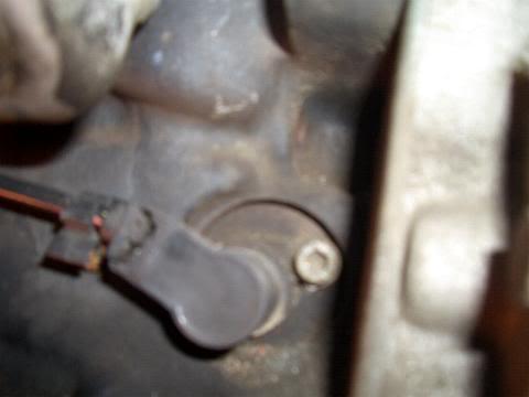

                  I remember I was quoted ~$400 from the dealers. Keep in mind this is just a sensor! Basically a cable with a plug on each end. This particular sensor on the 2.0L is only on the later models (ADY engine code) and NOT on the earlier (1994?) models (2E). The sensor is located just under the oil filter (slightly to the left). Using Jondarren's picture, I've highlighted it with the red arrows on the bottom of the picture.
                  Originally posted by Jondarren View Post
                  It's a bitch to get to and since it's locked in by a hex bolt, I had to remove the front engine mount to get to it:

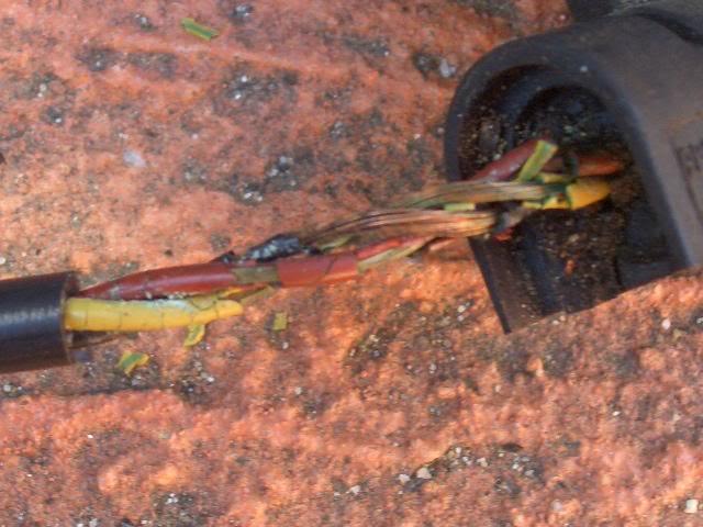

                  Note the condition of the wires.

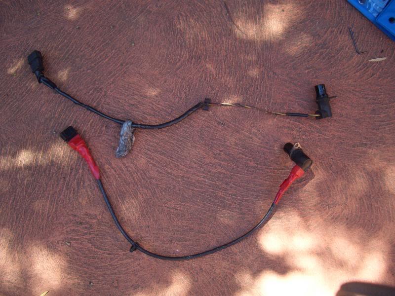

                  I managed to buy a second hand one from Matt (Golf Loon). It was still intact and the wire insulation wasn't flaking off but to make sure it won't fail me ever again, I wrapped it over and over with insulation tape. A year on and I've never had an engine electrical problem; the car starts fine every single time, idles at 900rpm always and engine rpms have never been jumpy, even on a hot day.
                  Condition of my old crank angle sensor:
                  Comparison:
