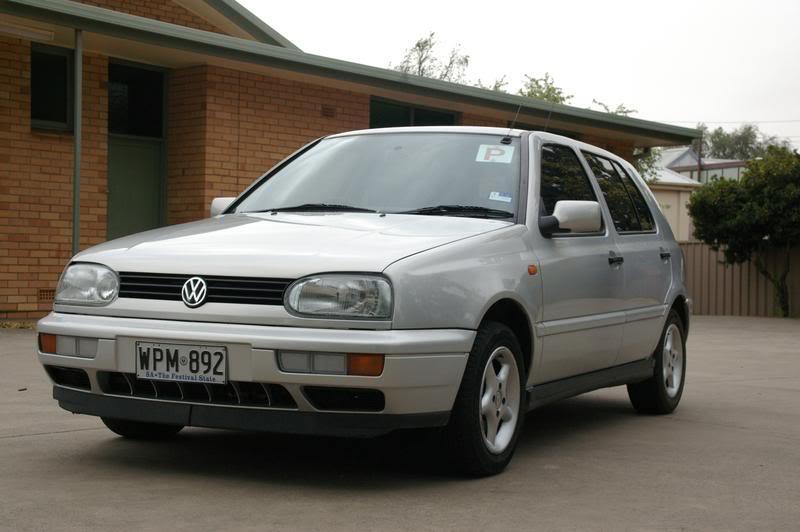

      CAR: 1994 Mk3 VR6
      SUSPENSION: Stock for the moment, but soon to be either HotTuning or something similarly priced.
      WHEELS & TYRES: Stock for another week Then will be 16" x 7" Audi wheels, and I'll wrap them in Kumho's or Falkens (205/45 16 87W)
      HEIGHT: Who knows, mine's high as a kite because of stock suspension.
      EXPERIENCE: my experience with stock height/stock wheels....well, i get front wheel slide when turning around roundabouts anything faster than snail's pace, and my car bounces all over the place. It feels horrible trying to fang it around a corner, at least compared to people's mk3's I've sat in when they've shown off their suspension
      PICTURE: not quite side on, but good enough I suppose.

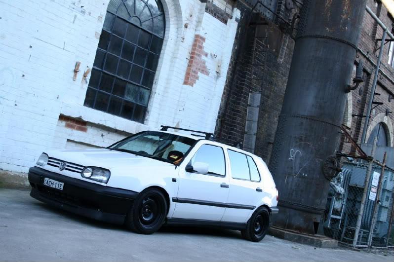

        CAR: Mk3 Golf GL
        Current setup
        SUSPENSION: Koni Specials (Red) struts, GroundControl coilover sleeves + GroundControl-Eibach custom springs (300lb front, 250lb rear)
        WHEELS & TYRES: Mk4 widened steelies, 15x8 ET25 front ET15 rear, Falken Ziex ZE329 195/50R15
        HEIGHT: I'd hazard a guess and say ~80mm lower than stock
        EXPERIENCE: Tyres are quite new so they grip well. Pronounced lip protector which helps make the tyres look wide and chunky. A bit of tyre noise though. Suspension has been good - not overly harsh but reacts to the slightest bump on the road. Body roll much reduced from stock setup. Initial turn-in is sharp but at high speeds, the car has a tendency to wallow through a corner. I think the struts aren't matched to the springs (spring rate higher than what the Koni Reds were meant for).
        PICTURE:

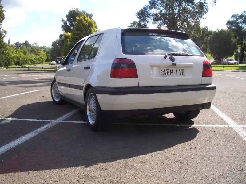

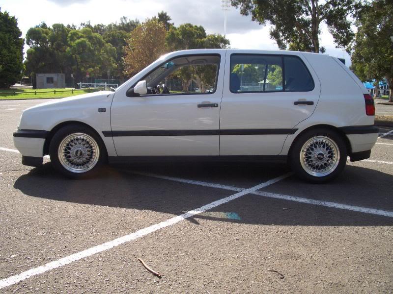

        Previous setup:
        SUSPENSION: Koni Specials (Red) struts, Koni lowering springs
        WHEELS & TYRES: BBS RS 15x6.5 ET45, Goodyear Eagle F1 GSD3, 195/55R15
        HEIGHT: Labelled 40mm - looked about right. After a few months they dropped down a little more, but not much.
        EXPERIENCE: Very tolerable setup. Not harsh at all and since the Koni struts are damper adjustable, I could really fine-tune the dampening force. Usually had it at the middle setting and it was very comfortable. Soft enough to take grandma for a spin, yet hard enough to give you the assurance that it'll stay planted on the road. The GSD3s have been the best set of tyres I've driven on. Grips relentlessly in the dry, and still does a really good job in the wet. Very quiet as well. Only possible downpoint is tread-wear, though I didn't get to use them long enough.
        PICTURE:

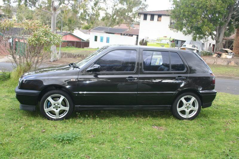

          CAR: 1996 Mk3 Golf VR6
          SUSPENSION: Dynamic Coilover Kit Gold from GCP in Germany @ AU$950 to my door
          WHEELS & TYRES: VW New Beetle 16" on black round tyres The fronts are Faulken, no clue on the rears since I haven't replaced them since buying the car.
          HEIGHT: Low. I think it's been dropped at least 3 inches, although there was never an official measure.
          EXPERIENCE: Excellent. The handling feels 100% better, nice and tight response to steering and grip seems improved. Note that I also put the Neuspeed front upper strut brace in with the coils so that helps I'm sure.
          Ride. Yes it's rougher, but with uprated shocks and springs it's expected. Not something I can't live with but depending on price I would consider slightly softer springs. Reality is that the coilover extravaganza will help to see if diferent brands make much difference in these stakes.
          Before:
          After:

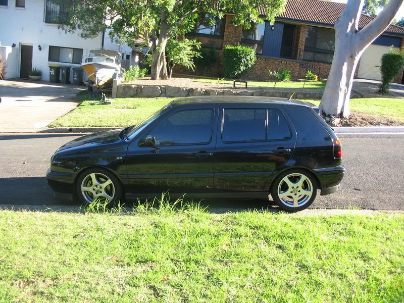

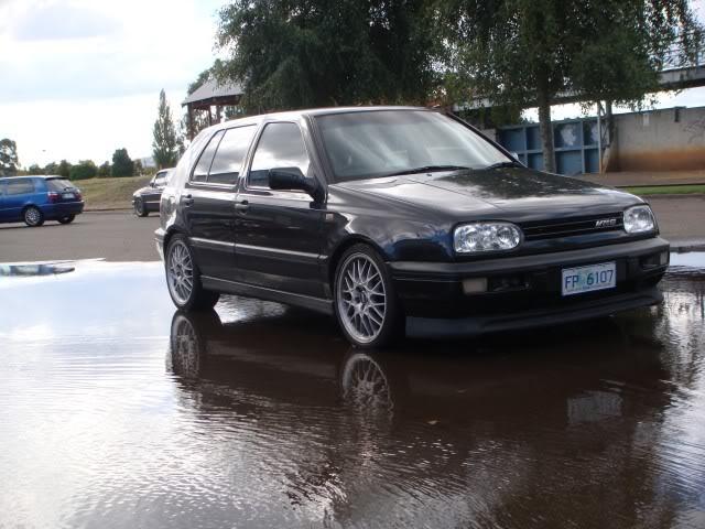

            CAR: 1994 Golf VR6
            SUSPENSION: Front: Koni yellow adjustable shock with unknown Eibach springs. Back: Koni yellow shocks with unknown Eibach springs
            WHEELS & TYRES: 17" BBS RN. 215/40 tyres. maxxis brand
            HEIGHT: Very nice height considering they are not coilovers. I wouldnt go any lower in my opinion
            EXPERIENCE: Great. This settup came with the car and I have no intensions of changing this settup. Handles very very well.
            Note: I now have the arch flairs back on so it looks even tighter.

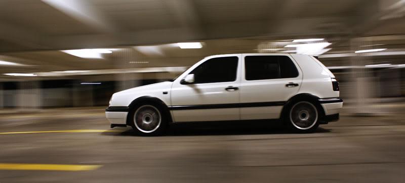

                      CAR: 1994 MK3 Golf VR6
                      SUSPENSION: Koni Red dampening-adjustable Shocks; Eibach Coilover Springs matched to Ground-Control Coilover Sleeves.
                      WHEELS & TYRES: Some Audi 16x7 ET42 wheels wrapped with 205/45/16 Kumho KH11's; 15mm spacers on the front - NOTE: atm I'm on mk4 gti wheels, 16x6.5 on the same tyres.
                      HEIGHT: Umm....really low...
                      EXPERIENCE: Yeah I like it it's not too bumpy considering how low it is, and it holds nicely around corners. I find it quite hard to slip out when the fronts have a bit of negative camber
                      PICTURE: I'm still trying to get the photo's from Friday night, but here's some older photos of my audi wheels (I'm refurbing them so they're not on the car for a while):
                      EDIT: And here's a pic from Friday night
