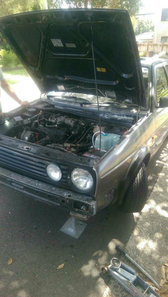

                        Hey paul, I'm going to try take it out right now and see if I can get to the problem. I'll keep yous updated
