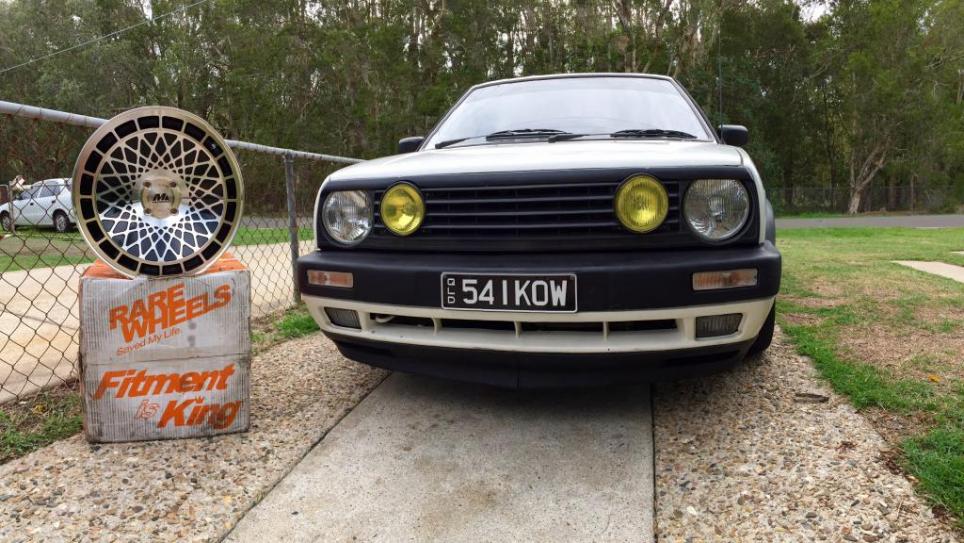

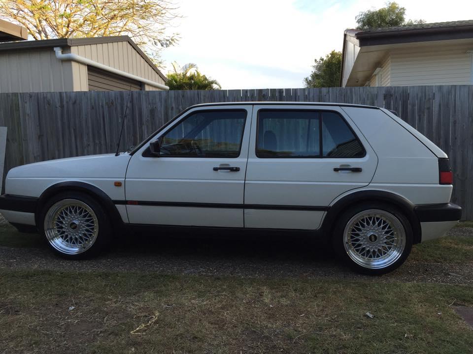

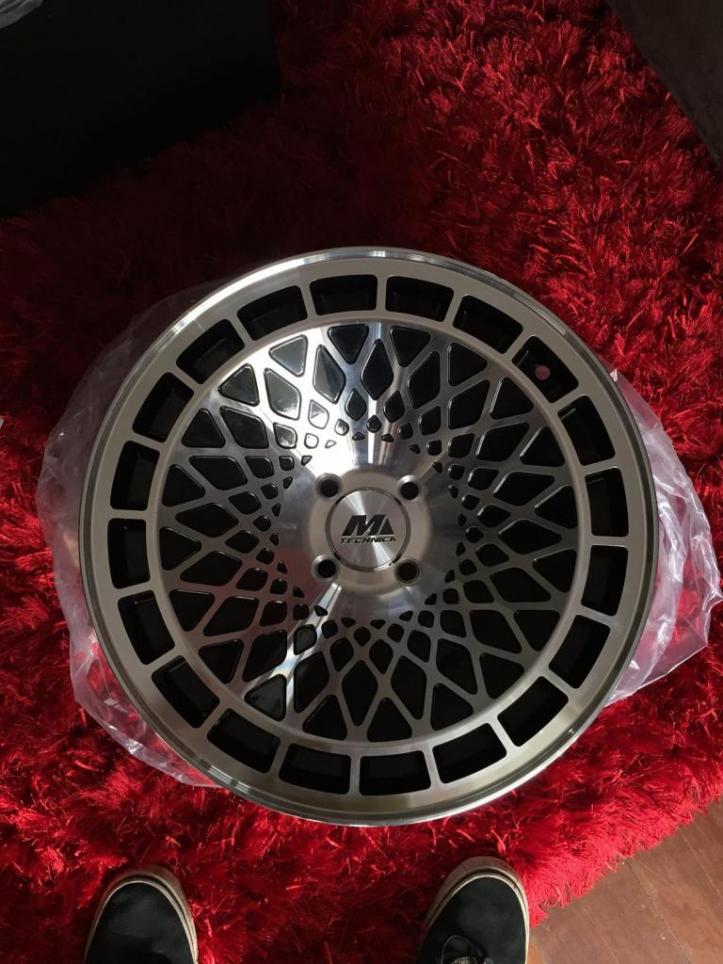

    In the mean time i shall attach some photos and show the progress of my little build thus far, have only added cheap coil overs to stiffen it up and accommodate the wheels I put on. Started with a set of BBS RS reps (17x8.5 +20) which were WAY to aggressive but did look and sit pretty. But now have upgraded to a set of Mtechnica Turbo's (16x8 +15) which i cannot wait to get onto this thing, as I'm in America for the next 5 weeks she is sitting in the car port on the little 15's it came with.

    16's are the best size, 17's only look good with ultra low profile rubber and dropped into the weeds. Not somithing you want to do with a daily.

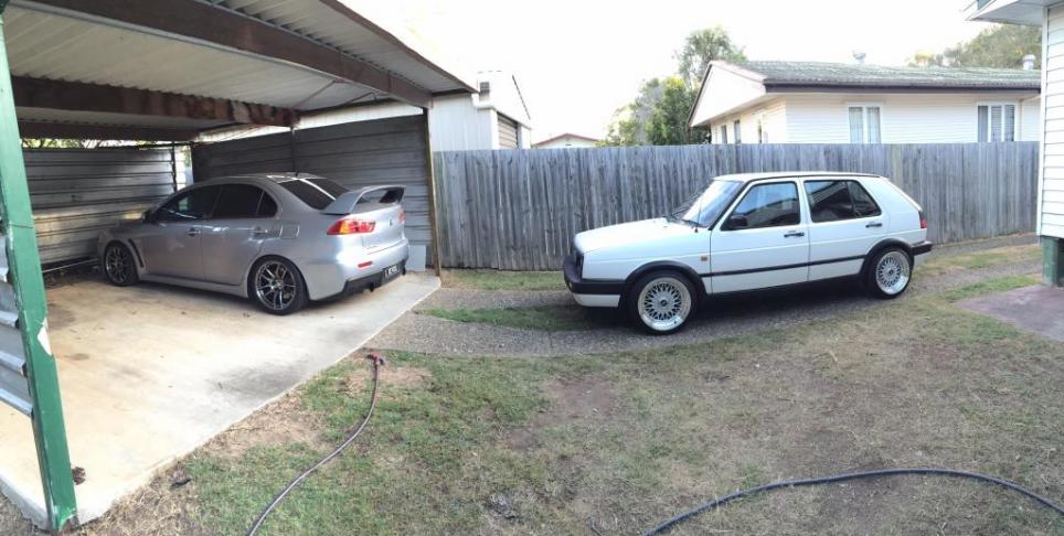

          BTW is that a legitimate Evo 10 in the background?

              And yes thats my Evo 10, the very fun toy.

                      Those Turbos look sexy!!
                      Will look great with your white and black trim!

                        Thanks man! Can't wait to get them on, I just got back from my trip to the states so shouldn't be to far away with tyres and setting up.
