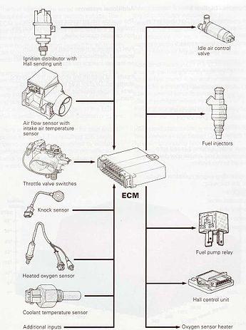

Also, you've all probably seen it, but I find this chart helpful when diagnosing.
Digi2 in/outputsLast edited by ryana89; 30-01-2013, 11:16 PM.MK2 - *Insert list of dealer purchased extra's/standard features here*

Thanks for the graph but all of that has been fixed.
o2(lambda) has been changed, also the temp sensor has been replaced(twice), EcU replaced, hall sender and knock sensor are functioning too. But worth another look. Otherwise off to the autoelec...
Hi thanks for the graph,
I have done all the above and in regards to the lambda(o2) sensor I used one out of a ford V8 and trimmed the fittings(its the same 3 wires 2 black 1 white).
Worth another check though. I have simply checked all the above for continuity which the show on a multimeter...
My next question is what range should I be looking for on the above? My blue temp sender has 5 ohm resistance, same in the wires regardless of which sensor is in....
Cheers
