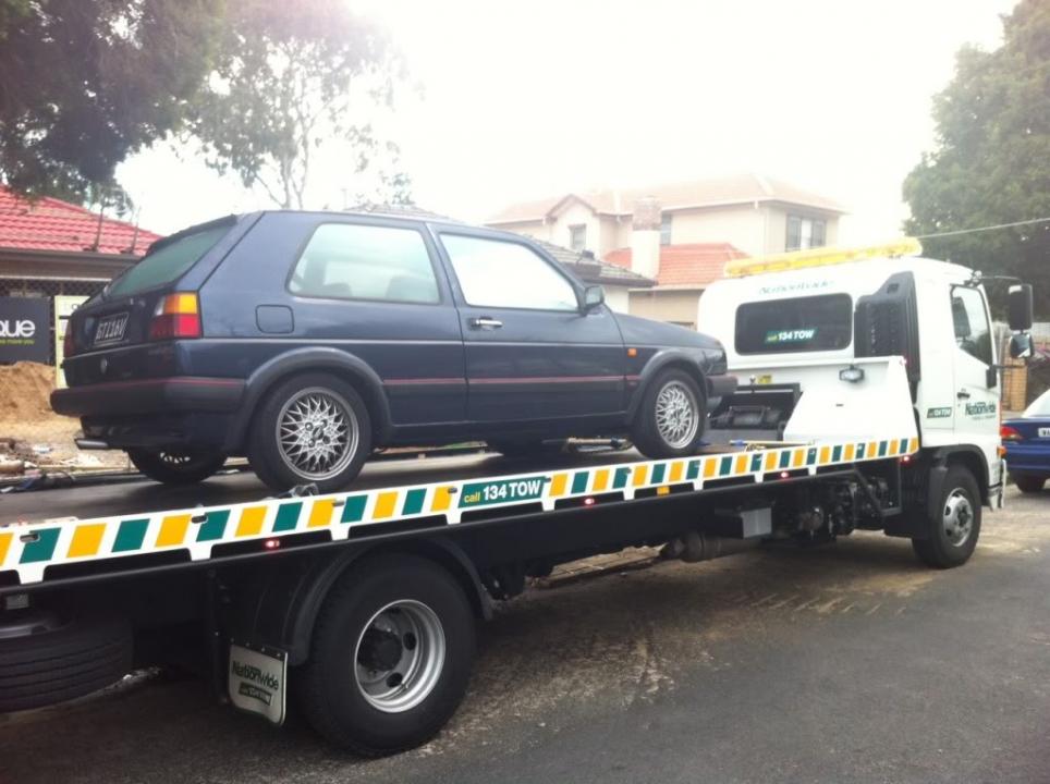

                    such a sad sight her first ride on a truck
