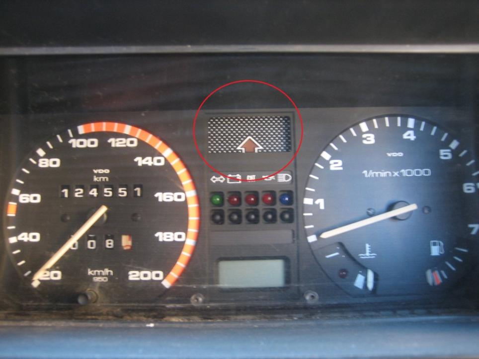

    Hey guys, i have a mk2 dash in my mk1. I've always been curious what this guage does, or indicate. I've never known and have always wondered what it was for. I thought it could have been for fog or something, but wasnt sure. Anyone able to give me a description on it? Cheers

    George, you've got a rare cluster there! (with the fuel/temp being vertical)
    That arrow indicates/flashes when to change 'up' gear (if it's all wired up right)

      Wow !! Thats awesome, thanks man. I just did a google images search and i see what you mean about the vertical fuel and temp. I wonder where i can find a diagram to wire up the up gear. Im assuming i need to wire it to my tacho/rev somehow

        Wiring up can be the fun part.
        Electrical Systems
        Kinda hard to explain but that link should do it.
        Depending on the era, MK2 clusters use inputs from various sensor/switch's as-well/or the ECU (ie MPG, AVG etc)
        If you don't have it already, you will require the proper 28pin plug/s set-up that connects to the cluster.
        Please correct me if I have said anything wrong/misleading*

          Yeah 7k/rpm and 200kmh is perfect for a tuned mk2
            Cluster
            Ive got a very similar cluster in my early mk2 and that gauge is the mpg indicator. Operates by vacuum I think.
            Also mine is in mph
