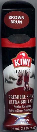

                    ive had my car just over 2 years and i think ive used the kiwi shoe polish about 3 or 4 times to black-en the bumpers. lasts ages and does it perfectly.

                          Kiwi shoe polish. I did all the trim on my car late last year and it still looks great.
                          Same as that bottle but in black obviously.

                              Any further comments on this Kiwi black liquid polish? I like this idea since it's relatively quick and easy. Also as I understand it may just permeate the plastic a bit helping with the blackening?
