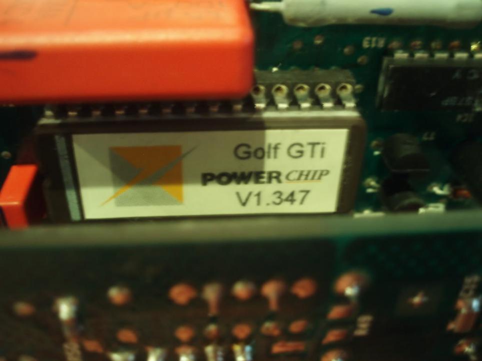

To get access to the chip we want to change we first need to unscrew to the two screws on the right hand side (you can see one on the top right is already done) and gently pull off two black plastic heads (you can see one on the top left is already done)se we can split the two boards.
Now at this point I do not have more pics, upon opening everything up I discovered that my chip is in fact soldered into place. My understanding was some units have a chip terminal and some are soldered in, unfortunately mine is soldered in.
Rather than attempt to remove the chip and solder in the new one I have been advised to get down to Jaycar and get myself a terminal which i can plug the chip straight into. When soldering in a terminal as opposed to a chip you minimise any damage that you may do to the chip. The reason is; when they are soldered in originally, it is done by machine, thus the chips exposure to heat via the solder is minimal. In doing it by hand it is likely that you will be exposing the chip to excessive amounts of heat thus frying the inside!!
So the outcome... well I had to put everything back together, plug it all back in and now arrange a time to get down to Jaycar!!
Anyway stay tuned, for the remainder of this project. Any feedback, corrections ect would be appreciated.
