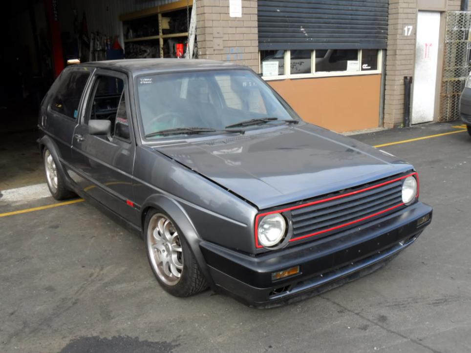

Its being built to a spec for a customer, who sent the car up from Melbourne.
The car is John Golfers old 2 door, that rolled in here with a tired old 8v engine and a faulty kjet system.
Crappy shot of the beast on a hoist

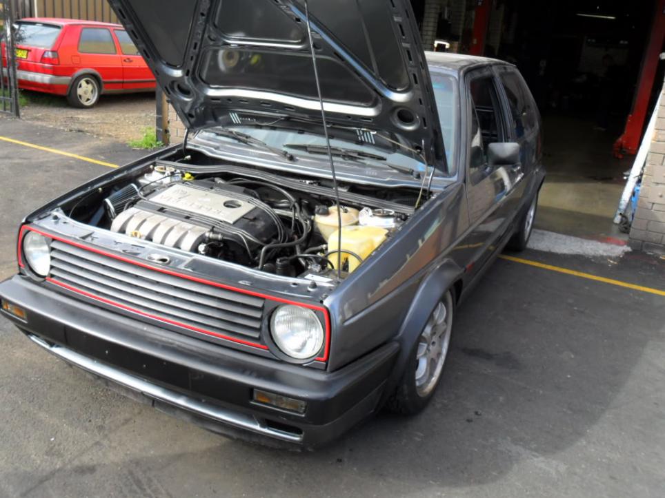

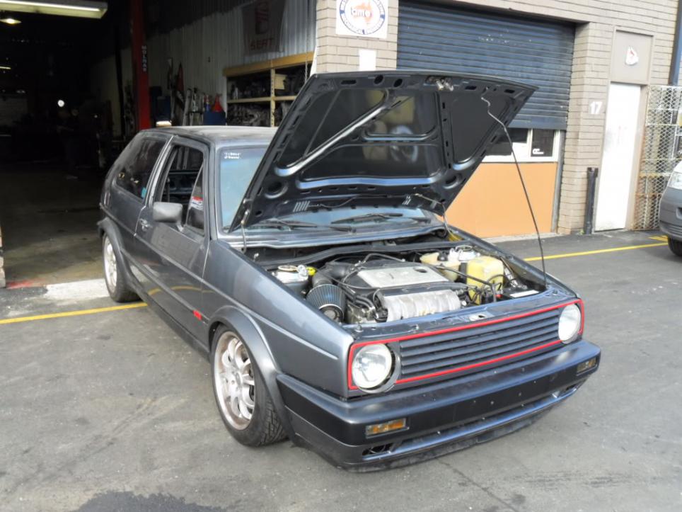

Sneak peak of whats cooking under the bonnet
