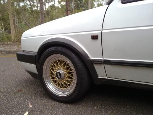

        • #19
          Looks great, wheels are sweet. 15's? 7's or 8's?
          but dare i say it
          needs to be lower

            • #21
              looking very nice mate. Those wheels look like they might be RS031 maybe? Are they 2 or 3 piece?
              You could drop it a little haha. mine is about 25mm lower than that and I dont scrape... much

                  It is 3 pieces, not sure what exactly RS0xx though, cos it has been redrilled. I can only see RS0, the last 2 digits have been drilled through.
                  • #24
                    Ah ok, if they're 15x7 and ET25 offset they'll be RS001's provided the lips haven't been changed at some point. Oh and the centre cap is the threaded screw on type.

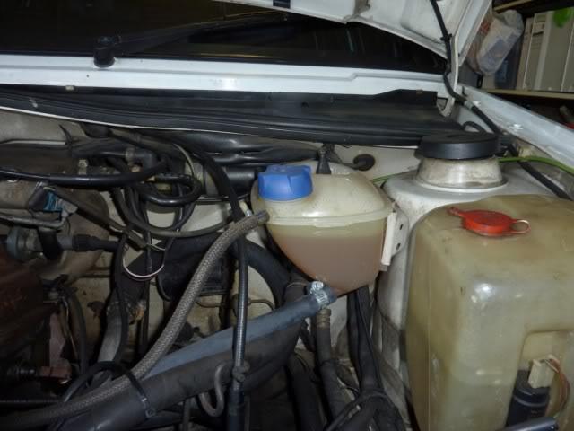

                      This is every Mk2 owner should do, $25 a brand new coolant bottle + $15 G12+ coolant, make your engine bay a fresh look
                          I might follow Wade's (GOLFBALLS) lead and do that too, considering the new pretty pink G12++ can barley be seen in the overflow.

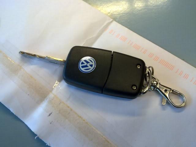

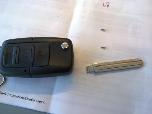

                            Mk4 style keyfob install
                            I'm sick of the 15 years old alarm keep playing up so and the remote central locking only works intermittently, so I bought this cheap keyless entry kit Remote Central Locking Kit VW GOLF mk4 mk5 POLO HAA key | eBay. I like the Mk4 style keyfob

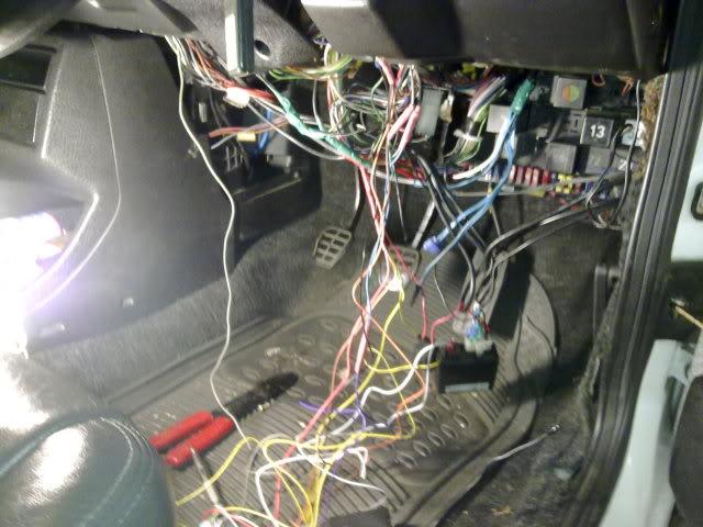

                            I don't really need alarm anyway so first to remove all these junk
                            Wire up the new keyless entry to my after market central locking is straight forward
                            Mk4 lookalike keyfob, removed the 2 tidy screws and pull the key out
                            Dremel is my best friend
                            Use JB Weld to glue the key back, I bought these VW logo badge from a fellow forum member (I can't remember who), all done.
                            At the end, very happy with the remote key, it can lock/unlock from 50 meter away
