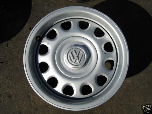

            G60's look like this;
            They are 15x6 but can be widened to look like this;
              A standard Mk2 aussie steelie is 14x6 et35
              A G60 steelie is 15x6 et35

                that mk 3 doesn't have G60/corrado steelies. the bolt holes are more trapezoid rather than round holes, and came in 4 stud, and 15x6 et (I believe) is around +35 . those ones one the mk 3 are probably beetle or mk 4 steelies.
                mk 2 GTI's that came here, came standard with 14x6 steelies, with the round holes, et38.
                  I knew that was coming, as soon as I posted the pic i noticed they were 5 stud....

                          Good luck finding corrado steelies.
                            It's pretty unlikely you'll find any , but the MK3 Passats had the same wheels as the Corrado.
                            15" (Yes 15" !)
                            4x100
                            ET 35
                            1996 MK3 Passat
                            Corrado Winter wheels
                            Part no. 357601025M
