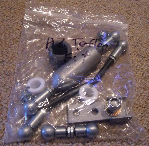

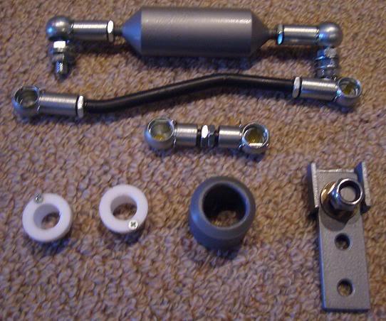

I was doing some research trying to find an upgrade kit for my shift linkage, Found a nice looking one on TSR but they've closed down. And when trying to find a second hand one someone from the Club Gti forum put me onto this mob so I've ordered myself a kit. Am told they're very worthwhile on a mk1,2,3 with shift rods.

I fitted a dieselgeek repair kit to Robins mk2, that's pretty cool. Also, you can shorten the throw on mk1s and 2s by bending the bracket that is bolted to the gearbox.
Basically reduce the distance between the ball at the bottom and the hole in the top of it.
Dead easy to do with a vice and a lump hammer!!
This is a better solution though, Shortening the gearbox linkage makes the shift notchier, due to the reduction in mechanicaladvantage. The ebay one while using longer levers actually gets the job done the same, without the notchy feel.
