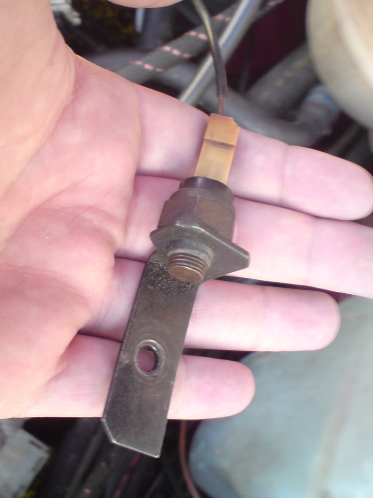

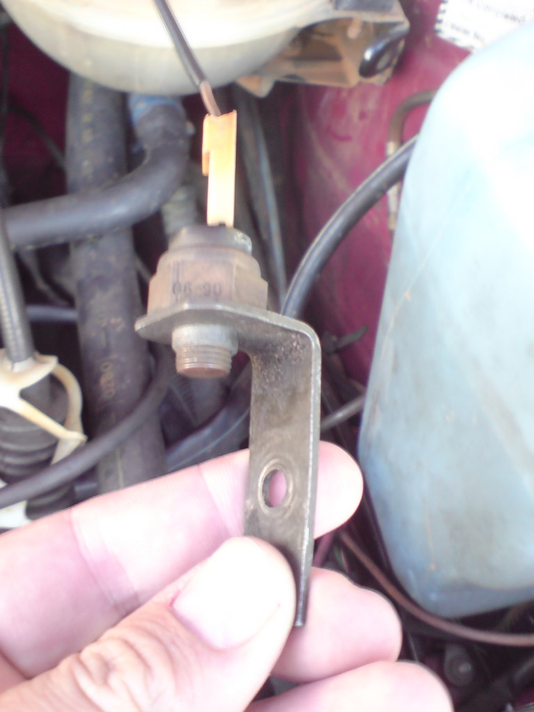

                            Final bit
                            I have one more thing to bolt on and everything will be apples. It's some sort of temperature sensor that seems to control the radiator fan.
                            I thought it was the intake manifold but it just kept the fan on
                            • #29
                              Attach it on the rocker cover under the far right rear nut.
