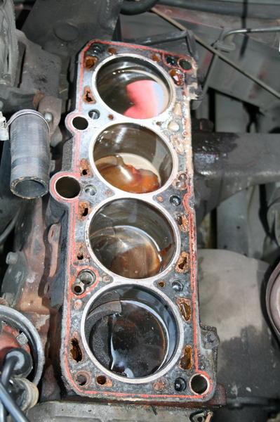

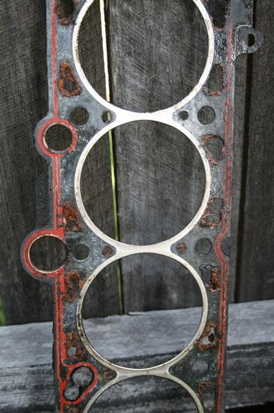

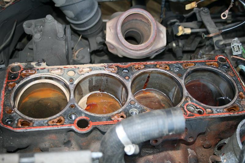

As the diagnosis continues, a top up of the oil revealed the "milky white paste of death"
Quite certain the head gasket needs replacing. It would explain why I am slowing losing coolant even though a pressure test showed no leaks.
Also it has been burning oil and heating up since my brother had it from thursday which also adds to the head gasket being the culprit
So can anyone offer any advice when replacing it?
Gonna be going off the Bentley Manual.
