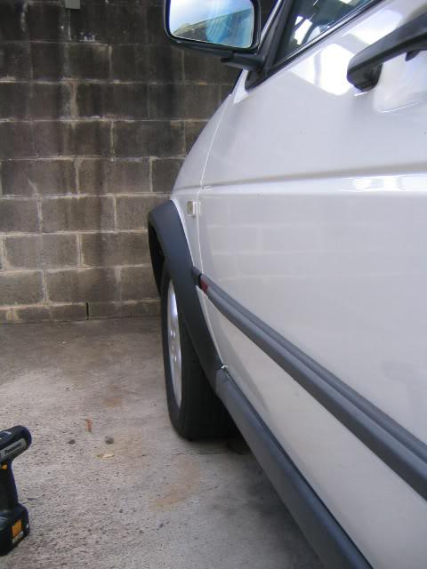

    Has anyone installed these on their MK2. If so i have a little question. With the tabs on the LH Front & RH Front Flares that would normally click into holes in the guards. Do you just cut them off and sand them flat to make them sit flush wiht the guard? As i dont want to stuff them up and it seems like the most logical thing to do. Just after some info from someone who may have done this already.
    Thanks...LVD
    I think most just cut them off, rivet the flares in as normal and they seem to fit fine.
    The cut out is slightly visible unless you mod your wheel arches. I was thinking of just cutting my guards to match the G60 flare cut outs at the top of the arch, dont know what others really do for that part.
    sigpic MK2 GTI G60
      i just cut them off the set i had
      Originally posted by Preen59
        cute mine off too, no worries Have done that with 2 sets now.
        But don't cut the resting pad off, just the part that would clip through the fender metal.
        mk2 GTi 16v
        Corrado G60
          Schweet.. Thanks.
