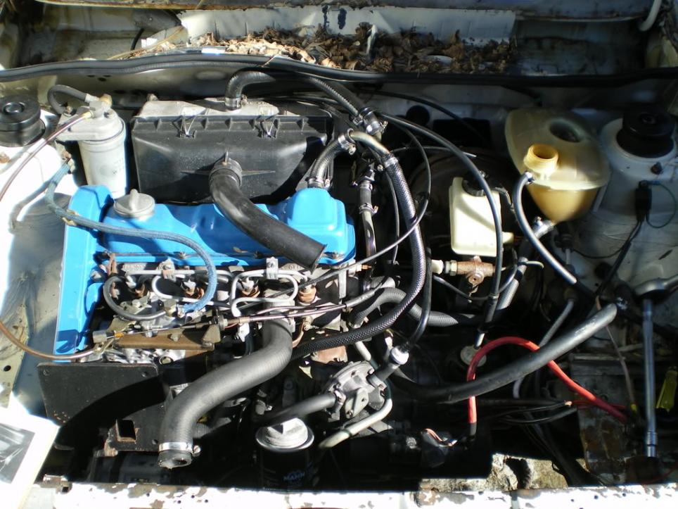

    I have now decided to go ahead with this idea after purchasing the diesel mk1 about 3 months ago in Melbourne and driving it home to Sydney. It's got a recently reconditioned engine however the body, whilst not having terminal rust, does have some surface rust and a bad cost of house paint which i can't really be bothered rectifying.

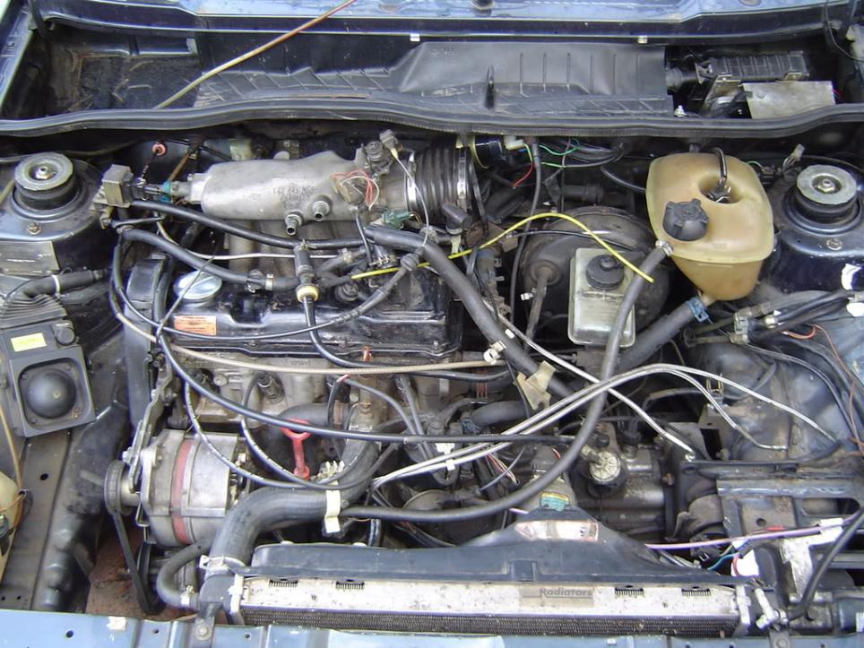

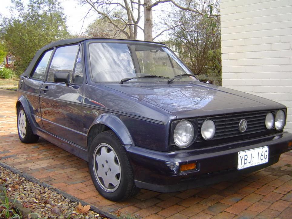

    So, a couple weeks back in Canberra i spotted a later mk1 cabriolet for a bargain due to a fuel supply issue. I thought I may be able to sort it out down there drive it back and then think about the engine swap in a few months. But i'm completely new to injection systems so the swap goes ahead right away down there.
    I've spent the day getting everything i think i will need out of the diesel with the engine ready to be dropped in the morning after i get the drive shafts off. Everything else is in a box and so i'll drive down to Canberra during the week to give it a shot. A blindly guided shot - This is my first ever engine swap! Let alone petrol to diesel complications.
    The diesel looks so straight forward. Just the stop solenoid which i believe i can power off the coil (but not sure where to connect, before or after coil?) and the glow plug relay which i'm still tracing throughout the car. Apart from this i'm hoping all pressure switches, thermostats, reverse switch, fan and alternator wiring is pretty similar between the two.

        Mate, get rid of the coil altogether, and hook the power wire to the coil (which comes from the ingnition switch), to the stop solenoid. Too easy.
        Now, i don't have a glowplug relay in mine, but i reckon you could splice that same wire as the control wire for the glowplug relay which you will have pulled from the diesel..

          They are special edition Rivage Wheels on the Cabrio. Nice

                  Have done a couple of DSL conversions into cabs for customers and it is pretty easy.I know that cab in Canberra and it is a perfect candidate for a conversion.If you need any help while in Canberra give me a yell.

                      Thanks for the encouragement. Diesels out and sitting in the back of the other car ready to drive down tomorrow. I have access to a garage in canberra and will take my own tools and probably hire a lift rather than mess around with jacks and two engines. I've been reading up on these swaps on the US websites which all say my 5 speed won't really suit the diesel engine so i'll probably keep the 4 speed for the moment being.
