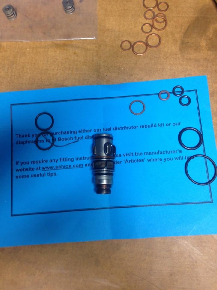

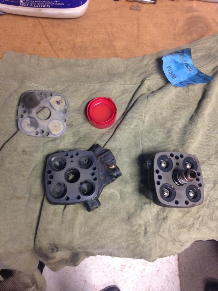

              Received the Kjet rebuild kit and straight away started stripping the fuel distributor . The kit I bought was the Salvox brand and pretty happy with the quality.
              After installing everything I started the car up. It ran smoothly for 2 minutes and as soon as it's under load it started with the hissy fits again. Absolutely no change.

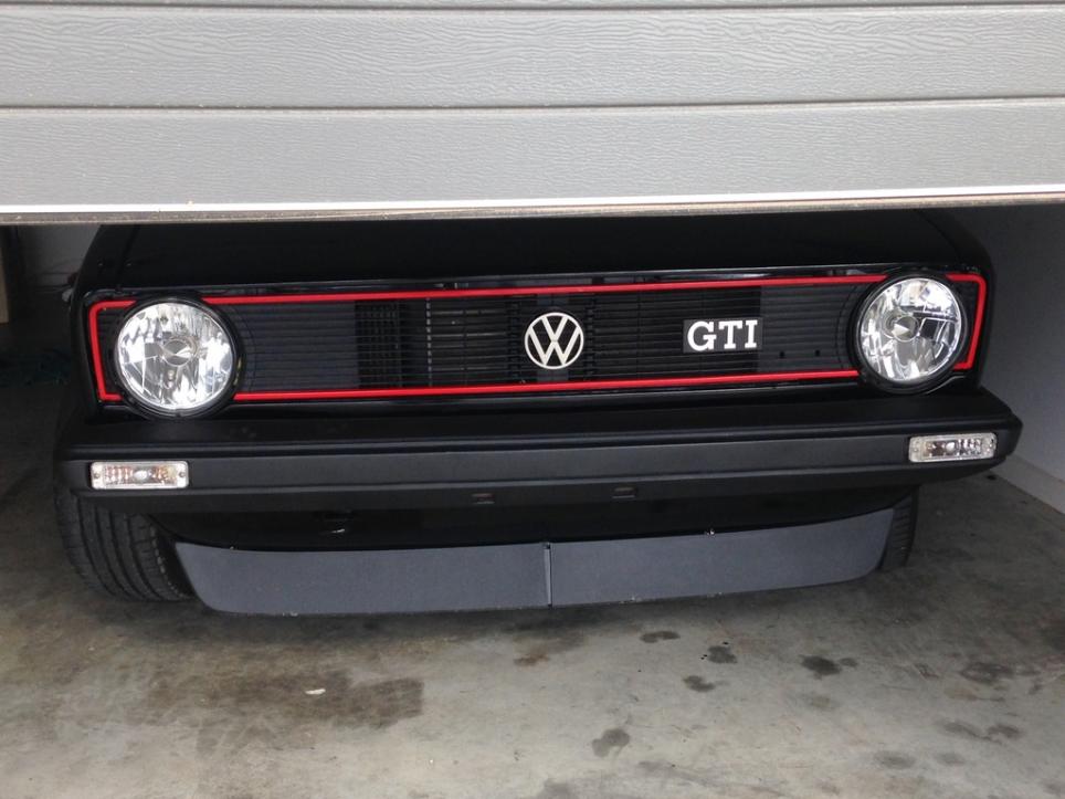

                    So another month has passed and now the GTI is running!!
                    Long story and I'll go into it another time but for now it's passed roadworthy and on Victorian club plates. Still a few little gremlins to sort out but so happy to reach this milestone.
                    Blood, sweat and hundreds of beers!!!
                    Little teaser

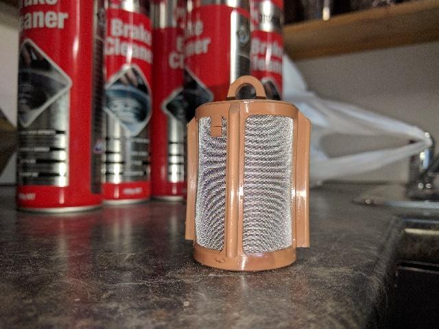

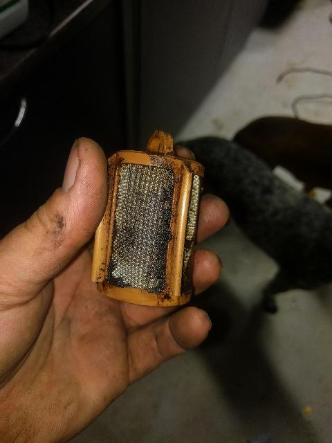

                          Ok gents so this is what happened ..... When I refurbed the fuel tank I used a fuel tank sealer. To be honest it worked great, maybe too great! It worked so great that it blocked everything in the fuel tank. So all this time we've been changing k-jet components over and mucking around with fuel pressures and tuning when a matter of a fact we had no fuel.
                          Yes maybe a rookie mistake but trust me it will never ever happen again. Only realised it when I ripped the fuel pump off and almost no fuel came out.
                          Everything inside the fuel tank was blocked, lines, swirl pot, filter you name it.

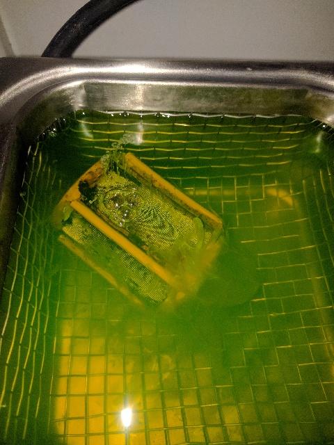

                          Filter got a quick clean in the ultra sonic cleaner, and good as new.
                          Luckily lucky13 supplied me with another fuel tank and bang its running!!!
                          Also done the door seals, and replaced rear wheel bearings. Still a few small gremlins, but man it's great driving a mk1 again. The stickers/ decals are finished to but I'll wait before I'll stick them on. Not 100% happy with the paint , so might need some rework before the GTI stickers go on.
