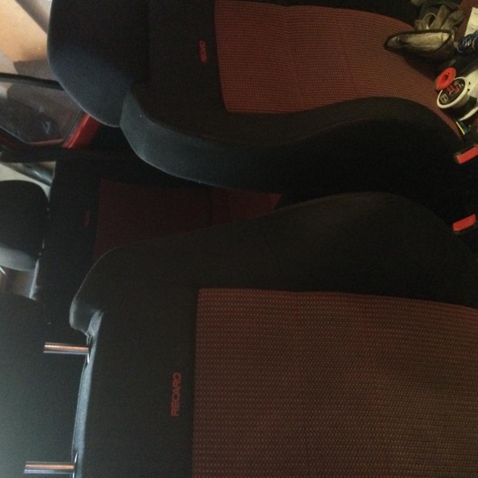

Cheers HaydEn and George, the seats were fun to fit, the fronts are on the original chassis runners at the back though narrowed down on the inside mount by around 30mm. The front mounts are mk4 welded into position. The rear seats use the mk1 frame with the foam and fabric wrapped and fitted. Yeah the cable shift is fantastic and with it running internally i had more room for custom extractors aswell.Originally posted by GeorgeMK1 View PostAwesome work mate! Mk4 gti seats? And also.... just how much better is the cable shifter as opposed to the rod linkages? Amazing right !!Last edited by twin eng, twin turbs; 10-11-2016, 05:03 PM.sigpic
