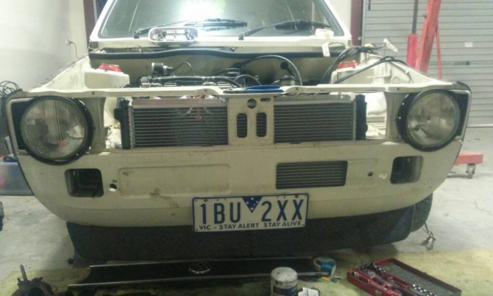

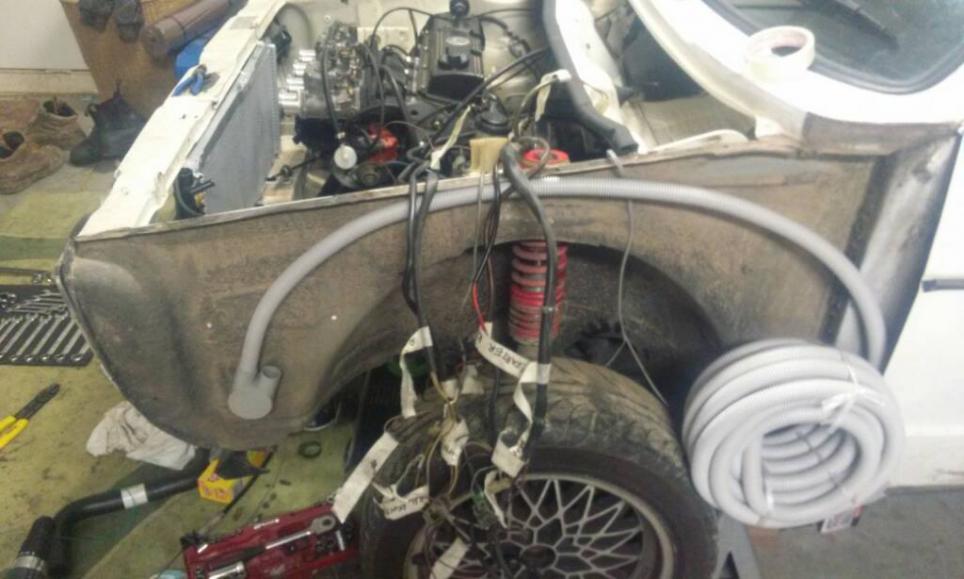

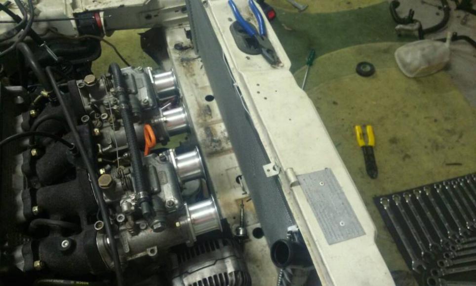

Any guesses as to what's going through here...
Big weekend ahead I think. Stay tuned77 Mk1 GLS 2 door - That sinking feeling
76 Mk1 Swallowtail 2 door - Replace that BMW & 76 Sweetheart

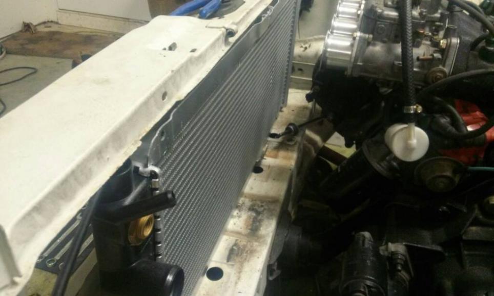

Let me guess, hot water plumbing for the rear mounted washing machine?
Sorry, couldn't resist.

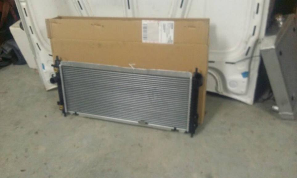

Radiator looks like it was made for the MK1.1978 MK1 2.0 16v http://www.vwwatercooled.com.au/foru...-46488-70.html
Originally posted by sports racer View PostLet me guess, hot water plumbing for the rear mounted washing machine?
Radiator looks like it was made for the MK1.77 Mk1 GLS 2 door - That sinking feeling

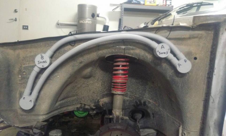

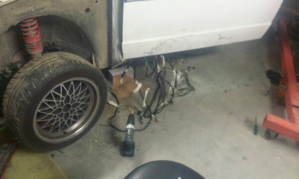

Here's the plan for the weekend in a few words.
Fix this
And run it through there
How come no one told me how difficult this was going to be...77 Mk1 GLS 2 door - That sinking feeling

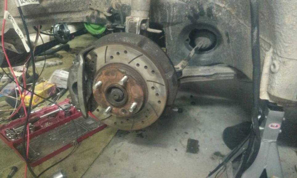

Before...
After...
239mm gti discs and calipers just became 280mm g60 discs with calibra v6 calipers.
I'll let y'all know how they perform once the car is in its feet again77 Mk1 GLS 2 door - That sinking feeling
Are you using adapter brackets to fit the calipers or do they bolt to the same place the old calipers bolted to? Pix please.1978 MK1 2.0 16v http://www.vwwatercooled.com.au/foru...-46488-70.html
Originally posted by sports racer View PostAre you using adapter brackets to fit the calipers or do they bolt to the same place the old calipers bolted to? Pix please.

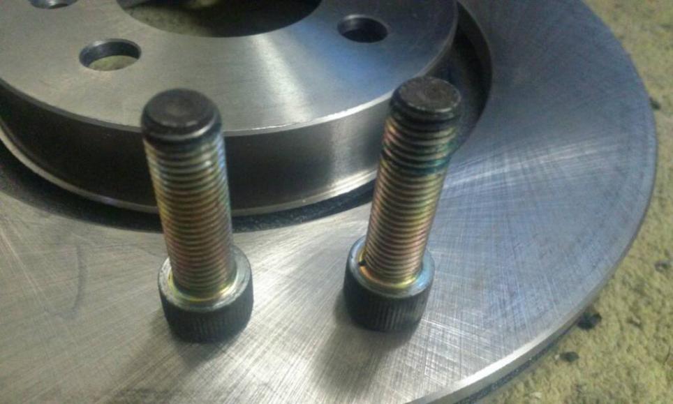

Only thing you need to get them to work are shoulder bolts to step the thread back down to a m10, but still hold firm in the 12mm holes on the calipers. I'll make sure I take lots of photos and part numbers for those who are interested.77 Mk1 GLS 2 door - That sinking feeling

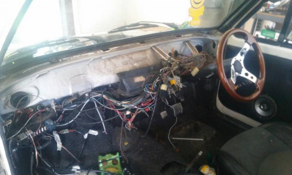

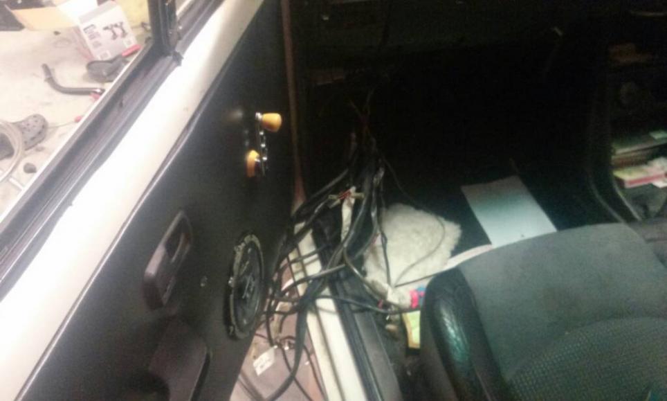

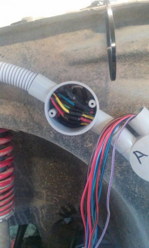

So here's the recap from the weekend's work. Finished off the wiring loom gents, so here are some photos, even though it couldn't be a more boring topic...
Colour coded connections for further simplicity
Off with the dash for some more wiring upgrades

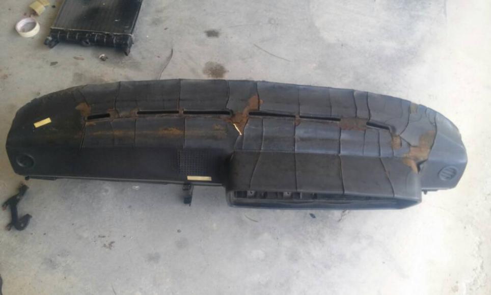

It's seen better days

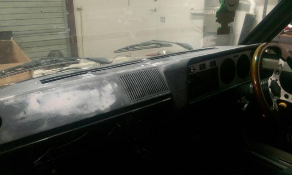

But I have a plastic dash in fair condition which will be replacing it
A little bondo and it's ready for the rest of the the next part of the restoration

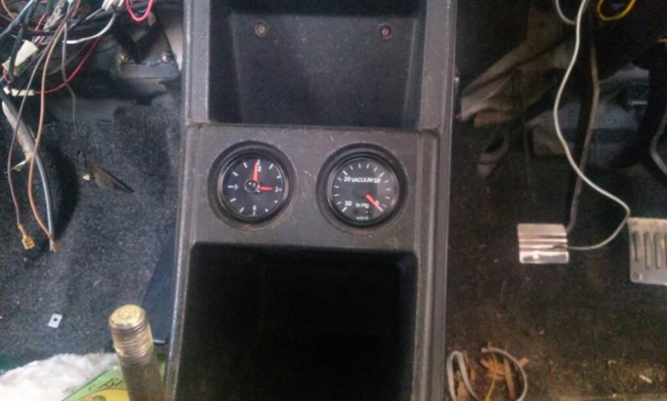

Add in some new gauges and some oem goodness

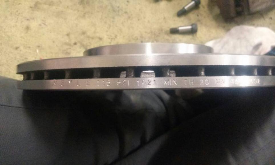

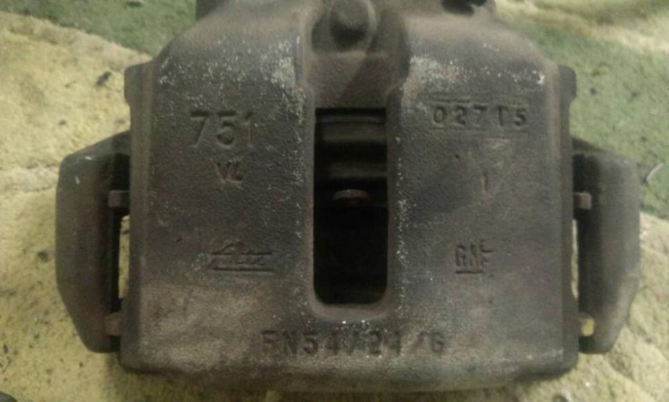

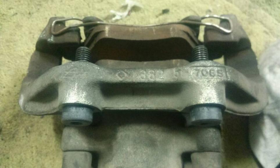

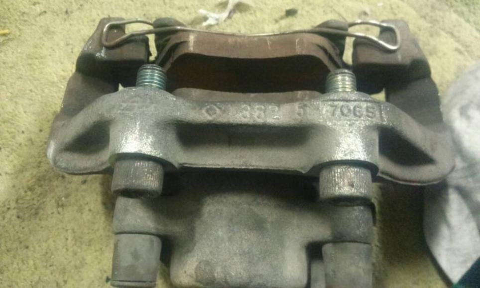

Additionally to the work I've done I got some photos of the brakes that are going on for those who are interested
Part numbers
Old bolts and new shoulder bolts for the mk1 hubs

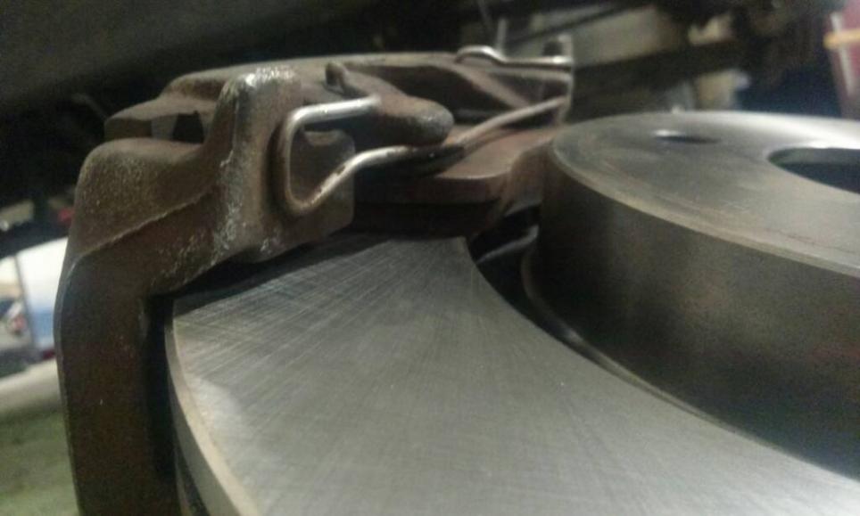

Only issue is the brake pads overhang the inside of the friction surface, meaning it'll be a prick to remove once it starts wearing in

Originally posted by Browneye View PostOnly issue is the brake pads overhang the inside of the friction surface, meaning it'll be a prick to remove once it starts wearing in
Thanks for the info. I had a look at the Seat Cupra calipers I've got and they are going to need an adapter to fit the MK1 hub so I'll see which is cheaper/easier to get, adaptor or Opel calipers. Where did you get your calipers from? I've already got the 280 mm disks.
