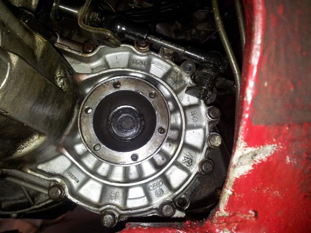

If they are anything like the ones on my MK2 it should be easy to see. Wipe off all the oil and grease and look for any damage. The seal is a large metal cap with rubber around the edge and a press fit. Might be different though, 1 of the 4 I've taken off today was a metal cap that was screwed on, needed an allen key to take it off and it was so tight I gave up.1978 MK1 2.0 16v http://www.vwwatercooled.com.au/foru...-46488-70.html

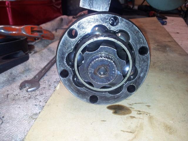

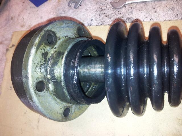

well, iv'e taken the drive shaft off. when i removed the 6 screws and pulled the shaft back, a heap off gearbox oil dripped out.
there is absolutely no sign of grease ever being in there, so can only assume it was full of oil. the cap is on the inside of the flange.
beats me how, if it was filled with oil, how they got it in there?

still can't explain why it was full of oil and no grease?
Possibly because driving with a torn boot has spun all the grease out and only the oil leaking through the gearbox seal is left. Is the usual reason if you dont find it quicklyOriginally posted by ericcs View Postthanks, you answered my next question on how much grease to use!

the boot has only torn in the last couple of months. initially i didn't notice it as no grease flicked out, like a typical torn boot would produce, only oil, which i thought was coming from somewhere else. hopefully this is not still the case.Originally posted by Hillbilly View PostPossibly because driving with a torn boot has spun all the grease out and only the oil leaking through the gearbox seal is left. Is the usual reason if you dont find it quickly
Doesnt take long would do it in one trip of an hour or so Or did in mine once Could also have had the oil leaking into it which stuffed up the grease and it looked like oil when it came out.Originally posted by ericcs View Postthe boot has only torn in the last couple of months. initially i didn't notice it as no grease flicked out, like a typical torn boot would produce, only oil, which i thought was coming from somewhere else. hopefully this is not still the case.2021 Kamiq LE 110 , Moon White, BV cameras F & B
