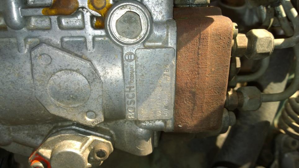

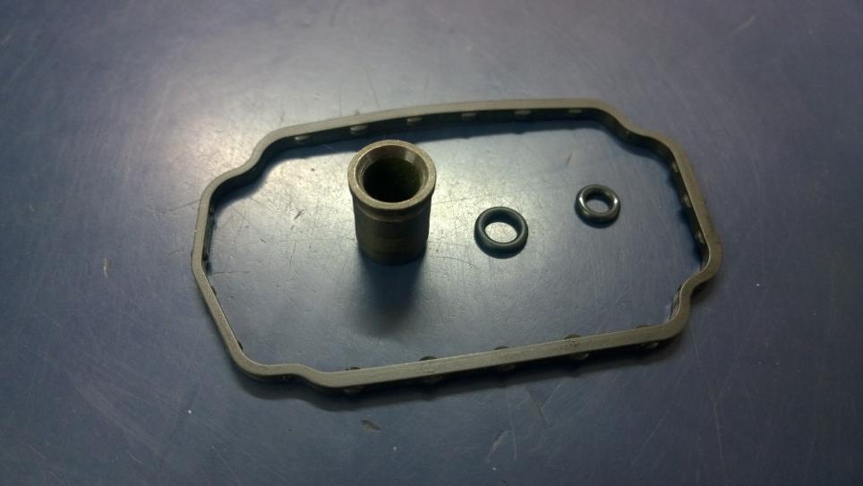

First off - get your seals I was lucky and they had them in stock at my Diesel specialist workshop
They will need the pump details, if it's drive-able take the car in, if not I suggest a clear shot of the pump and the details, or jot everything down, it's on the front face of the pump, pretty easy to get to.
They also managed to have the shaft sleeve in stock!

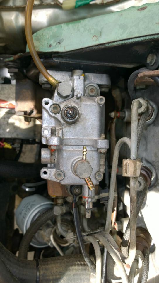

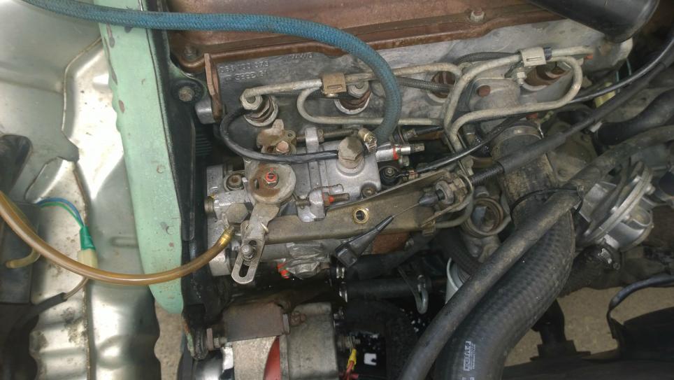

First off, CLEAN, CLEAN CLEAN, I had degreased it before getting rego so the dust and light grime had gone, but cleaning it properly I focused on it with Wurth brake cleaner a brush and a rag. PLEASE WEAR GLOVES & EYE PROTECTION AT LEAST.

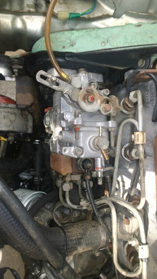

BEFORE - you'll also note I've removed the throttle cable, and throttle cable bracket from the pump, as well as most of the fuel lines.
Be aware there are washers under both bolts, and a spacer underneath the right hand mount.

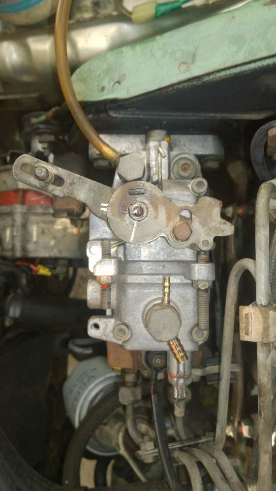

AFTER - nice and clean, bracket gone and throttle cable tucked away

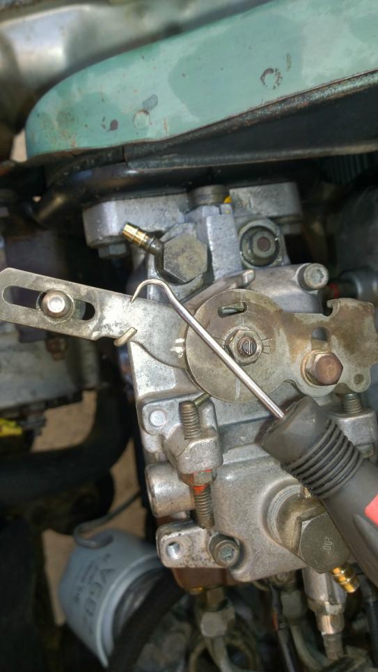

Undo the spring, BE CAREFUL, this bugger is tight, I used this handy little tool...

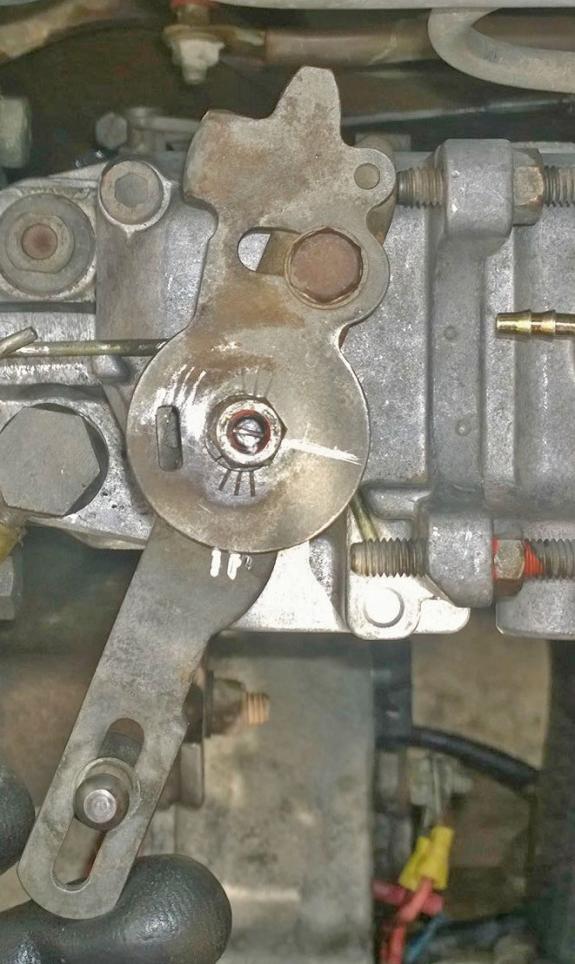

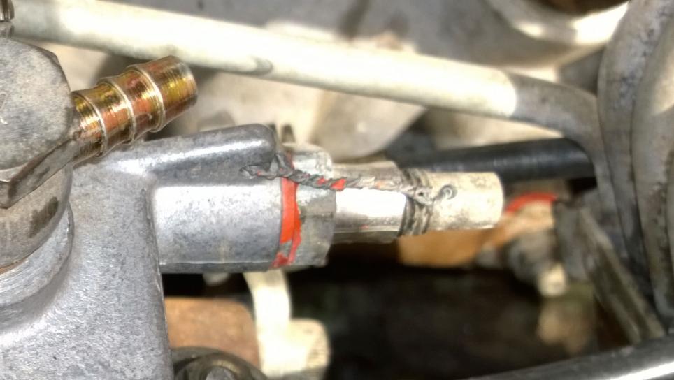

Carefully note the alignment of the shaft, I marked the screw point matching as best I could on the throttle arm
if they've never been done before, or a long time ago, the splines on the shaft will have worn, this is not ideal, but also helps marking where it has to go back. I marked everything while the throttle was closed. PHOTOGRAPH OR NOTE THE ANGLE OF THE SHAFT TOP, Score this too to be 100%
I made a few more markings, just to be 100% for the one on the shaft, it's marked as the forward facing half, but scratch it in, don't use something that will come off, however this is not super important as there is only one way the shaft will work properly when re-installed

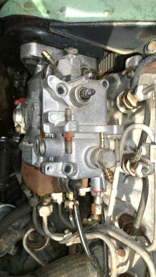

Remove the throttle arm and spring, There is a spring washer below the nut, and the between the throttle arm and spring is a shaped washer/spacer thing that may be stuck to the arm, but it does come off... I dropped it between the glow plugs...
Clean around the shaft again, (Ignore that I've removed the bolts, I just forgot to take a pic)

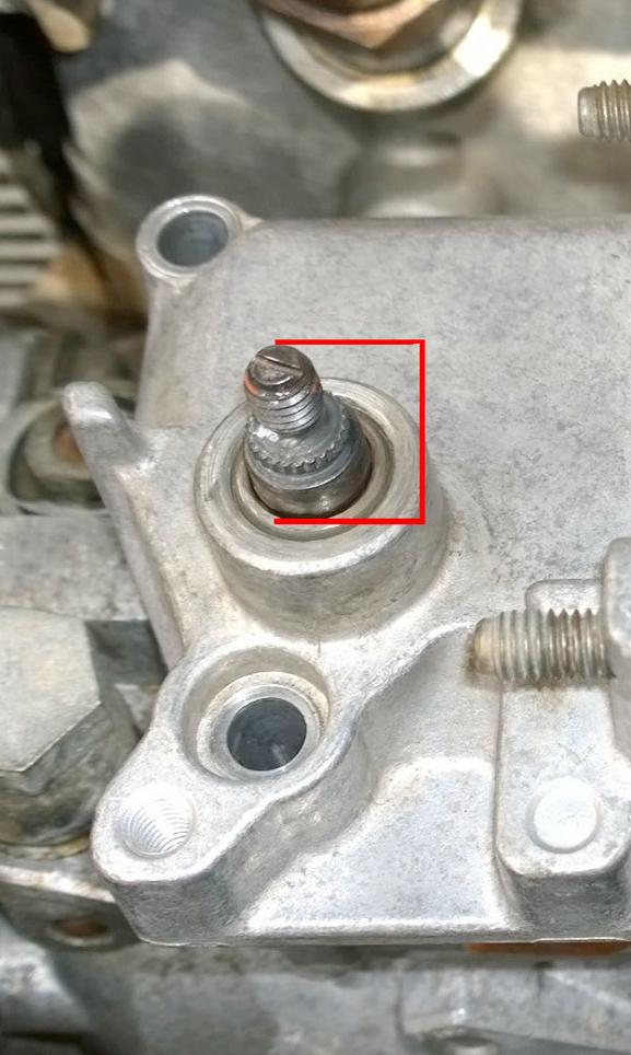

MARK CAREFULLY the max fuel shaft, mine had a crimped lock on it, so it wasn't so bad. ALSO count the turns when un-winding it. Mine was 14. You will need this off to replace the seal. I marked a line from the body of the pump, to the lock nut, to the crimp, to the screw.

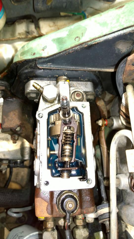

Remove the 4x top bolts with a 5mm allen key
it takes some force, but push the spline out of the lid of the pump, I held a big flat screwdriver on it and popped it out, you don't have much play in trying to lift the top off the pump, so try to keep it as close to the pump as possible.

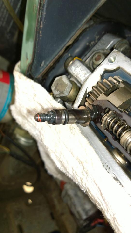

I had to remove the shaft from this location, I don't know if you HAVE to, but I did because of the wear and tear
you can see the grooves in it here would not allow me to re-insert the shaft into the new bushing.
If you do, be very careful around here, there is a TINY cir-clip holding this on, then the spring housing, the spring, and that black cup, followed by A TINY WASHER.
IF YOU ARE NOT CAREFUL YOU CAN DROP THESE IN THE PUMP & GAME OVER.

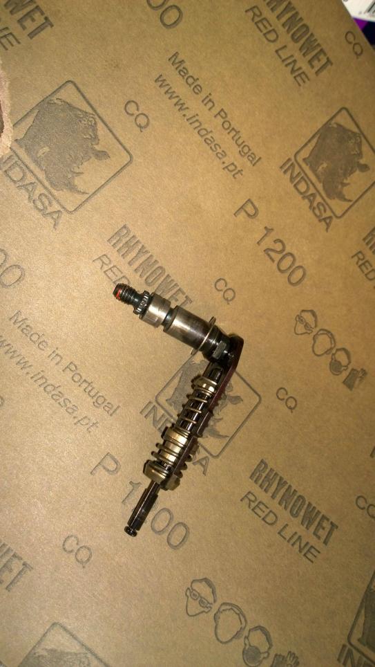

I had to lightly linish the shaft with 1200 wet/dry to remove the bad burs and marks.

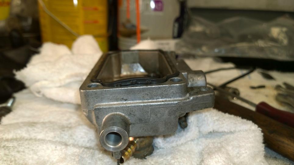

From the top, hammer out the old bush, I used a neatly fitting socket extension bar.
Clean it up, and lightly tap the new one in from the bottom, might also help to really lightly grease it with a bit of white grease or vaso to help it go in.

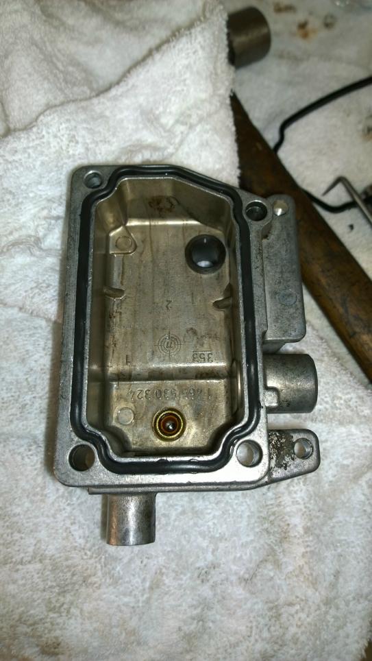

The new cap seal was a bit tricky, compared to the old one it had a heap more tabs, and when trying to squeeze it in it puckered up and stretched more than I thought, I ended up running around with a razor blade and taking off a few strategic tabs to help it seat properly
With the new O-rings, seals and bush in place, now it's time to return everything...

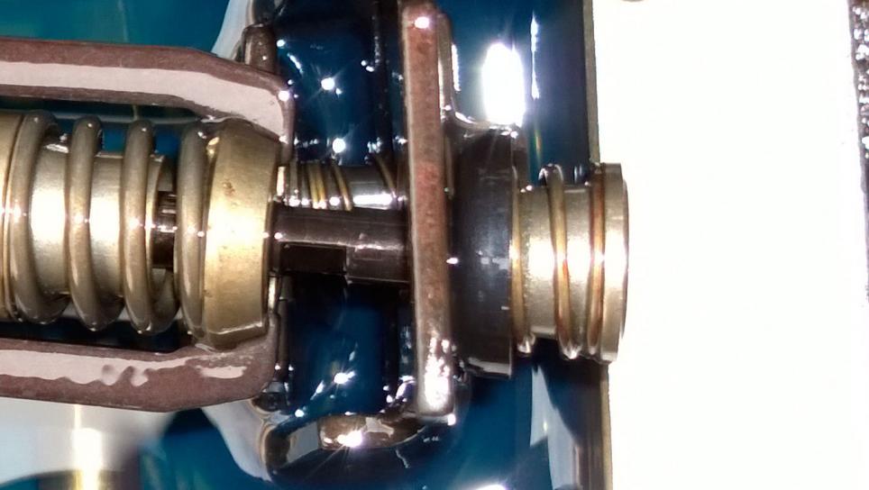

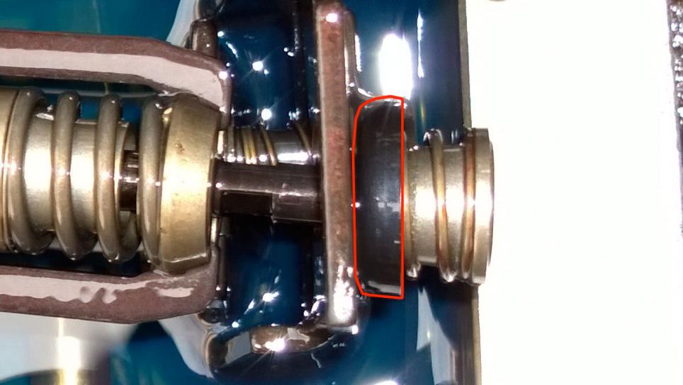

Re-install the throttle shaft and spring assembly into the pump, This is where I stuffed up, DON'T PUT THIS ON BACKWARDS!
This will cause it to over rev and make you pull it all apart again...image of the highlighted cup is showing the correct orientation.

Remember that handy dandy hook? Use it to carefully re-attach the the throttle spring, it's a doozey.
