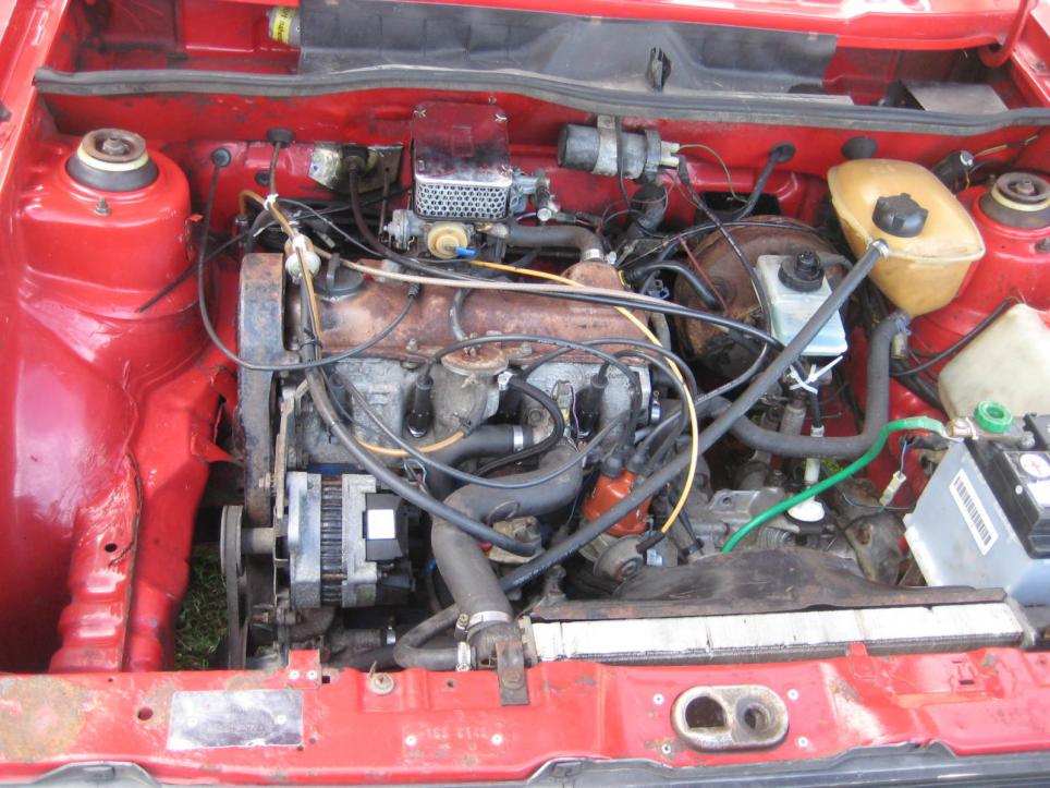

      i also thought the gti's came with injection, however the manifold looks all stock and it has a manual choke knob on the dash.
      the discs have several rows of holes in sweeping arc's

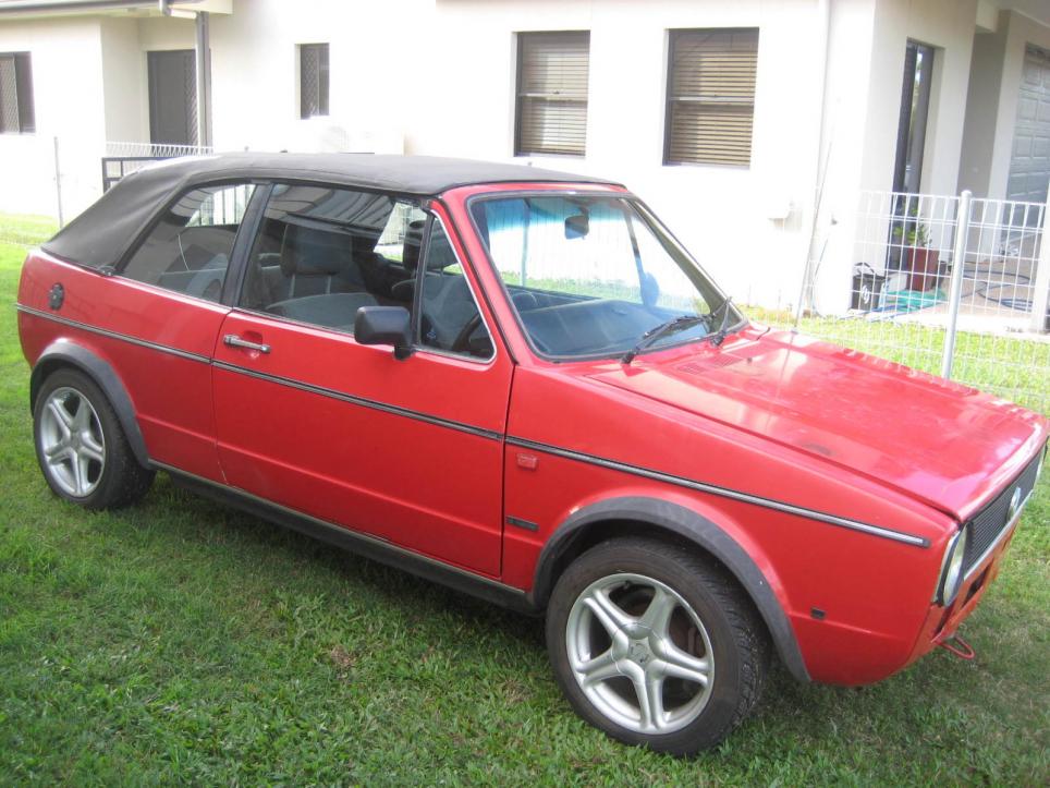

        This looks like it's a personal import GL, not a GLi (injection). 99% of Cabbys were imported by Volkswagen into Australia in the 90's and yours is an 87 model. No VW imported Cabbys sold in Oz came with a carby and aftermarket engine management (and why would you bother to run engine management on a carby engine?).
        Brake disks are definitely aftermarket, as well as the adjustable shocks. Brake calipers look standard.
        The engine bay looks like it doesn't have any of the brackets for holding all the fuel injection plumbing so this isn't a conversion from fuel injection to carby.
        Just guessing but it looks like someone in the late 80's wanted a Cabby, before Volkswagen started importing them, so did a personal import.

          i also can't find any sign of injection being fitted, other than the ignition box, and that it's a 1.8l.
          there is barely 1cm between the front brake calipers and the 15" rims, so they definitely must be after market.
          the engine block is painted bright blue underneath the grime, so i'm guessing it's been reco'd at some stage. i am impressed

              the cabby has rust blistering paint in all but the left front guard and door. it's around the windscreen, a bit in the sills and really bad patches around where the vinyl roof screws down above the boot. rain leaks in in a few places, so it smells like a cat pee'd in it, so told my son to keep his eyes open for a reasonable mk1 hatch and swap the running gear over in the event he can't get it roadworthy'd.

                Engine code "DX" is the highest output with 82kw @ 5800 RPM. and I think it came with CIS-Kjetronic in 1987.

                      it is a dx engine, but no injection, and it shows no sign of being there at any stage, especially as it has choke knob on the dash. the previous owner apparently never registered it ove rthe 2 years he owned it, probably because of the rust, but it does have the remnants of a vic roads rego sticker on the windscreen. also, it does have electric windows up front.

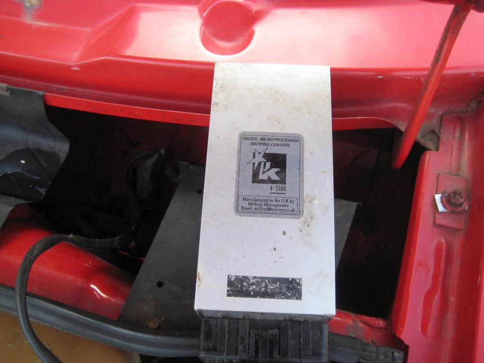

                            Looked at your post early last week and checked the VIN code, Definately a UK car and highly likely came with CIS on the DX engine.
                            The K star box is an aftermarket enrichment module that was available to fit to Ket cars back in the 80's.

                            I cant see any point having a Kstar fitted if it was originally a carbed car, more likely whoever did the engine swapped the head for a Non FI head .
