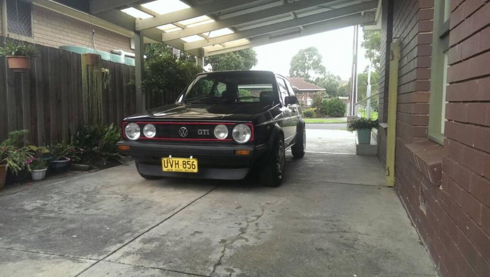

		briefly read something about brakes - i just finished putting a mk3 booster and 22mm master cylinder on my mk1 as well as 256x20mm rotors and calipers also off a mk3. The caliper carriers are off 80s Audi quattros and 16v sciroccos (running 256mm front rotors) and bolt up to mk1 hubs and also hold a later model (mk3+) caliper, I ended up finding these from a bloke in NZ. Hard to come by but if you see them, grab them. A mate of mine recently-ish just threw on the mk3 booster and 22mm master cylinder - every time i drove his car i smacked my head on the steering wheel the brakes were that good (he's also running 210x10mm grooved black diamond disks and pads from memory)
