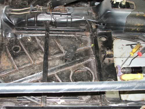

          This is what most people do -> see the twin box section rails, which rules out ever running a stock seat again:
          Despite what Loon says, there are a few companies that make proper sliding subframes for Mk1 Golfs. Konig is at least one of them, available from TCCA Motorsport in Sydney.
          Have fun paying about $3000 to get one seat bolted in, though.
          There's a lot more you can do to make your car quicker than buying a race seat anyway
          EDIT: And DON'T drill holes in the floor as it's not strong enough :!:
            Here is a purpose built seatbase that you could bolt your race seat to.
            A skilled bloke could make one for you, or as ausgolfer says, expect to pay big bucks for one

                And you can make it fit by building a seat base as shown above. It will not bolt straight in.
