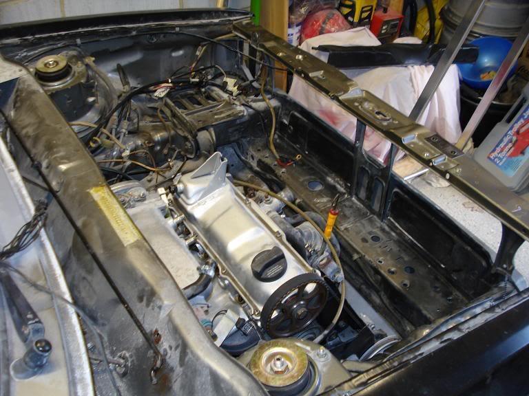

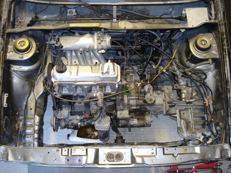

    Bit of progress made today. Heres what ive done in the engine bay today. Hopefully tomorrow should have the engine out. Fingers crossed.
    'Bazza is mostly working on his bro's or girlfriends mk3's!'
    • #32
      wow, that's awefully clean. If only my bay could be that clean!

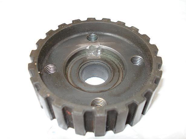

        Only one problem, managed to break the locating key on the small pulley on the end of the crankshaft whilst removing the nut to get to the oil seal. Not sure where i'm going to get a new pulley from now tho!

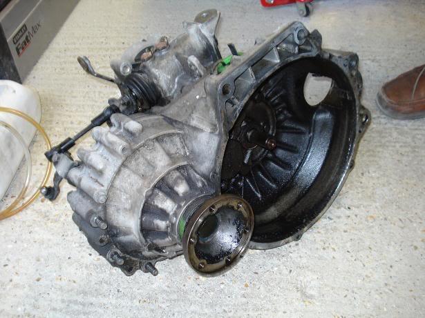

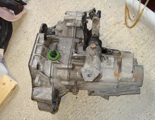

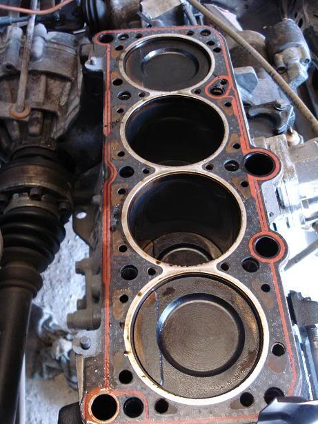

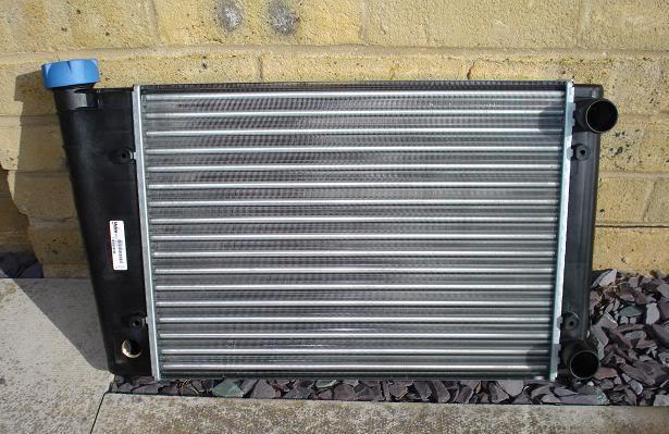

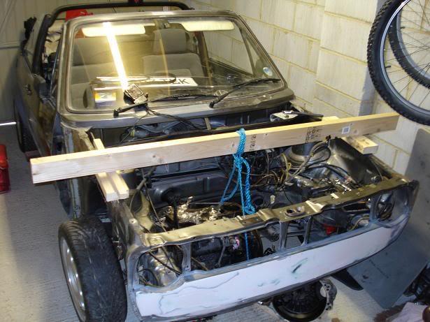

            Photos as promised.
            Who needs an engine hoist!

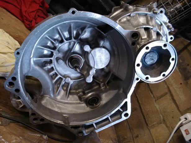

            Gearbox on its way out.

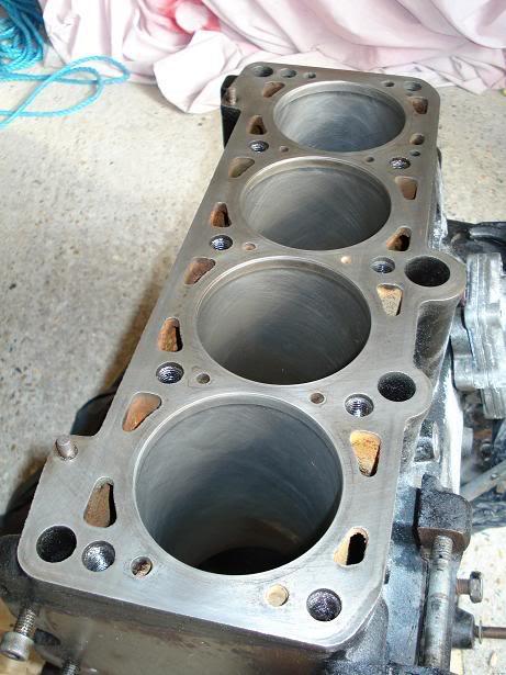

            Bottom end dirty, and then cleaned up, fitting pistons back in today.
            New top fill rad. Just need to find a fan to fit it.
            The broken pulley! Argh!!!!!!!

                    Problem solved, just went to local VW Dealership and they had the pulley on the shelf. Bargain price of £25, result!

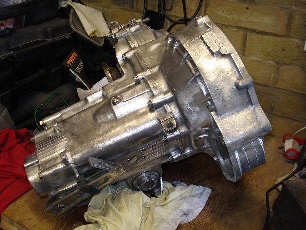

                          Heres what i've been up to today instead of going to the Spring GTI Festival at Santa Pod, its been pouring with rain here today so i think i made the right decision.
                          Before and afters on the gearbox. I've also replaced nearly all the seals.

                          • #43
                            i love before and after gearbox stuff... such a huge change and alot of cleaning involved!!! well done mate, keep us updated!
                            wabit
                            • #44
                              how the hec did you get it that clan and shiny??!?
                              I ask this cause I have a g'box that could do with a clean
                              • #45
                                Firstly, loadsa engine de-greaser (GUNK), cleaned it all off.
                                Then used different size/shape wire wheels on the end of an electic drill to buff off all the grime.
                                Then washed it all down again, then cleaned it all with cellulose thinners, before today i will give it a coat of lacquer to protect it.
                                Job done!
