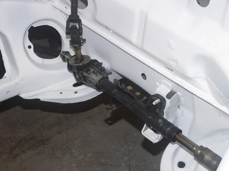

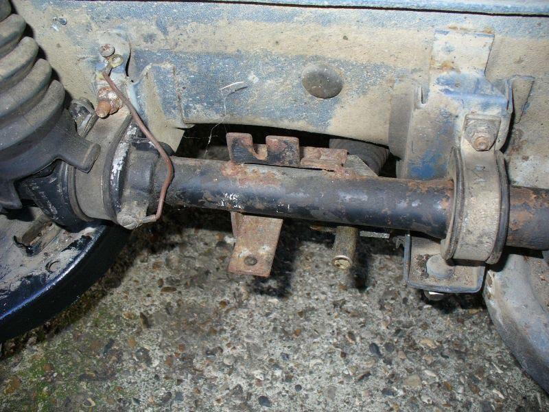

          Early style rack
          New style rack
          Hmmm looking at the pics my idea about welding the brackets on isn't going to work. Might work for the passenger side. Driver side you'd have to weld the later bracket onto the firewall.

            Originally posted by Peter Jones View Post
            Early style rack
            New style rack
