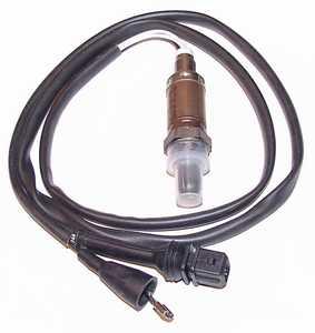

                          Bought some extractors on the weekend...
                          4-2-1, and not mandrel bent, so they are cheapies...
                          Now the real question...
                          Where do I mount the oxygen sensor...
                          Currently its not far from the ports, but it is 'after' the 4-1 of the stock manifold...
                          Also, it's a single wire sensor, so no heating element...
                          As I see it, I have a couple of options.
                          1. Near one of the exhaust ports.
                          Plus - Hot exhaust gasses, No Delay.
                          Minus - Only 1 cylinder.
                          2. Just after the first Y.
                          Plus - At least 2 cylinders.
                          Minus - Cooling Gasses, Only 2 Cylinders, Moderate Delay.
                          3. After the second Y.
                          Plus - All four Cylinders
                          Minus - Cool Gasses, Largest Delay.
                          Cool / Cooling gasses can be mitigated with a heated sensor, but I'm not too sure about how the delay, or the reduced cylinder count will affect the sensor outputs.
                          From what I understand, most 3 wire sensors could be used... i.e. A Mk2 3 wire sensor.
                          Bosch Oxygen Sensor 3 wire, '85-'92 CIS GTI, GLI and 16v Scirocco [133 255] - $85.00 : Techtonics Tuning, VW and Audi Performance Tuning and Repair Parts
                          Any insight / examples you guys can provide / share will be greatly appreciated...
