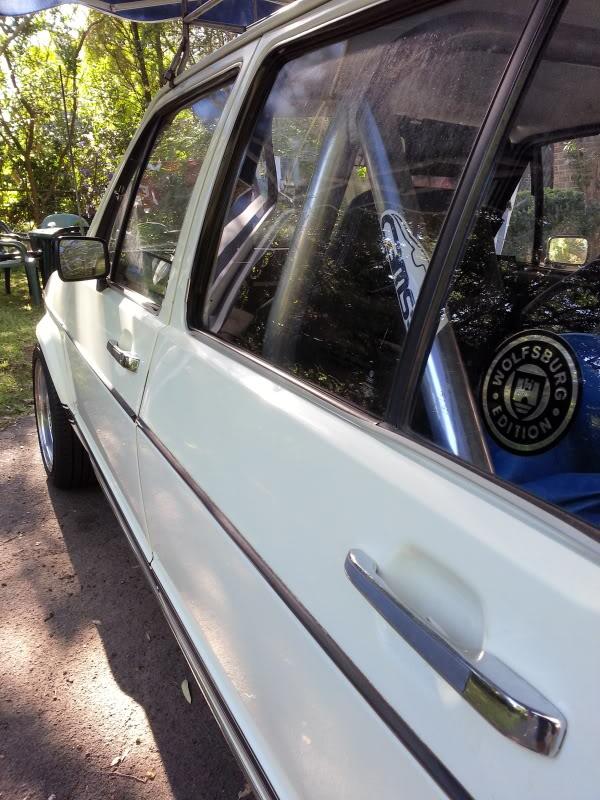

    Looks good, love the stance and that black strip down the lower half of the doors.

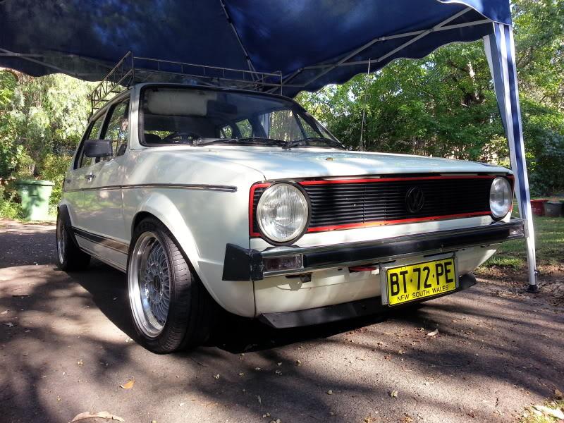

      Very impressive mk1.
      I vote more pics!
      Mk1 2dr ABF
      • #18

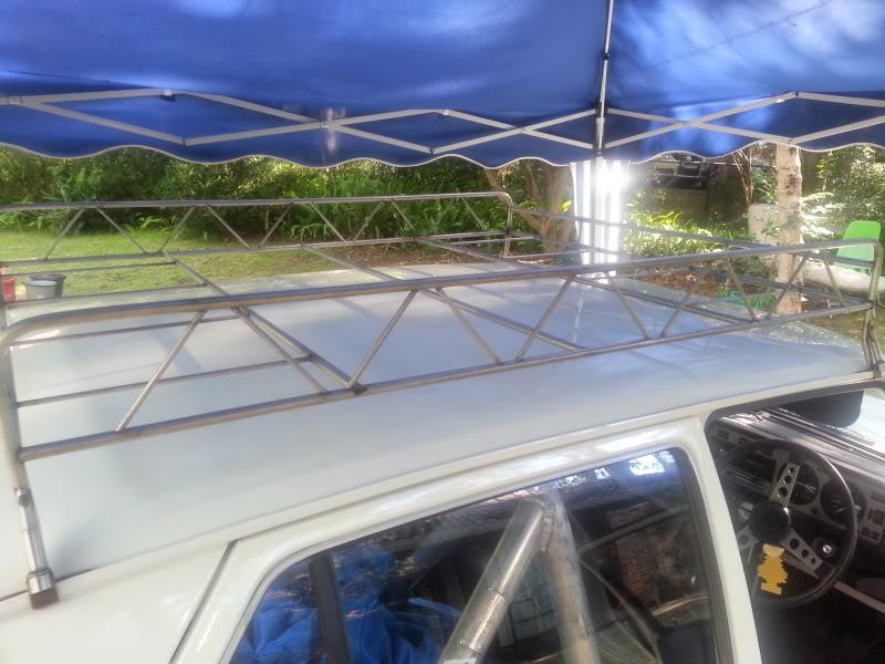

        Wow, not usually a sucker for the 4 doors but this one is the tits!
        And that roofrack is mint. I WANT!
        77 Mk1 GLS 2 door - That sinking feeling
        76 Mk1 Swallowtail 2 door - Replace that BMW & 76 Sweetheart

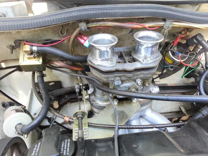

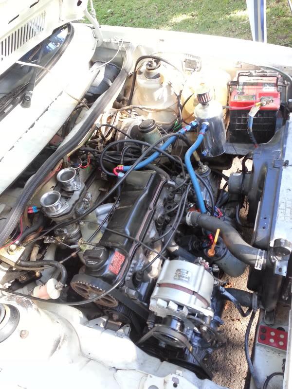

              Heys guys,
              Ive got a problem with hesitation whilst accelerating. It seems to occur when the engine is warm to hot.
              Any ideas? Im thinking there is a fuel delivery issue?
              • #22
                K-jet? If so check valve at the fuel pump may be not working any more...
                This may become a point of reference. http://www.race.nangreaves.com/golf/FU01/index.htm

                  No its webber carby
                  Maybe there is a loose electricial connector somewhere causing a break in fuel supply?

                      Are you running only 1 fuel pump? The one in the engine bay is mounted up high and must rely on suction to prime it if it's the only pump you've got. Normally pumps are mounted low and push the fuel to the filter and then to the carbie.
                      Relocate it close to the fuel tank (down low) for a better fuel delivery.
                      Cheers
                      Paul
