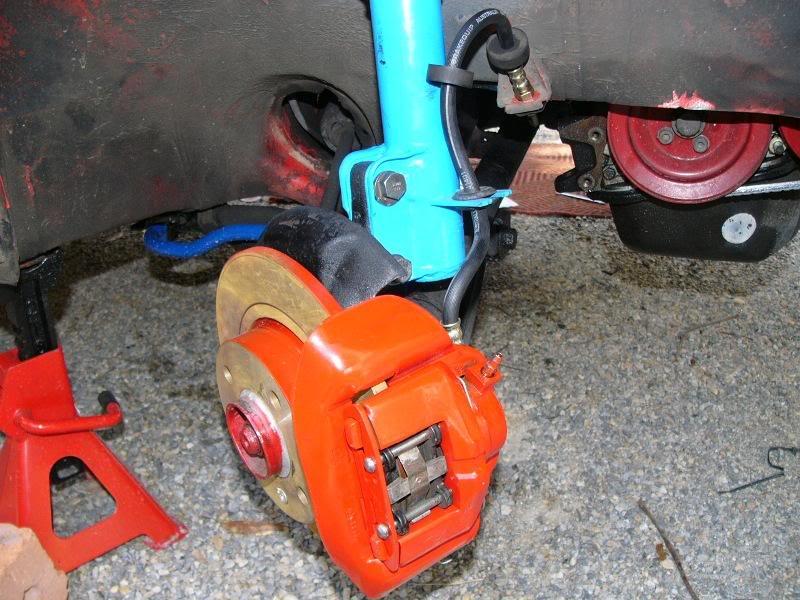

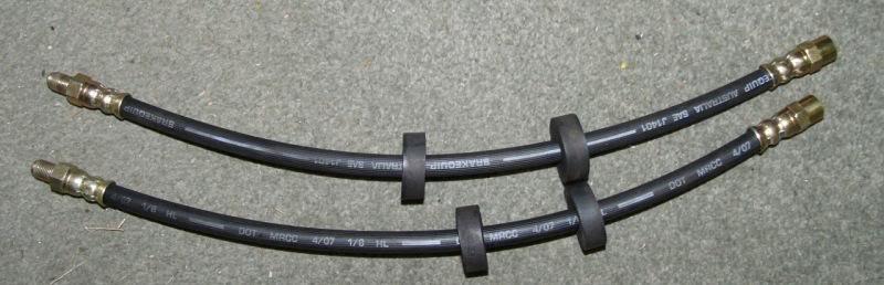

I hit a snag when it came time to re-install the calipers. Sometime around 1979 or so VW decided to install calipers that use a left handed thread on the hose fitting. Of course the caliper I had cleaned up has a right handed thread. The brake shop is making me some new hoses at the moment. The brake shop guy didn't believe me ! He had to try threading the hose into something for himself!

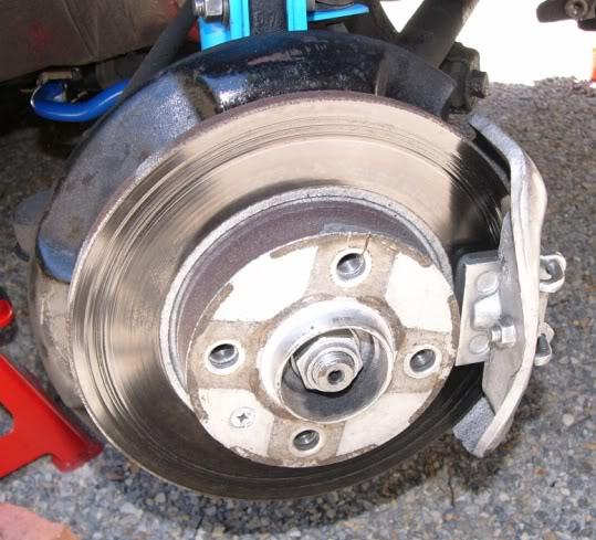

OLD

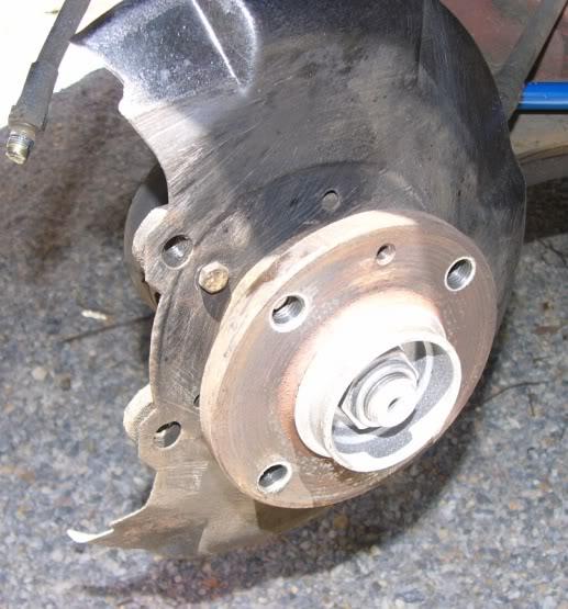

Removed. Note the offending LH thread hose in the top left corner.

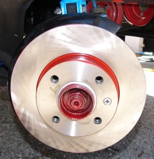

New disc installed.
I'll add some photos of the completed job tomorrow when I get the new hoses.
