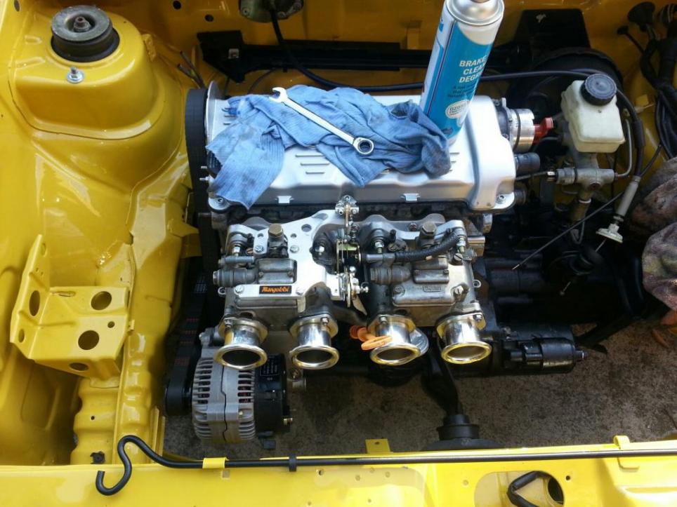

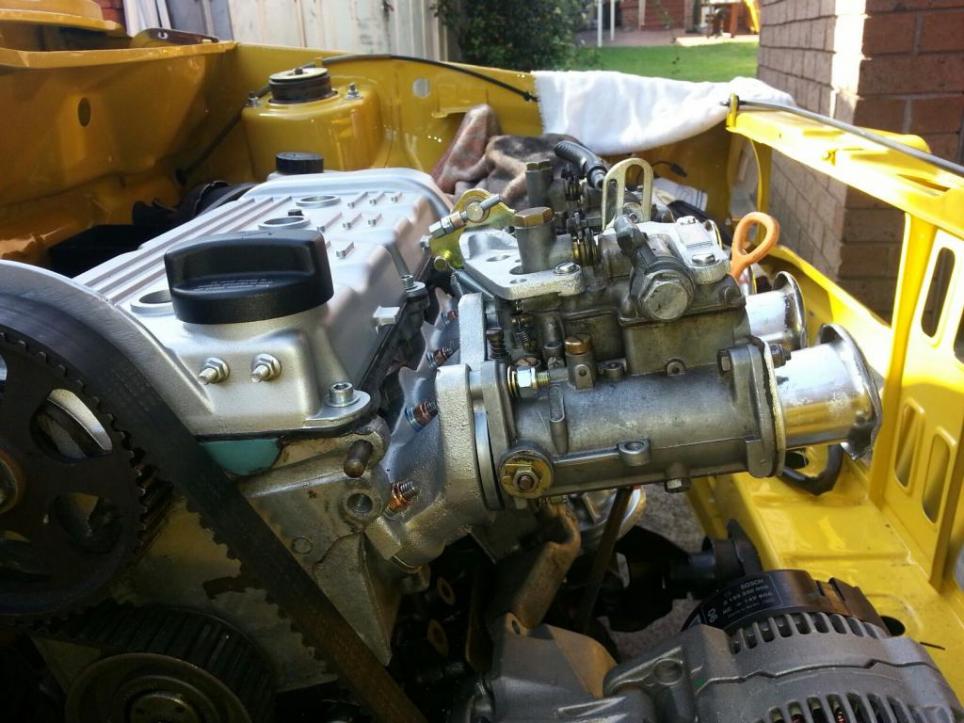

                        Hi guys.
                        i did a google search and stumbled across this thread.
                        Im upto this part of installing dellortos and i have the mangoletsi linkages.What are your thoughts.
                        Any info on how the accelerator cable attaches do i use the original cable.
                        Any sort of help greatly appreciated
                          If the standard cable stretches far enough then why wouldn't you use it?

                            Nice!!!!
                            I havnt spent too much time setting up the mangoletsi yet 10 minutes.but from what i saw it fowls the water outlet below the carbs and how did you get the 2 carbs to move together.
                            can you put up a pic of the bit that makes em work.
                            cheers
                              Also that radiator tucks under the top rail nicely.
                              whats it from.
