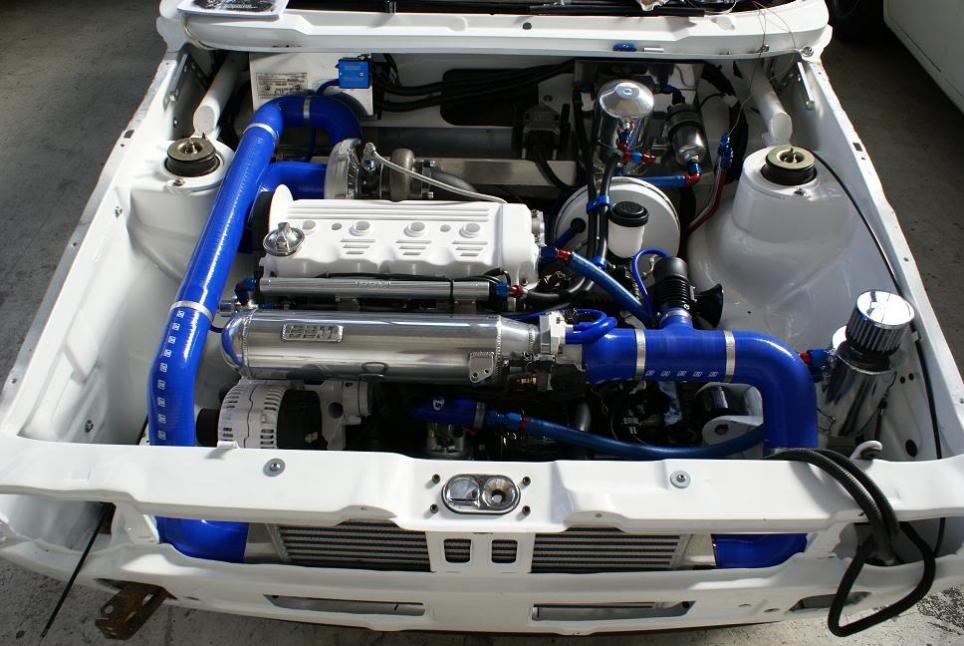

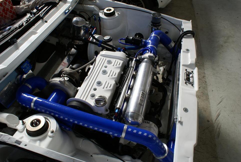

      So here is the engine all done apart from the radiator and overflow bottle, which I'm still waiting on. It's very loud and makes all the right woosh and kerpowww noises [LOL]
      Took these on Friday, so the weekends progress is missing (only finished the fuel lines prior to starting it, so it hardly looks different now anyway):

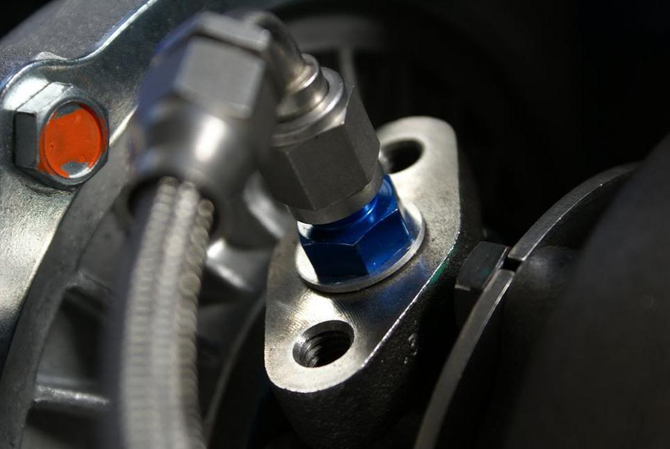

      Finished all the oil lines - the drain line is something I'm most happy with, but I couldn't be bothered putting the car on the hoist, so I'll show that off later:

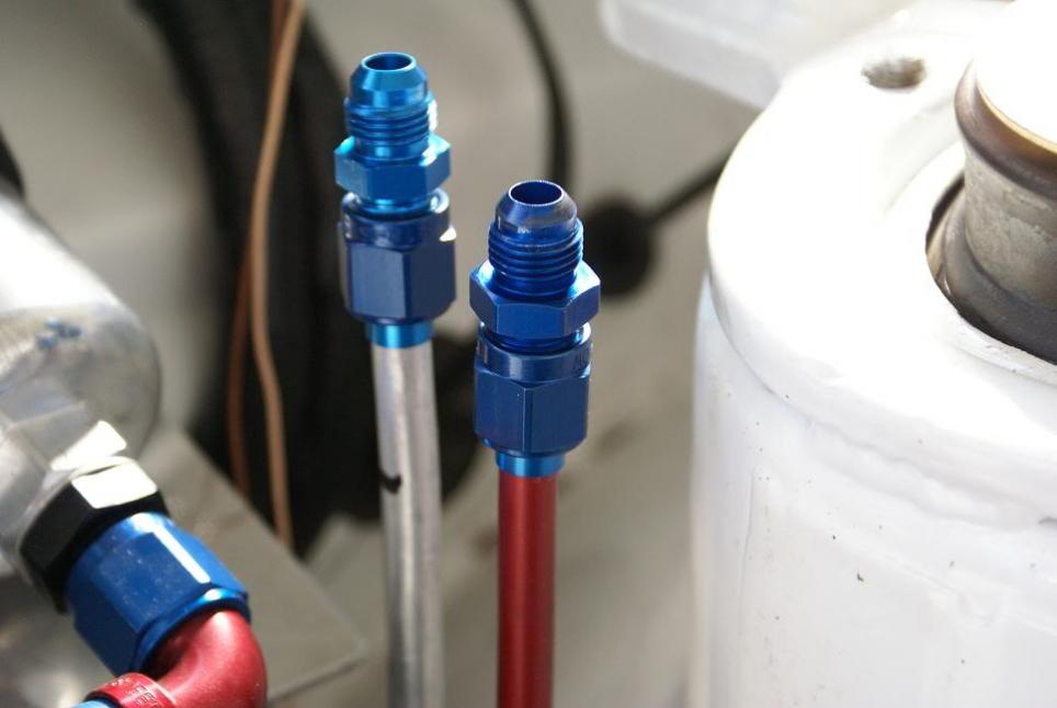

      These are the new alloy hard lines from Earls - very nice things and bend to 90deg perfectly. With an olive and a very small flaring, the ends are converted to dash fittings neatly:

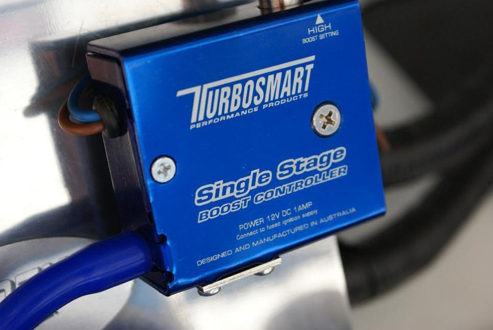

      Turbosmart bits everywhere:
