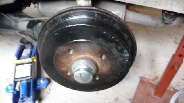

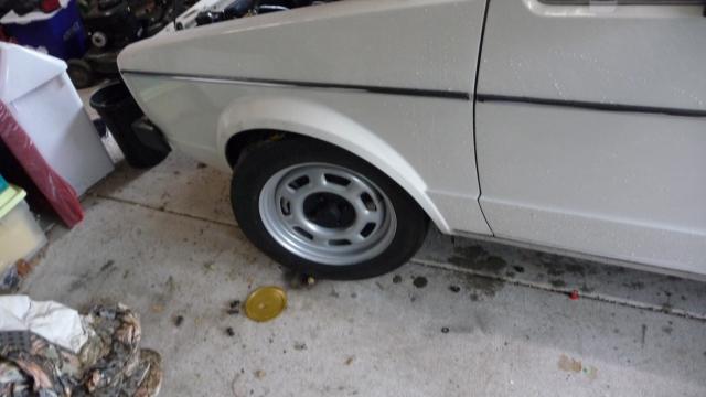

      Got Andy back on his wheels on the weekend.

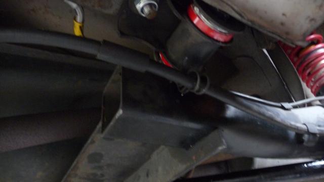

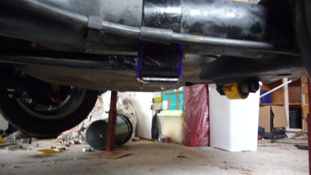

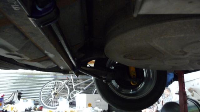

      I forgot to snap some pics of the rear beam before I re-installed it, but here's a few fuzzy/dark photos....
      Prothane bushes
      20mm sway bar
      200mm drums

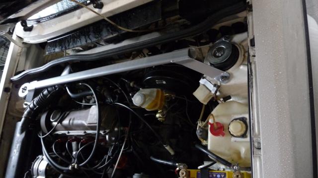

      Front strut bar
      Sneaky pic of the wheels

          Finally got the brake issue sorted. Turns out that the 'automatic' adjustment wedge was not automatically adjusting. We forced the wedge down through a wheel stud hole and that solved the issue!

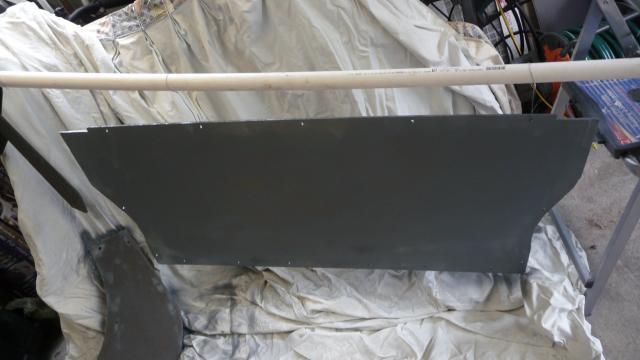

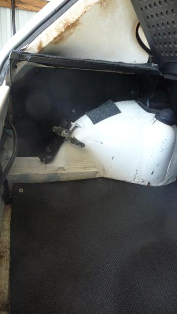

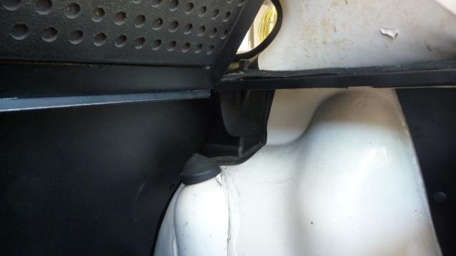

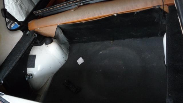

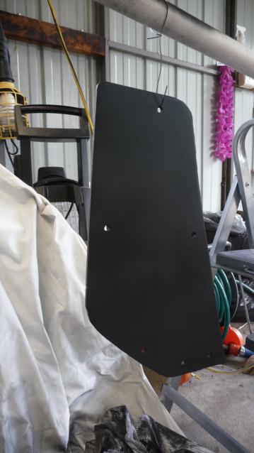

              My project on ANdy for the past few weeks has been to make new set of interior boot cards and also repair the parcel tray and its supports.
              The boot area was in pretty bad shape as you can see here:

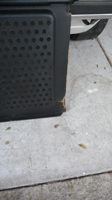

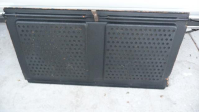

              The parcel tray was broken and ripped and didn't stay in place, it just dropped off the supports:

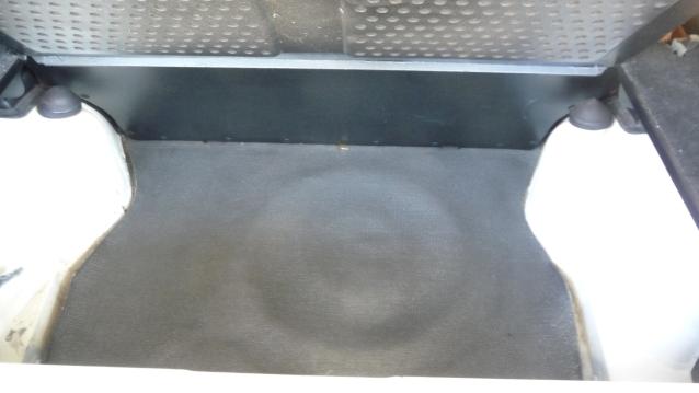

              I used some 4.2mm masonite to reconstruct the panels, using the old ones as a template. With a lot of primer-sand-paint-repeat, I got the boards pretty smooth:

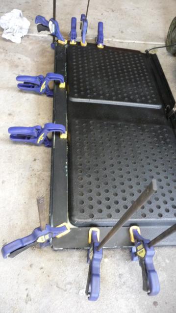

              I also used the masonite to add some strength and repair the parcel tray:

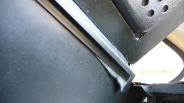

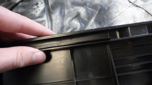

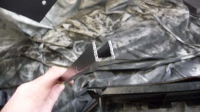

              The parcel tray supports were pretty bowed and also had some broken tabs/cracks. I added strength and straightened them out by using some Auminium U bar. This fits perfectly into the channel where the parcel tray rest and with some JB weld and concealed rivets (clamped for 3 days) I managed to get them straight and sturdy again.
              Before:
              During:
              After:

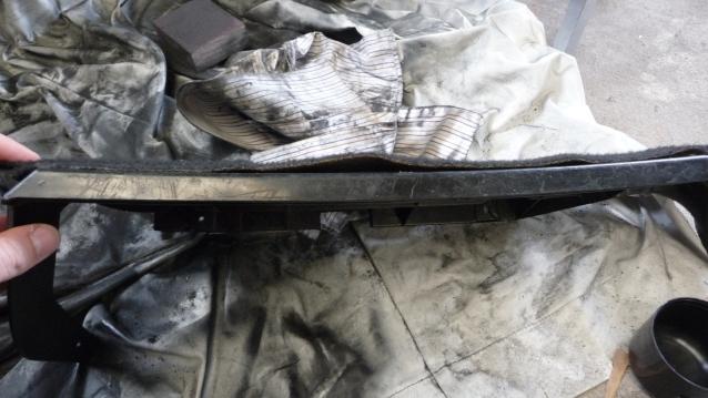

              The parcel tray on a Mk1 connect to the backseat. It has an excess length of fabric that is screwed into the top of the back seat. Over time the fabric rips and frays. Obviously this was a known problem and on the later Mk1s, VW added a length of aluminium bar to fold the fabric more evenly. This bar is NLA, so I had to choose a profile from stock and used that. I also had to break out the needle and thread to repair the rips.:
              And fully completed:

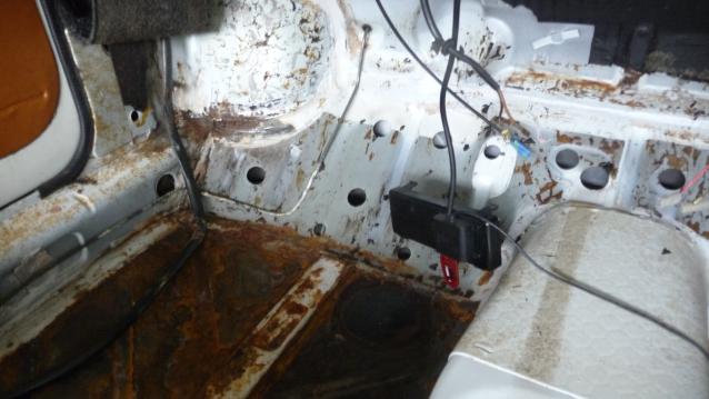

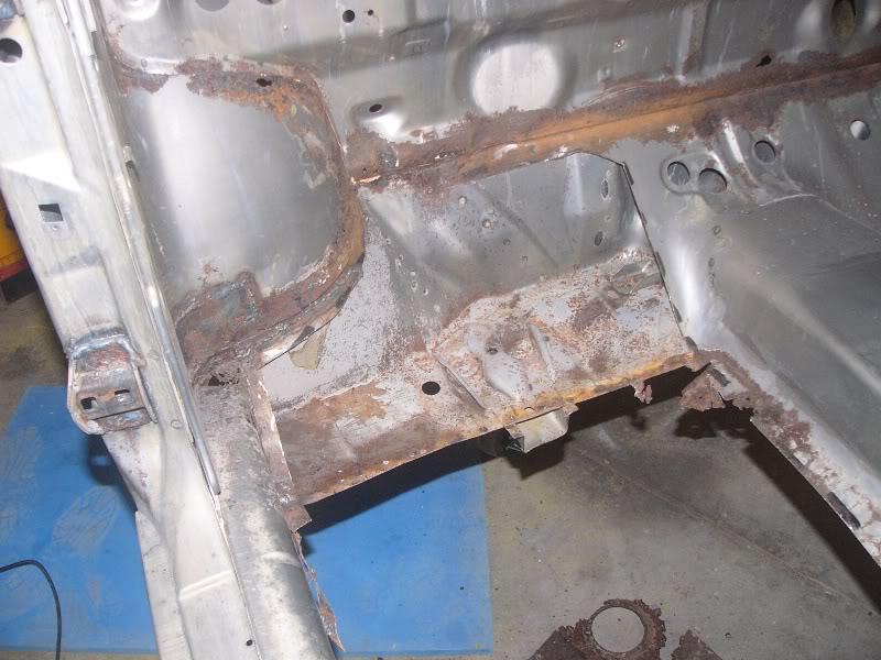

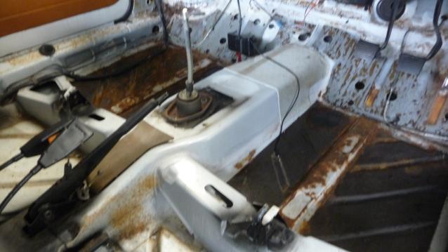

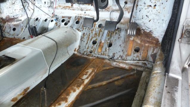

                  Been cracking on with removing the rest of the bitumen and rubber from the firewall. The best method is to keep the heat gun on the area and the use your chosen craper to peel it off. The best scraper i found was the 'crevice type', as it conforms to most angles.
                  I'll go get some dry ice to do the rear floor, as I also want to try making sorbet Heston-style.

                              DUBSTAR'S PROJECT - Weiß Hase - 1976 Golf LS

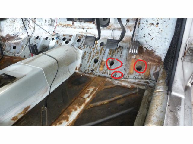

                              Question for the day.
                              There are holes pressed into the footwell plate (circled in red). Can anyone tell me if the cavity underneath has a drain? Where does it drain to on the underside?
                              • #45
                                There's no drain but there is a couple of plugged up holes you can pull the bung out of.
                                I'll see if I can find a picture.
                                Here's a good one!
                                You might have to dig around in the under seal to find it.
