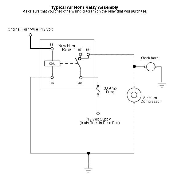

I picked up a dual horn from a Seat Cordoba, i think, a while ago and I've put it in but it doesn't always work properly. I know they work, because when i connect them straight to the battery they work fine. Is there a way to increase the power that is going to the horn?

A relay should do the trick.

Relay # 30 -> battery +ve
Relay # 85 -> ground
Cut your horn +ve and wire it to Relay # 86
Relay # 87 -> horn +ve input
FAQ: RELAYS; how they work and how to wire it up...sigpicParts for sale http://www.vwwatercooled.com.au/foru...ff-102387.html
Yeah, plenty of pics already on line.
I'd just connect the two wires that run to your stock horn and connect them to the realy coil on 85 and 86.
30 goes to battery.
87 goes to one side of the horn. Earth the other side of the horn.
There's a couple of different ways to do it.
ANother issue can be the contacts behind the steering wheel. You might need a new switch or contact ring.79 MK1 Golf Wreck to Race / 79 MK1 Golf The Red Thread / 76 MK1 Golf Kamei Race Car
