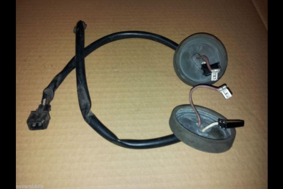

  • Spent 2hours looking at the wiring for the headlight and middle grill lights and drinking beer and have no fricking idea how to get the 2 middle lights to work!!!! Read the diagrams and looked at the pictures. But just confused me even more!!! Lol! Does anybody know an easy way to make these lights work? A video of which wire should be connected or something coz i am lost right now lol! And untill i hook up a HID upgrade its like driving by candle light
    • check these wire colours on the back of the main lamps,
      Yellow/ black trace = left lamp low beam
      yellow = right lamp low beam
      White / black trace = left lamp hi beam, should loop over to the inner left "spottie"
      white = right lamp hi beam , same as above, should loop over to inner hi beam light.
      If the outer lights work on both lo and Hi beam then its just the inners arent recieving power ( check wire at inner light socket earthing to battery negative, test light should light up. if it doesnt then the wire from the outer lamp has lost continuity to inner lamp socket. if test light comes on then the earth ( brown wire ) from the inner lamps isnt attached to the body earth point.
      If you want I can turn night into day by making you a headlamp relay set up.

      • You made that sound so simple yet im still confused!! Mayb the beer isnt helping lol! Might have more luck in the morning.

                      • From What i could see i had the 2 correct wires laying on the clutch linkage and applying the clutch was earthing it mayb! Not sure tho! I ordered then caps and wires that i was missing from the spot lights should be here late next week!
