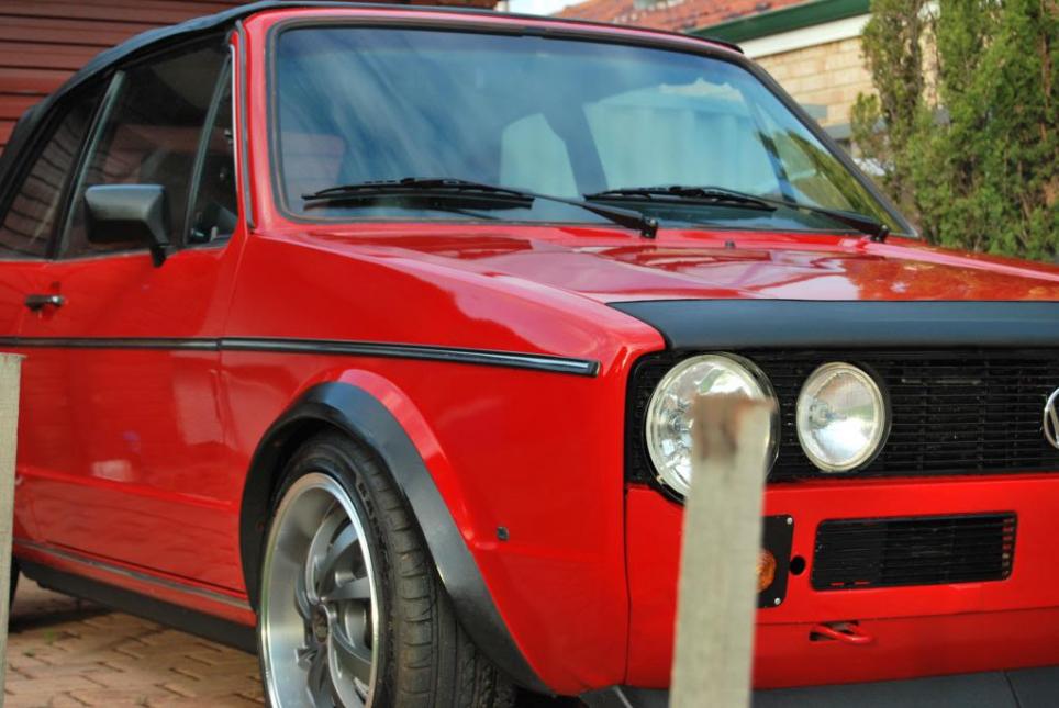

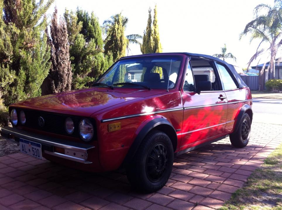

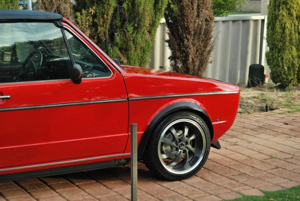

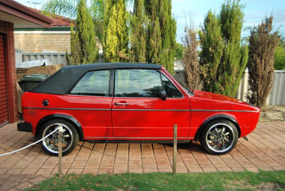

                            • The day has finally arrived....! after Grant hooked me up with an Exhaust system (much appreciated) and i managed to buy a mig welder and a grinder! To the best of my ability lacking a pipe expanding tool i managed to build the exhaust system today and took her for the first drive in just short of a year. A very short drive as the idle and fuel/air mixture is a mess. But thats just a tune.
                              So i managed to get a few pics after a wash and fitting some missing bits i had took off forgot about the exhaust as its not exactly sitting where i wanted it but it was my first time welding and putting an exhaust together. Some where down the line she will get a techtronics system.
                              So here she is not a show car but the best i could get her to my budget and time frame!
                              (would not recommend doing this to anyone unless they a single and live at home, Have a very well paid job and an understanding misses or has a workshop full of tools and equipment in there back yard. I have none of the above lol)
                              Day i got her! (originally for the misses lol)
                              And now
                              i will put up a vid of the exhaust sound once i give her a tune, But from now on im turning this thread into a picture thread till i win lotto! Or get drunk and go on ebay!!!!
