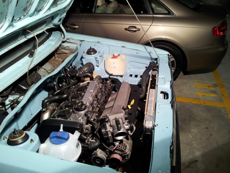

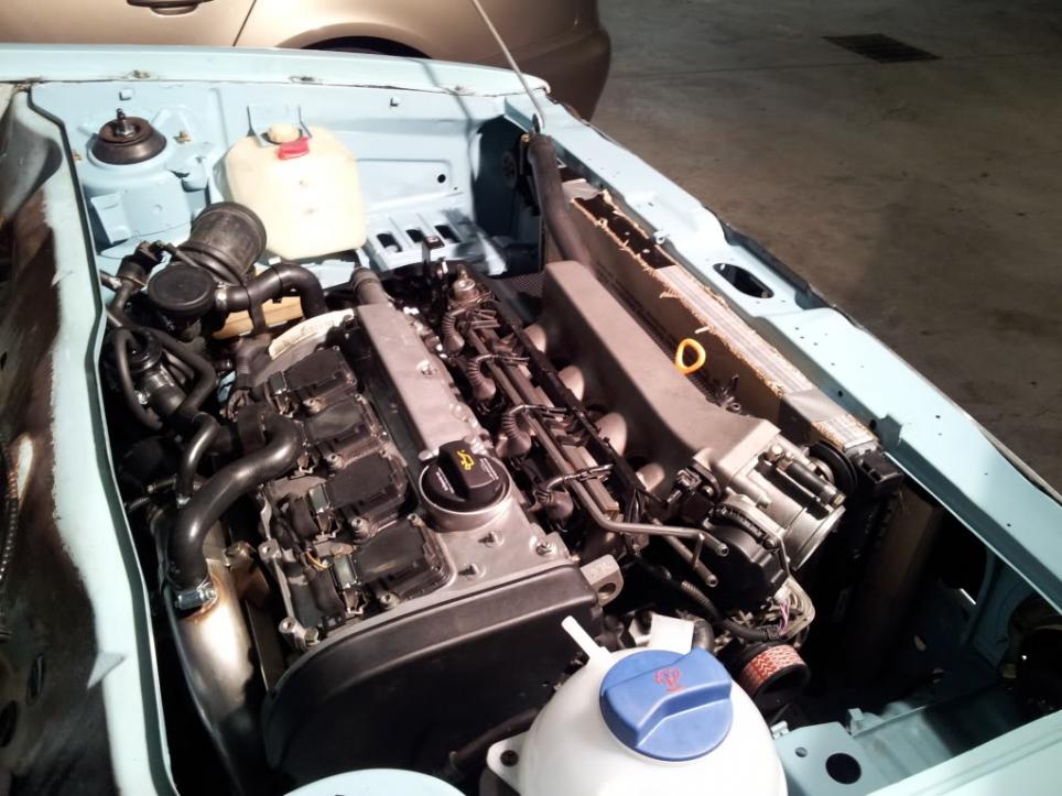

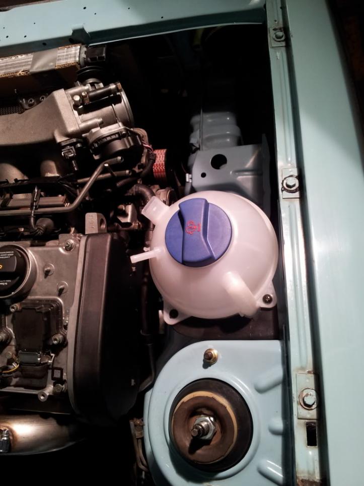

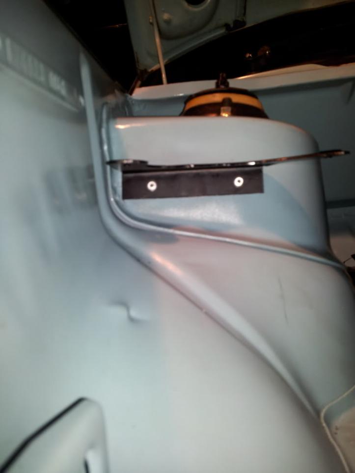

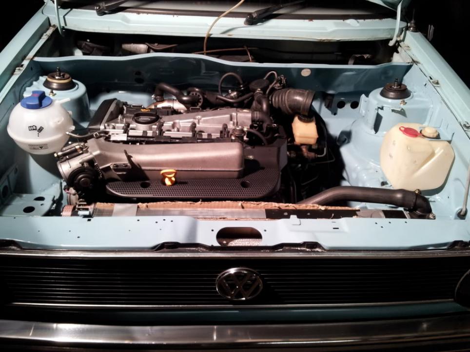

      Today I got mounted the new header tank, made up a bracked and mounted it to the strut tower.

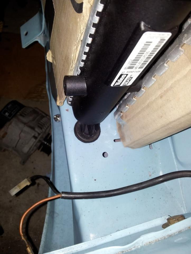

      Mounted the new G60 rad, drilled holes in the front bar and used rubber mounts to make the fit snug and tight.

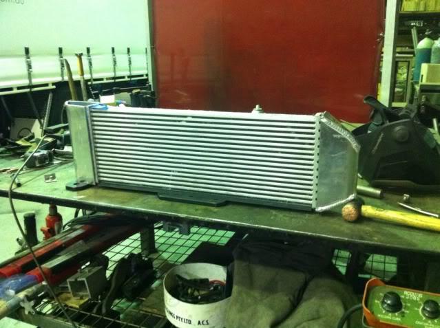

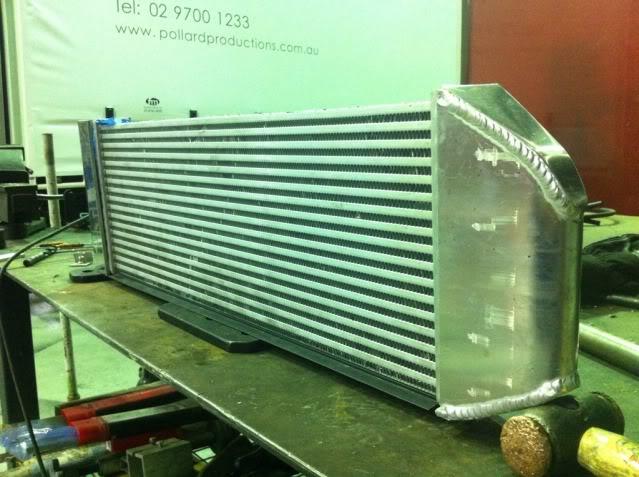

      And made up some dummy end for the s3 intercooler I have modified

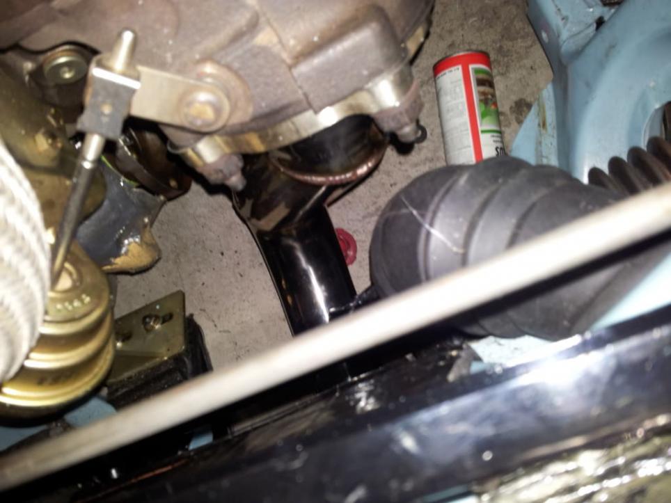

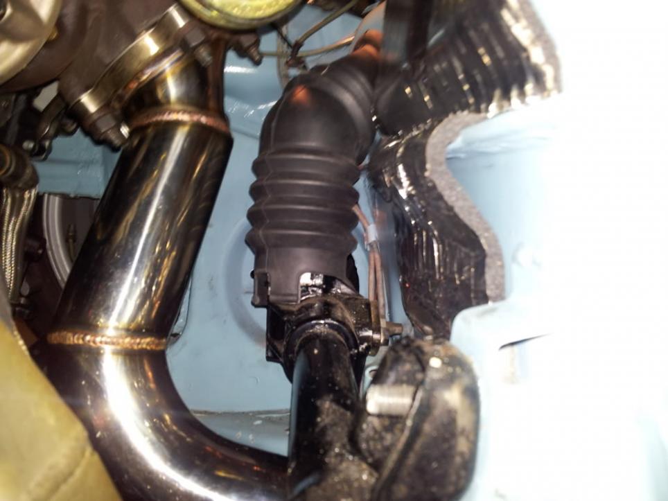

            Qpeng down pipe
            Got my qpeng down pipe today, so I fitted it up, heaps of room and really impressed with the quality.

                Just took delivery of said intercooler for a little end tank fab.

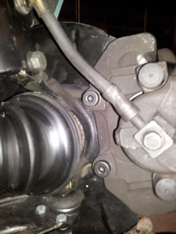

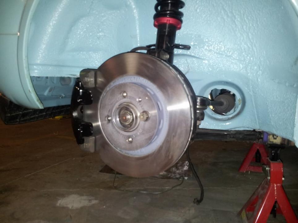

                                Really been slacking lately but got round to fitting my new front brakes.
                                Golf mk2 G60 front disc and Holden vetra B calipers and caliper carrier, no bracket required bolts straight on with so new bolts with a 10 shoulder on them. Much better option then a bracket ( no flex )
