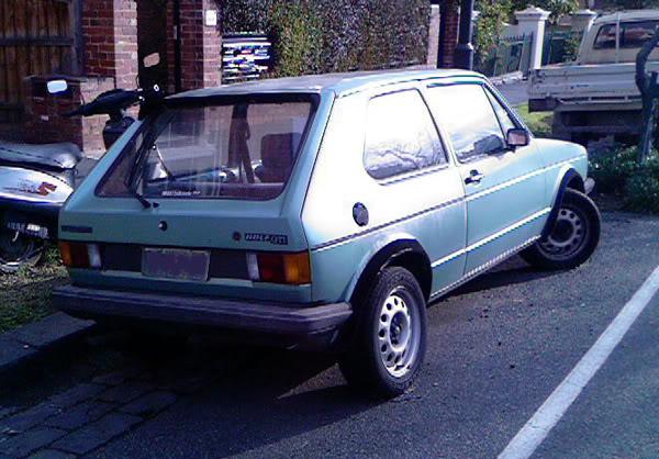

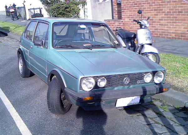

    ps. spotted a gti badged mk1 parked outside a house and wondering if its real or not. ill go back for another look when i know what to look for. it says 1979 on the rego sticker, has dual headlights, wheel arch's, plastic bumpers.

          just went and got some pics of that car i mentioned. it looked better when i was drunk and it was dark, only a couple spots where rust is bubbling up under the paint. had cream/white headliner, did have 3 gauges down near the golf ball gear stick thou. scuse the phone pics. is it a real one..?
                Mk1 Gti didn't come with that colour, it has no red grill surround. it's not real.
                  could have been resprayed (30+ year old cars often are) and the grille could have been replaced or painted... just pointing out the obvious.
