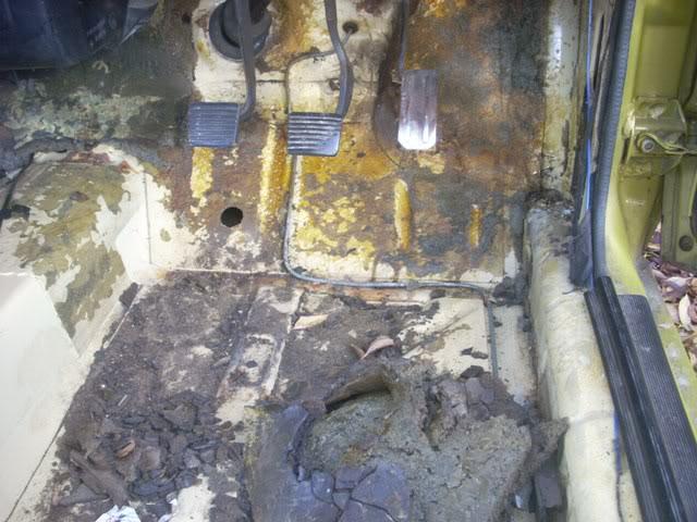

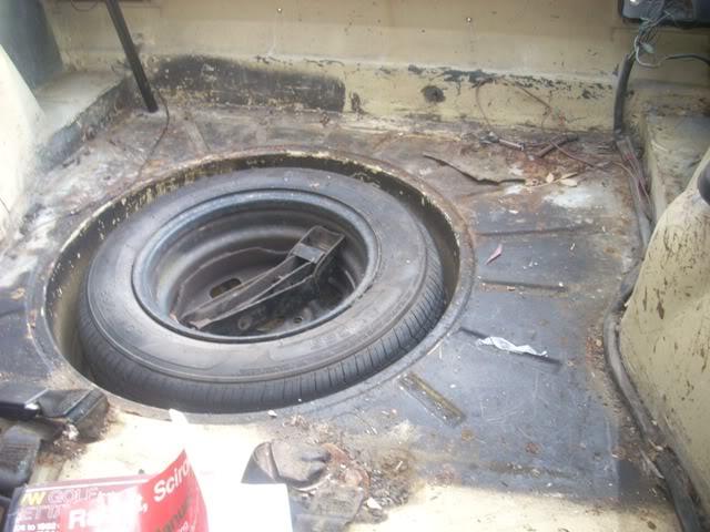

                            Time to start on the rust.

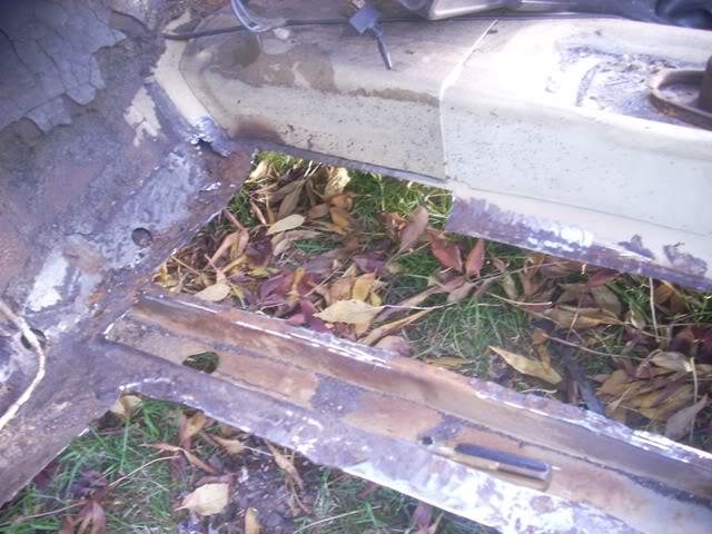

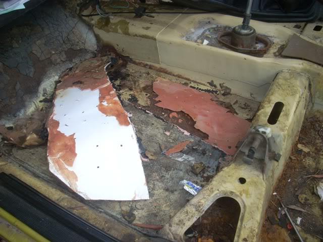

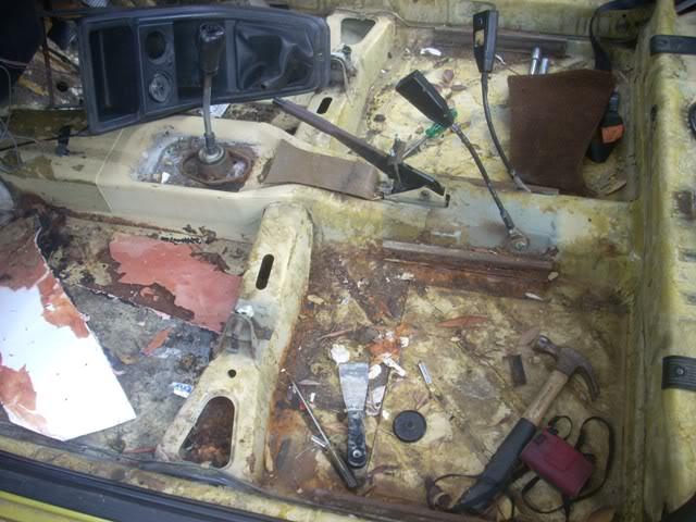

                            Here's what someone did to hide the rust under the passenger side. The sheet of metal was fibreglassed directly over the rust. There were blobs of fibreglass dripping into the rust holes so no attempt to fix the previous rust, just plate over it. I hope the people responsible get to read this.
                            The rest of the floor isn't too bad. That's only surface rust on the rear passenger side.

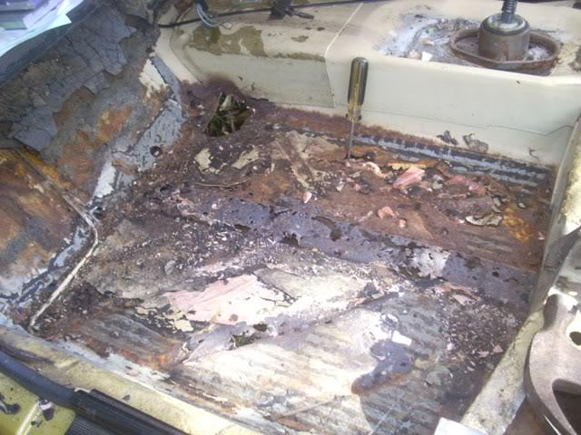

                            All the fibreglassed ground off and you can see how much rust there is.

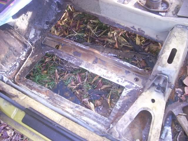

                            Drivers side is pretty good. Will only need a clean up.

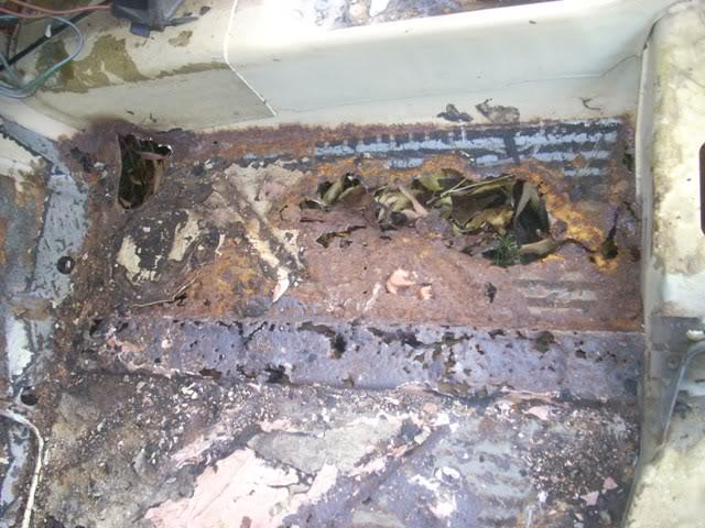

                            Compared to the passenger side which will need this much replaced. Luckily the structural piece is in good condition so all I need to do is weld in the gaps.

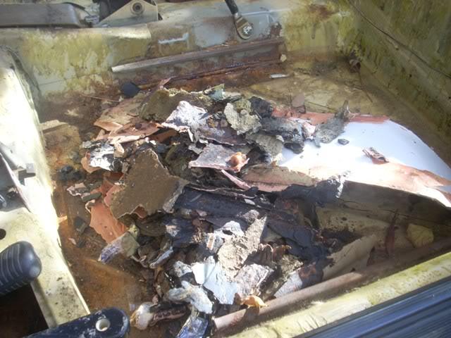

                            This is a small amount of the crap I scraped off the floor. By the time I was finished this pile was nearly twice as big (including all the fibreglass taken off the underside of the floor).
                            Now I need to borrow a mig or tig welder and fill in the gaps. Shouldn't be too difficult and at least the worst of the rust is fixed. This isn't going to be a rebuild, it's work as fast as possible to get the car back on the road. One day when I get a 2nd car and can afford the time I'll strip the body and do a full rebuild.
                            Cheers
                            Paul
