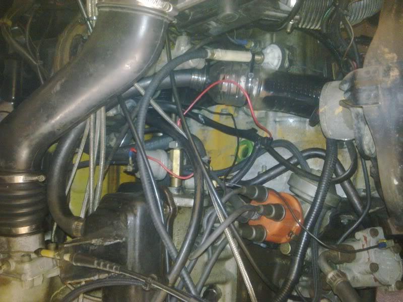

Ok so I installed an oil catch can because my PCV valve was broken and i was sick of getting oil in my airbox.... quite a lot of oil.
Now that ive installed an oil catch can i can see how much exactly,
This was after a 60km trip and im not liking the amount of oil it spits out. What could be wrong and how can i fix it? I dont feel like pouring oil back in after every trip. THe bottle does have holes cut in it for breathing.
Also out of the breather pipe on the rocker cover is practically like a second exhaust as there is a lot of gas coming out. The gas gets into the cockpit when driving which is not ideal. Is this just part and parcel of an oilcatch can?
