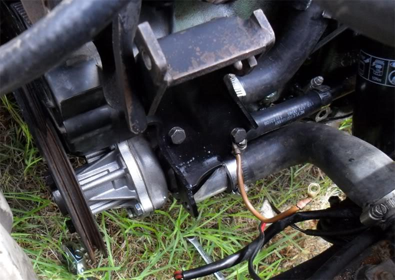

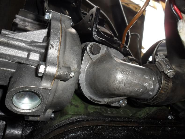

        Pics of the new water pump and cleaned housing:
        Repaired alternator bracket:

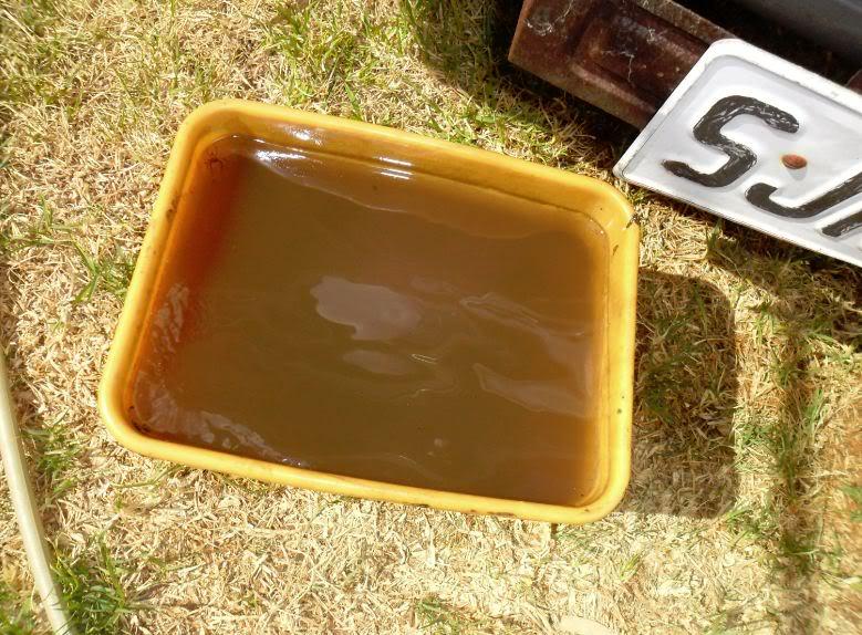

            Spent the weekend flushing out the cooling system which turned out to be a good move as it SERIOUSLY needed it! This is what came out of the car after an engine flush treatment and 30 minutes running (I had previously drained the coolant and refilled with clean rainwater):
            The heater core was completely blocked, so after several tries of flushing and reverse flushing a whole bunch of browny poo gunk let go and flushed through. This had me a little worried about how much crap could be through the engine and blocking the water jackets etc, so I pulled all the hoses off, flushed and reverse flushed and then drained everything and refilled with clean water twice more. Hopefully some mains pressure water will have cleared the worst of it out - and combined with a new water pump and decent coolant, anything left inside the engine will be loosened up and flushed through after a few months driving.

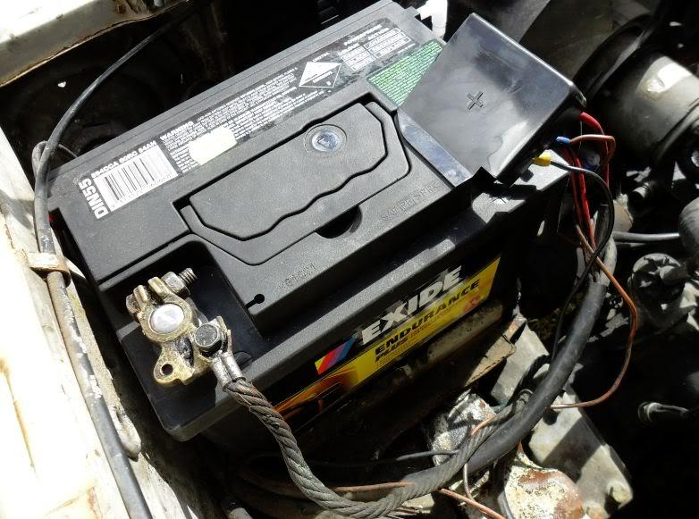

            Very happy with my new battery too, I previously had a DIN66 600CCA battery in there, but I managed to find a DIN55 590CCA battery which does not take up as much room as the DIN66 - even though these DIN size batteries are meant to be a uniform size, they do vary quite a bit in price and capacity - repco had 500CCA DIN 55 batteries around the $200 mark, I found this 590CCA battery at Sprint Auto Parts for around $120 - even some of the more expensive DIN66 batteries were only rated at 550 CCA.

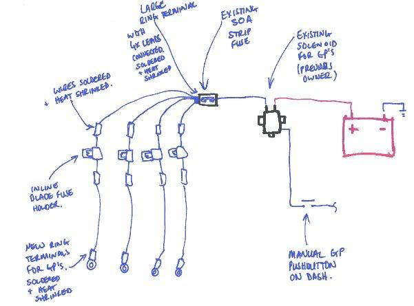

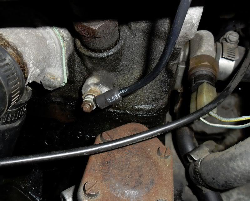

              I've also re-wired my glowplugs, the previous owner had already fitted a dedicated solenoid under the bonnet, so I've run 4 individual wires to each glow plug with a blade fuse inline to each GP. Will post some pics tonight. 1 GP keeps blowing fuses so at least I now know which one is faulty but can still start the car easily on the other 3 GP's.

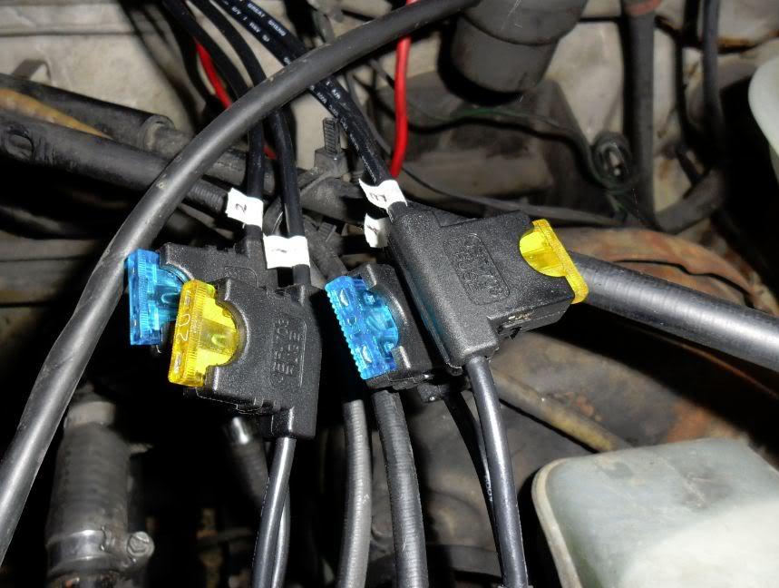

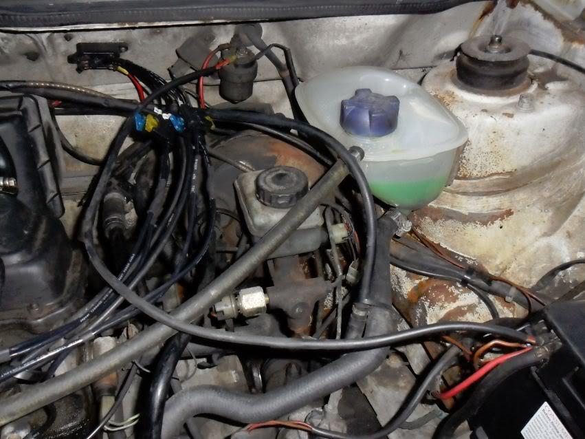

                  Thanks Mick, here's the pics of the aforementioned GP wiring (and my nice new coolant reservoir too!).
                  The separate solenoid had already been fitted by a previous owner. All I had to do was re-route the wiring and create a new loom that consisted of a ring terminal with 4 separate leads going to each glow plug, with an inline blade fuse. The wire is rated at 25 amps and all connections have been soldered and then covered with heatshrink tubing so there are no places to short.
                  Glowplug 1 kept blowing the 15 amp fuse after about 10 seconds, but after changing to a 20 Amp fuse it is now fine - I might have to check 2 and 4 with an ammeter to check they are actually drawing current. Glowplug 3 is shorting out the 20A fuse so that definitely needs to be replaced. At least now it's easy to see which one is shorting and the others aren't disabled when a fuse blows. Even with the solenoid in place the PO still had the glowplug wiring going back through the dash, so I've disconnected the old wiring and all the high current GP wiring is now only in the engine bay. Total cost for the fuseholders, cable and terminals was around $25.

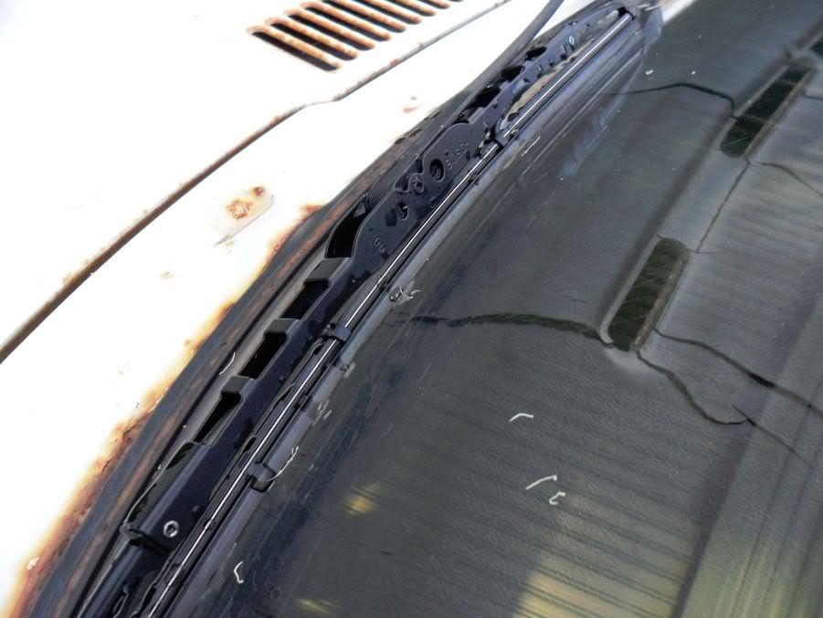

                  Oh, and another easy job was replacing the wiper blades - I replaced the whole blade assembly with new Bosch "DirectConnect" 16 inch blades - when I put my order for all the gaskets etc to fix the water pump I added these to the cart - at $3.88 they are a bargain (and around the same price as rubbers at my local car parts place). Well worth getting the next time you order something! Good quality and they just click right on to the old arms.

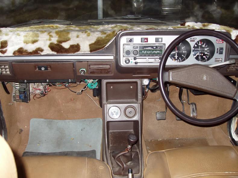

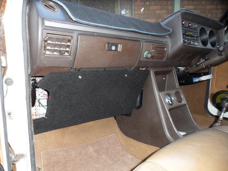

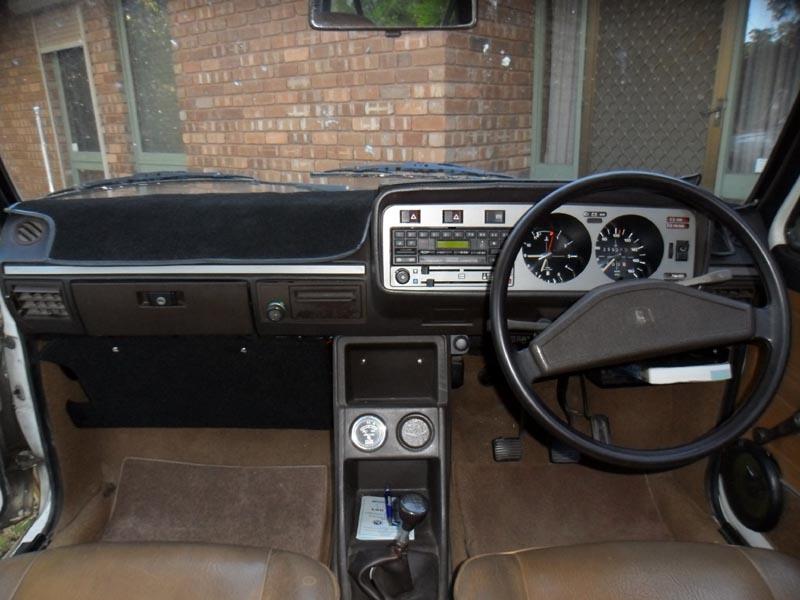

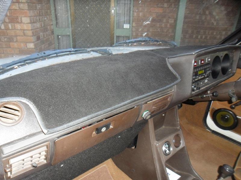

                      But in between things I have been able to do little bits and pieces on the GLD. Most of it has been to do with removing old crappy wiring and replacing with new, plus a lot of tidy up jobs in the interior. I managed to get a dash mat, make a trim board for under the passenger side, fixed the ignition switch, rewired the glow plugs and radiator fan - I put in a relay connected to the temp sensor and also rigged up a manual override switch using another hazard light switch. Combined with some general tidy up the interior is now looking much much better than when I first got the car - Here's the before shot:
                      And as it is now - it's a very tidy and nice place to be! :

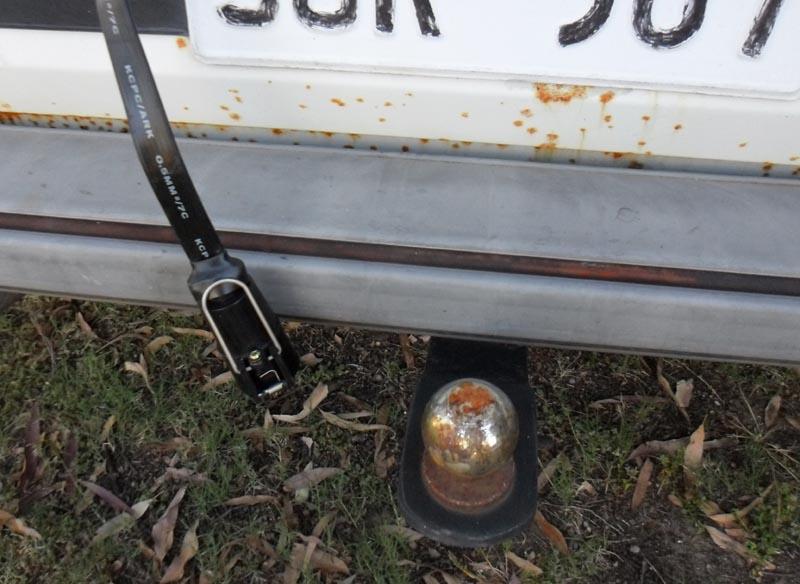

                      The towbar has also been fitted and wired up. Wiring was super easy using some piggyback spade terminals off the rear lights. Easiest trailer wire-up I've ever done and no need to cut any of the loom!
