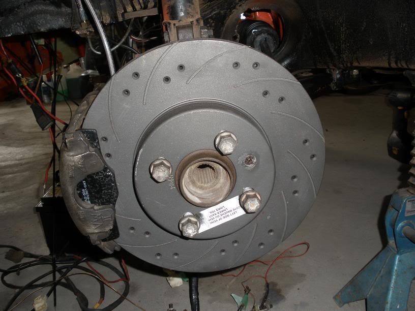

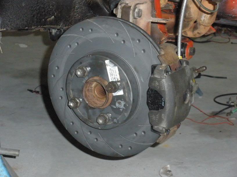

    Guys awhile ago i installed a TSR 280 brake upgrade into my mk1 rally car and it works mint. Now i'm upgrading to VR6 280mm brakes and am trying to figure out what to do with the near new 280 upgrade kit. The Kit uses STD MK1 GTi calipers with special offest black diamond combination discs and a machined adaptor plate. Just seeing if people here are interested in getting some more adaptors machined up (probably donate the design to roccodingo) and i'll get in some more discs. Beauty of this package is excellent stopping power without needing to upgrade the master cylinder or booster to get the most out of it (for the record i did both as it is a rally car but works great on my dads diesel right now which is stock). This is a great low cost (about $350 ish) upgrade which really performs on the street and at the track. Let me know what you think.

    I had a 270mm kit form TSR years ago. Awesome brakes. Are the discs not plain 280s, G60?
    Gavin
      yeah pretty sure the tsr caliper offset bracket requires a diff disc offset but i will investigate with stock 280mm cordoba discs and let you all know, much cheaper then if that works

        Does this make a big difference considering you are using the stock gti caliper setup?
          It makes a huge difference, the brakes pedal feels weedy still but you can stop hard.
          Gavin
            I cant understand how though? your still using the same amount of contact area on those bigger disc's as you would be on a stock vented disc..
            Maybe there is a different caliper you could use to increase the contact area?
            <space for rent>
              OK time for a physics lesson guys, it is called moment of inertia or torque. The same force applied over a longer distance from the pivot leads to a greater torque being applied hence spacing the caliper further from the hub whilst applying the same force increases the torque, in this case braking torque, Think of it like using a spanner then putting a breaker bar on the spanner, much easier to apply greater force isn't it. This is the principle behind this brake upgrade as it spaces the caliper 50 odd mm further from the hub than stock. Yes the braking surface area doesn't change but hey it is like max spend of $300 odd and great bang for your bucks for almost twice the stopping power (well don't know for real but these things pulled up nothing like a mk1 GTi brake setup, pissed all over them. Proven to work so much better in competition.
              Yes putting bigger calipers on will again improve things but that adds big big cost as you have to custom machine your hubs, source calipers and then upgrade the booster and master cylinder. I'm trying to help out and give all mk1 golfers a cheap upgrade which will revolutionise the mk1 braking capabilities. The only reason i'm upgrading is to use that bit more of a braking surface area as my car is purely for racing and there a bigger still gains to made and hence time to be saved.
              This kit requires only mk1 GTi calipers to work and nothing else.
