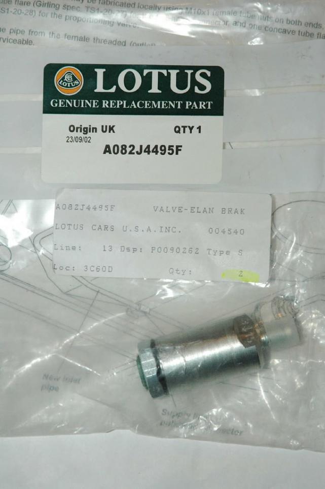

        They're also still available from Lotus.

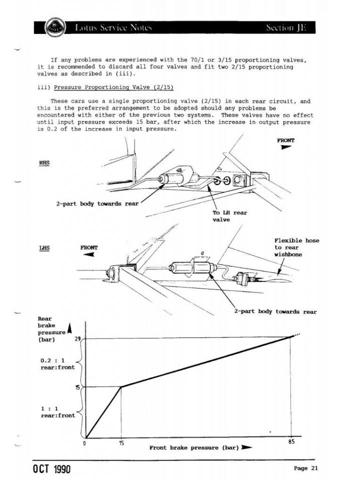

                  As my wheel fell off last week due to a failed drum bearing, I'm re-looking into my disc conversion...
                  I have everything I need, except for the rare as 3/15 prop valves...
                  However, after speaking with one of my friends who works in a brake shop, he suggested that I just cut off one coil from the spring inside a 3/35 unit, which will lower the '35' part of it.
                  They had to do it to a car (not a golf) earlier in the week as the rears were locking first, and the technique worked well.
                  So, keeping that suggestion for a last resort, I then spent several hours trying to find the spring dimensions that Rocco mentioned above, but to no avail.

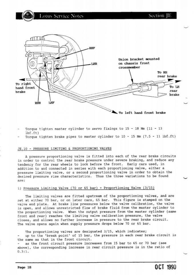

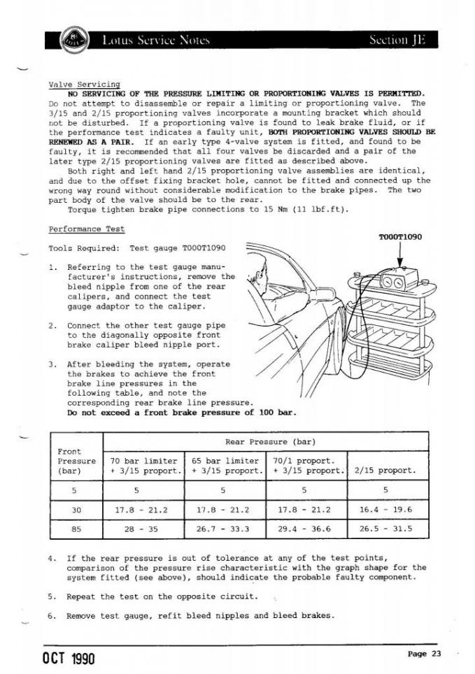

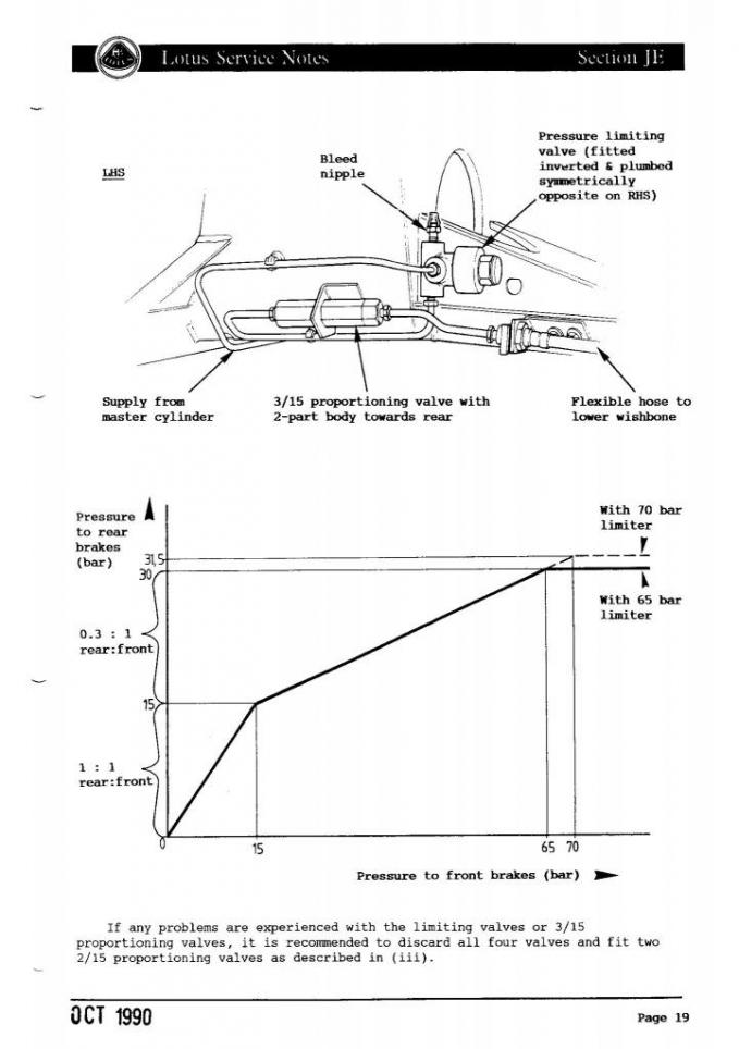

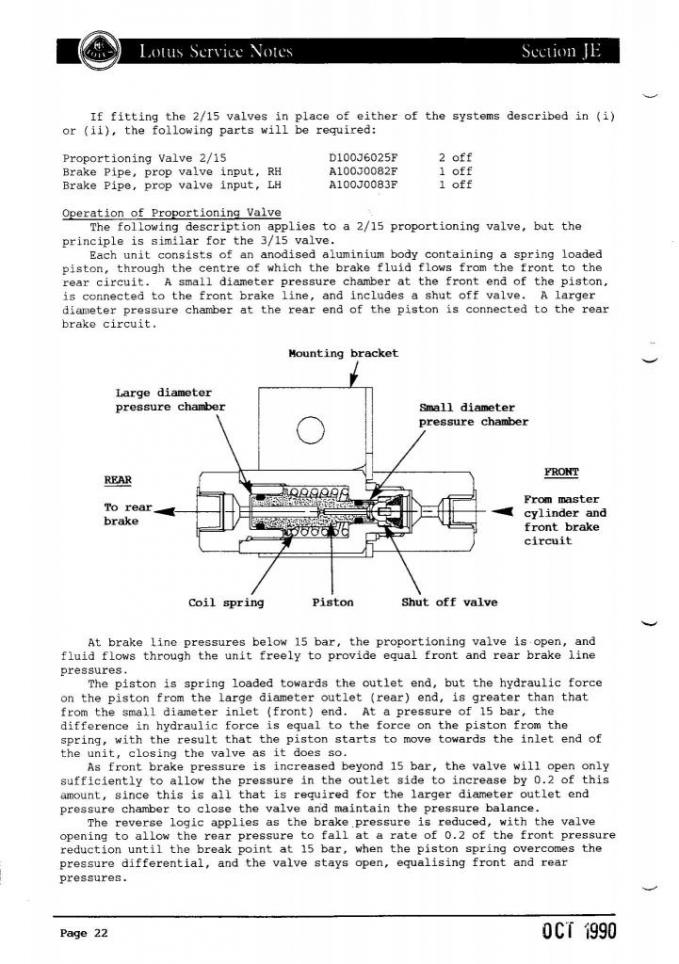

                  I did however, stumble accross this post on a Lotus Forum
                  To progress this to a conclusion I need to know how many people would be interested
                  I have the spring spec to convert a Vauxhall valve at 3/what ever to 3/15 so I can get the springs made
                  Spring rate 4.58 N/mm
                  33mm long
                  14.1 od
                  10.9 id
                  16 gauge wire diameter
                  7 coils ground ends
                  I have a wholesale supplier that may be willing to sell his stock all be it limited of Vauxhall valves so that may give us 50 or so
                  I can get the end that allows the valve to be fitted in the fixed pipe work made to eliminate the problem with stripped threads
                  Cost at a calculated guess about £35.00 each for a complete replacement unit.
                  Bob

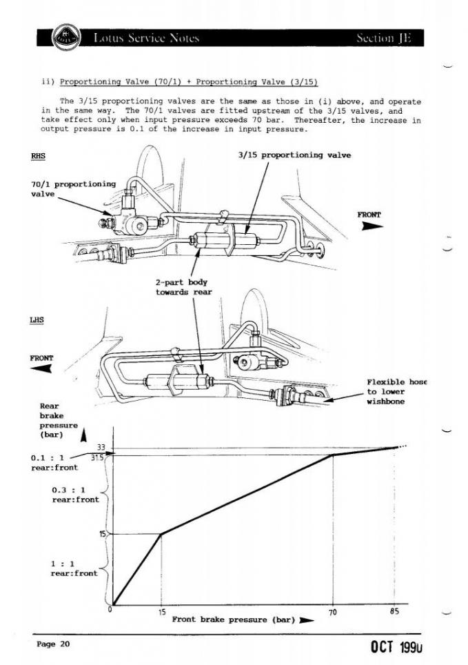

                  Indeed, that whole thread is very interesting as the elan uses a similar setup to our Mk1's.
                  Also, this post from the same site explains the system, and how it works, very well.
                  So, now the questions are,
                  Has anyone got a damaged 3/15 they can check the spring size?
                  Have you stumbled upon the 'correct spring' elsewhere, and are being 'selfish' and not 'sharing'? (lol)
                  Does anyone have some 3/35 valves fitted that they have modified?
                  etc.
