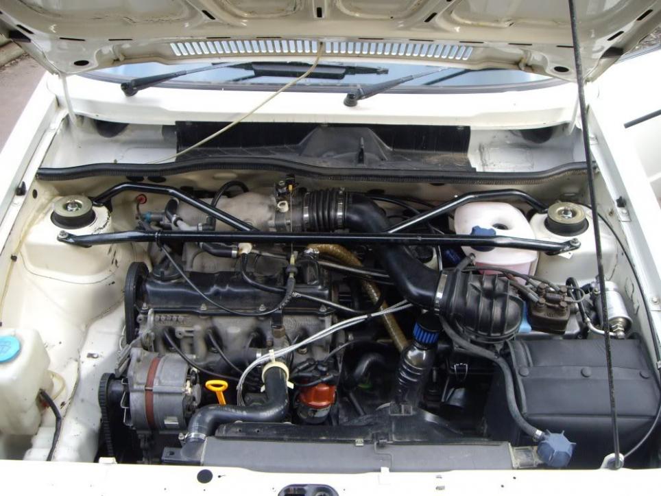

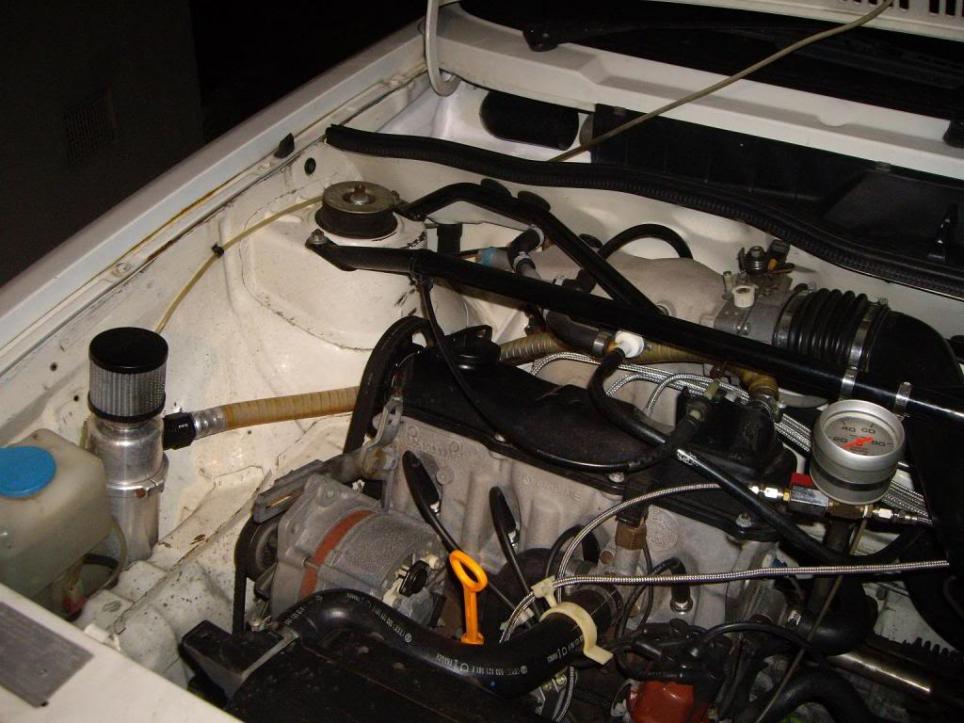

I had just mounted my "powerade" bottle with a breather/filter straight off the clutch cable & plumbed it on with some food processing reinforced hose.
Worked a treat

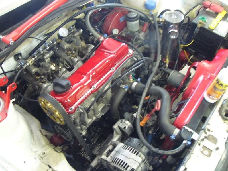

Then relocated the whole lot with a bit more stronger moroso billet bottle & breather. Same type of hosing though

With it plumbed back it can also oil up your intakes & throttles, especially on K-jet cars, so thats why I route it to a catch can & block up the intake so it only gets nice clean filtered air & not filthy oil vapours
