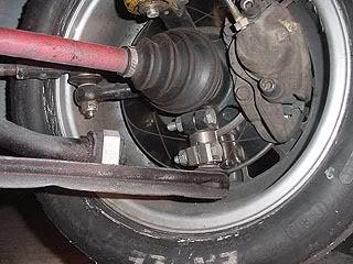

    I am running these, I actually have Valvers old set. I flipped the tie rods in conjunction and everything is level. Mind you my car isn't ridiculously slammed or anything. I did change a few things at the same time as this such as a 4 point lower brace, and larger sway bars, so its impossible to isolate the handling difference from just the extenders, but the car is definitely sharper, more stable and less bumpsteer.

      www.PMWltd.com .....here's some pics of their work looks like quality stuff
      and their double A arm set up

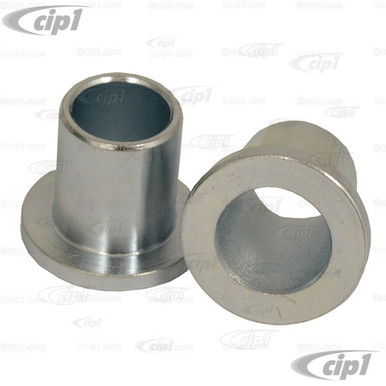

      these guys also do the flip kit for tie rod ends for anyone intereseted
      These will also work made for Aircooled beetles and are 20 bucks cheaper
      c12-6613-11 - tie rod relocation bushings - flip-it bump steer kit - beetle / ghia / super beetle - pair (all ball-joint or king & link)

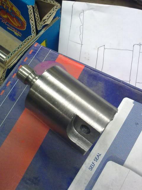

          im halfway through getting some machined from 4140
          they are longer than the pmw ones as my car will be super low and has enough room in the wheel to accommodate a little more drop/seperation

              my extenders are a full 50mm of raise
