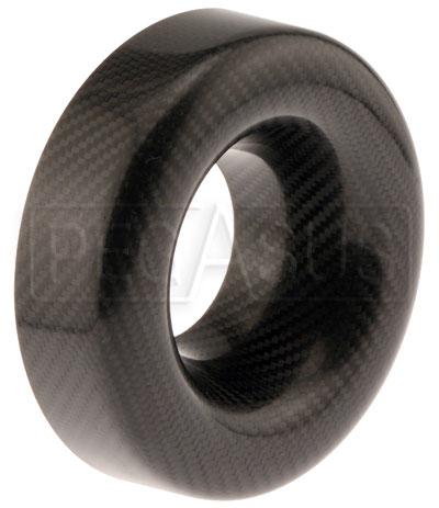

Here you go, you can even get dummy headlights to take the scat pipe.
These are expensive but a good example, I'd be looking for a PVC pipe flange down at Bunnings.
Pegasus - Carbon Fiber Venturi -Style Headlight Cover, specify size
