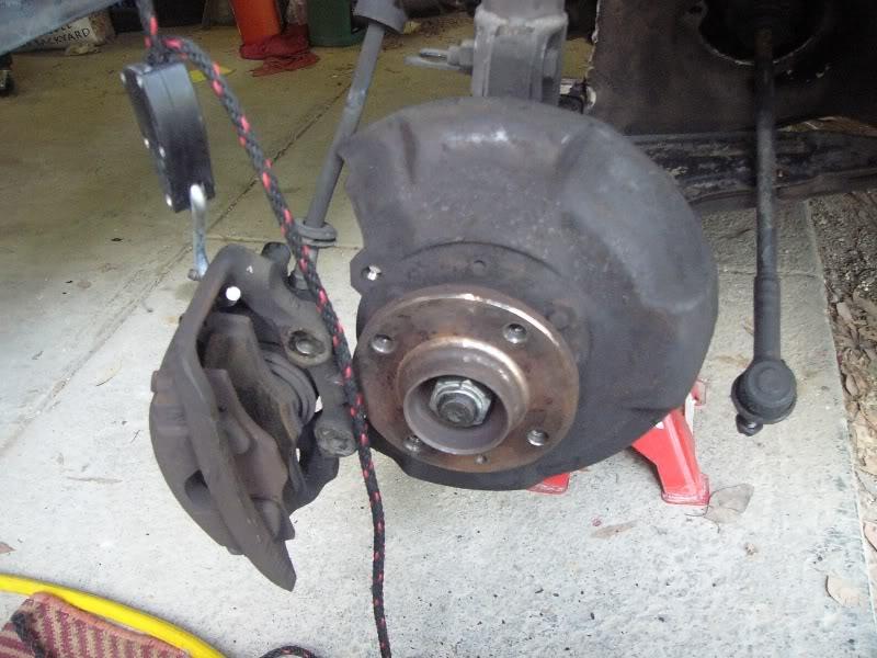

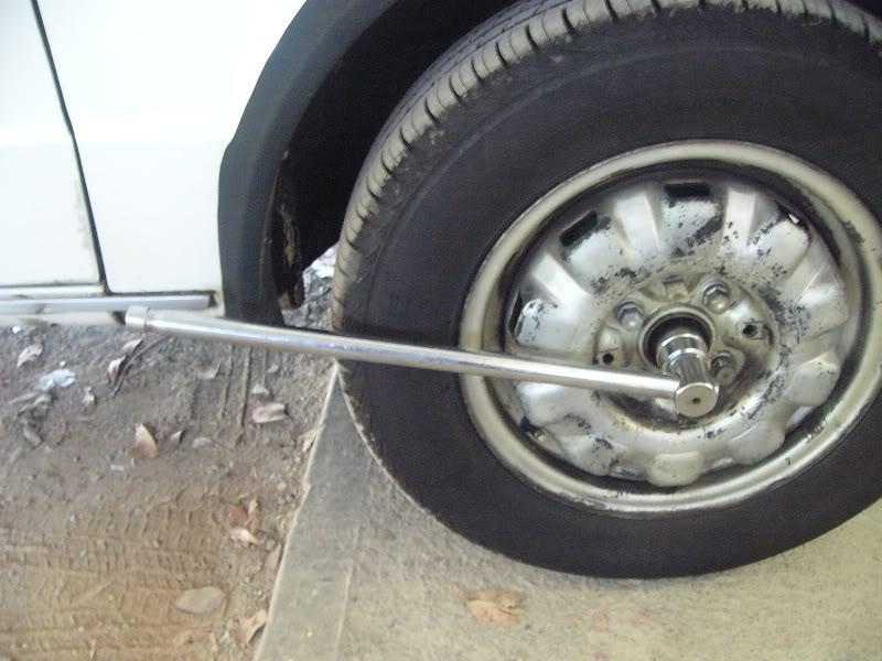

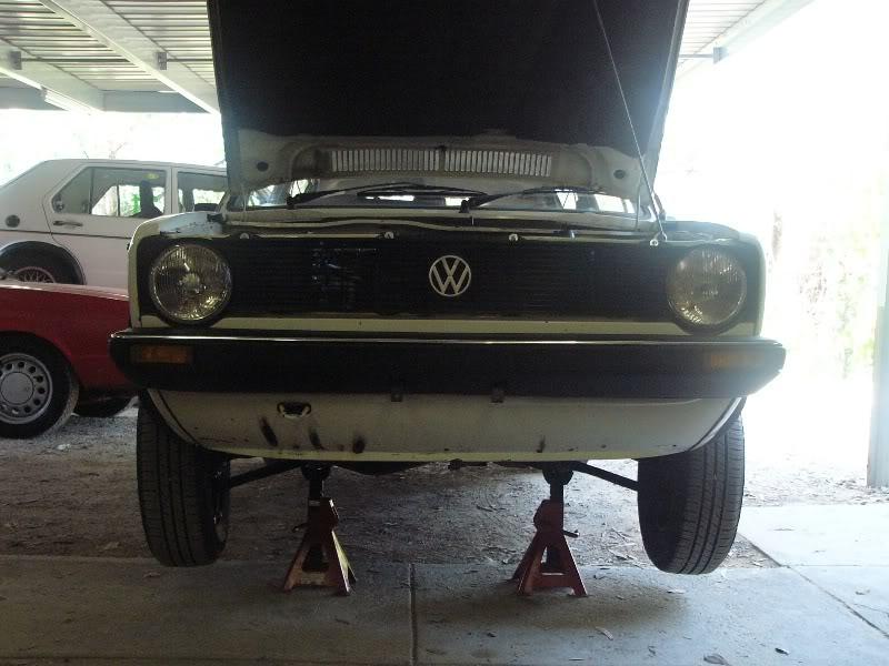

Loosen off the axle nut and wheel nuts.
For the record this is a 3/4" breaker bar and the socket is 30mm.

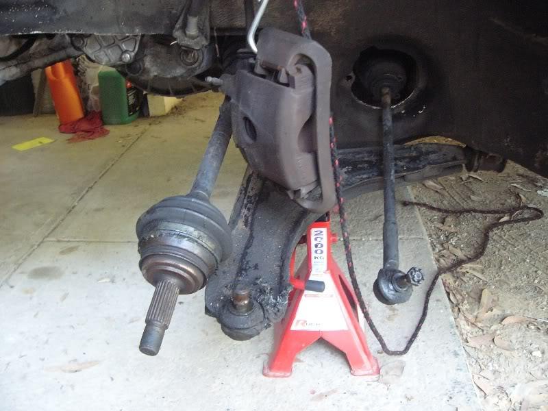

Jack it up and put it on stands.

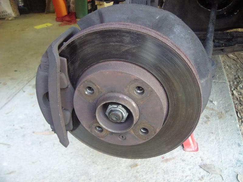

Pull the disc and caliper off.
Support the caliper so there's no weight on the hose.

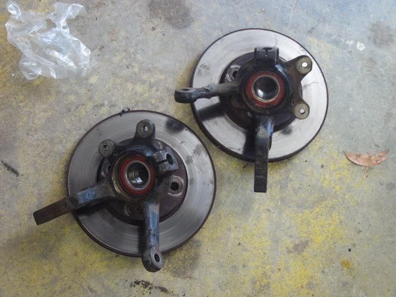

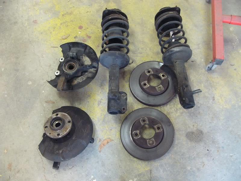

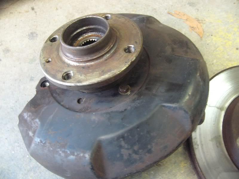

Remove the hub. Two bolts on the strut, one on the ball joint and one nut on the tie rod end.

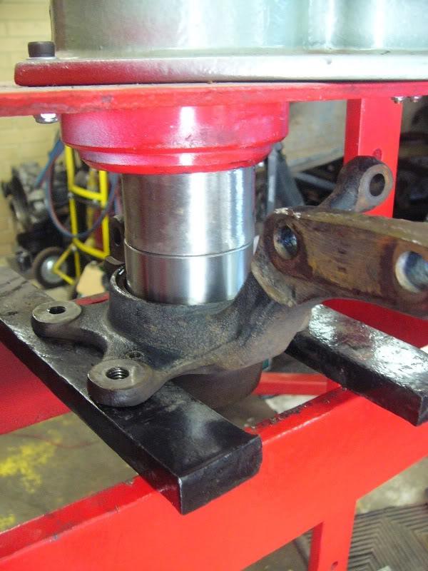

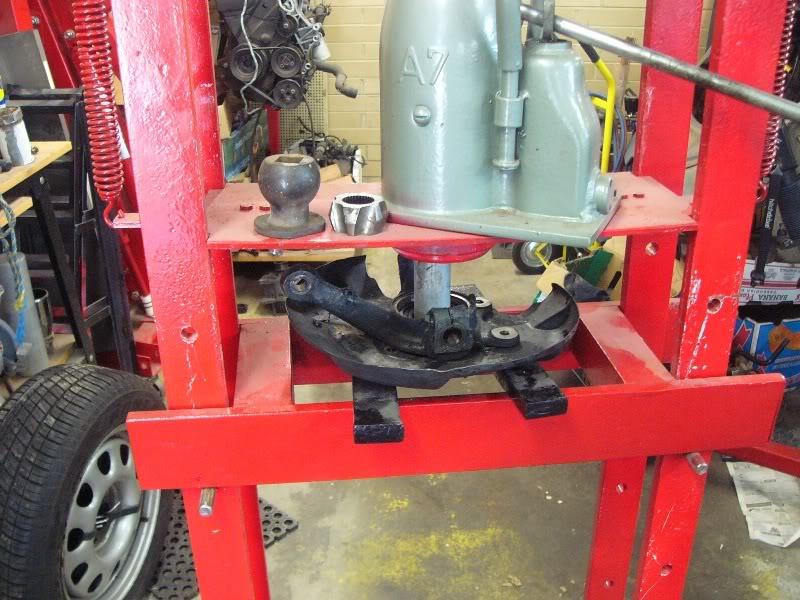

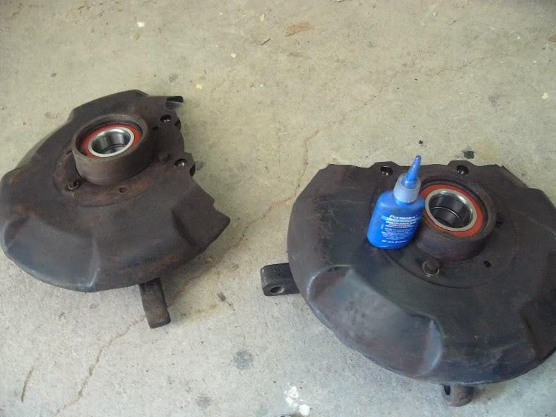

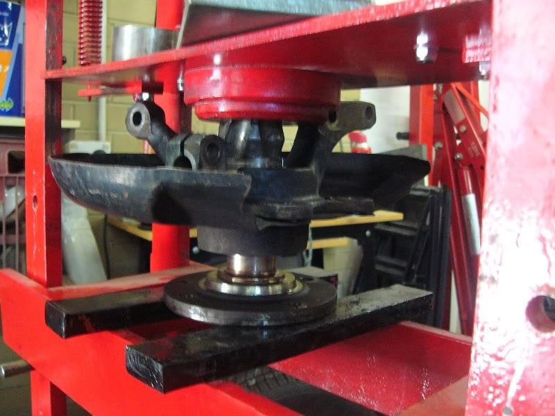

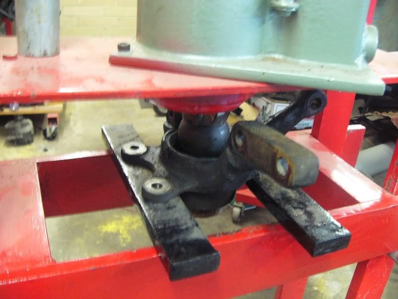

Press out the drive flange.

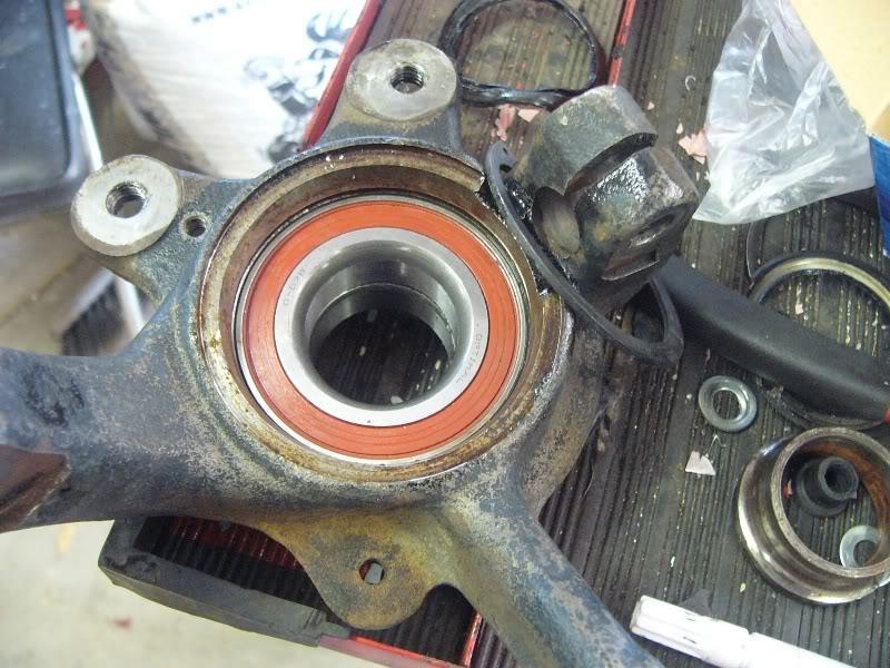

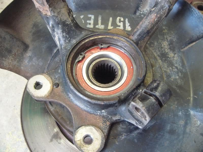

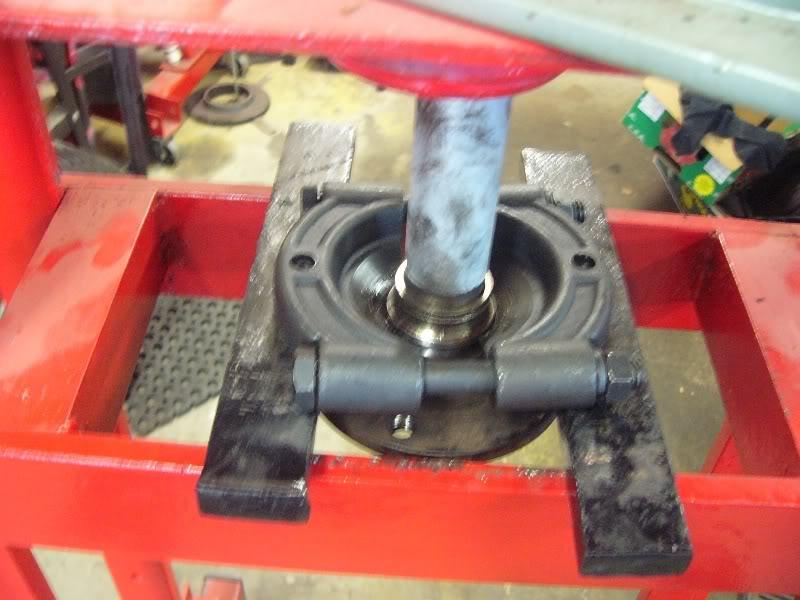

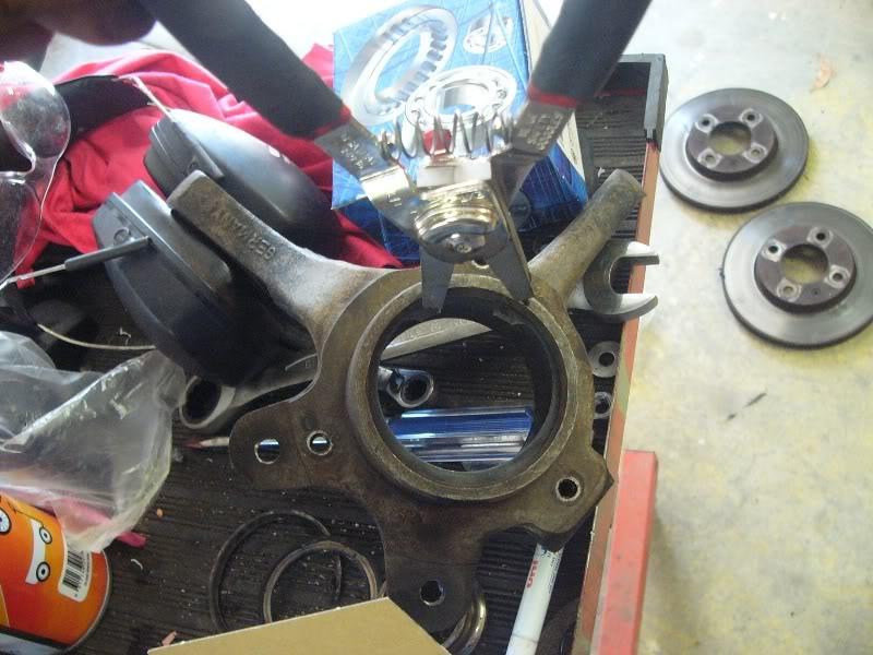

Press out the bearing after removing the circlips.

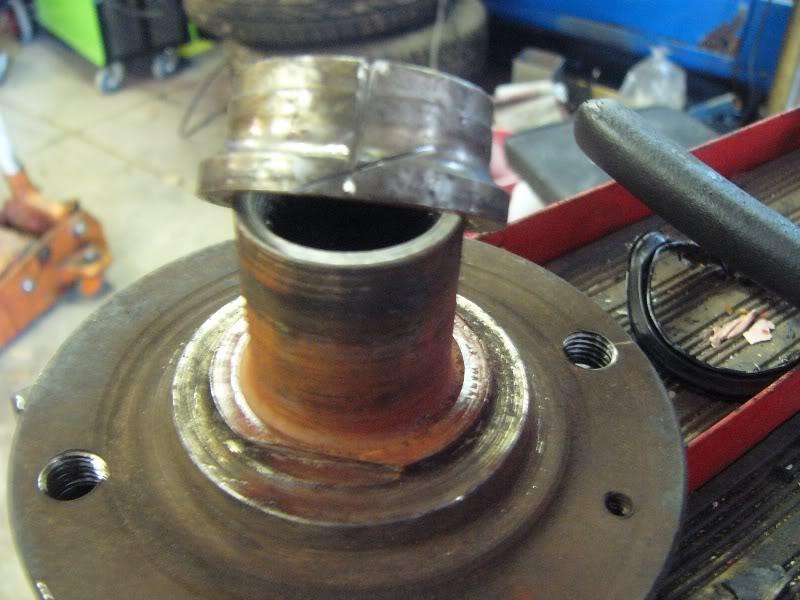

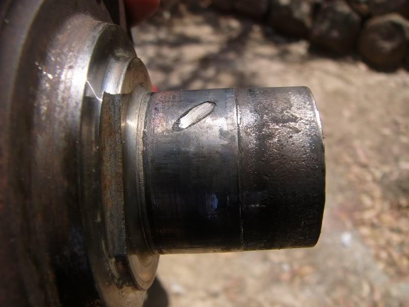

Press the inner race off the drive flange. (They always get stuck on here.)
So stuck in fact that I had to cut this off with a Dremel.
