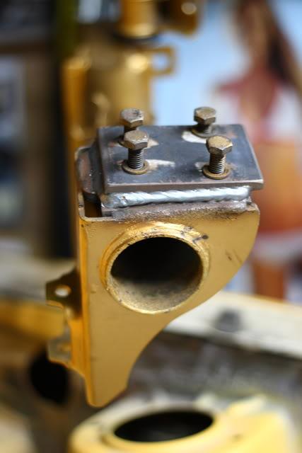

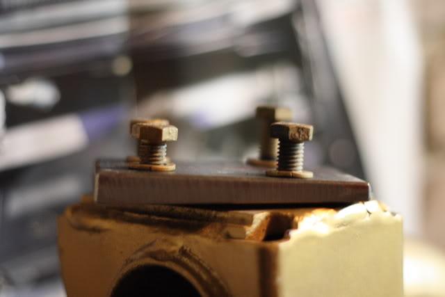

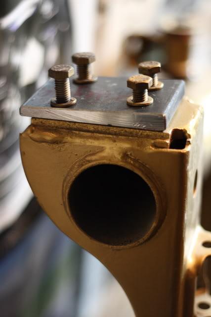

    • working on some camber plates, cut to 3 degrees will weld them up tommorow, and unlike alot of camber plates/adjusters these will let the bolt remain straight and not put any extra tension on them

        • I'll be interested to see how those plates turn out, as I've wondered alot about these things...

                  nice weld BTW.....
