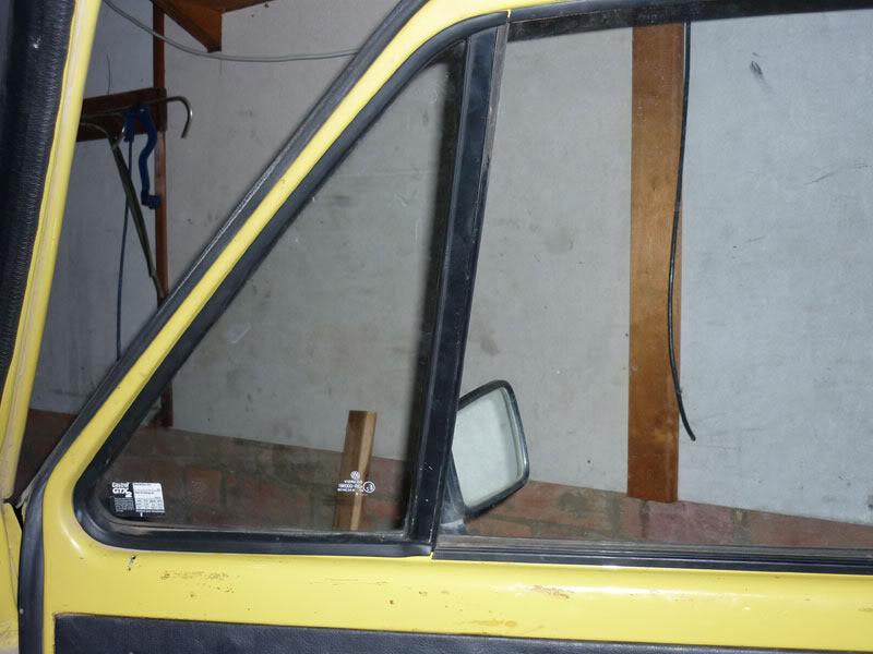

        Not quite following you Preeny, is that to reattach the window the hinges or to seal the 1/4 shut?
        Ahh sorry dude. To reattach the hinges to the glass. Fix 'er up back to original.
        • #34
          Nice find! its getting harder and harder to find rust free mk1's.
          If you dont want to be able to even open your 1/4 windows you can just sikaflex around the rubber seal its great stuff but dont get it on your fingers!

            Not fussed whether to open them or not, the main issue at the moment is both of the latches are missing, both the windows seem attached to the hinges though. If I can get the latches I will put them back to original.

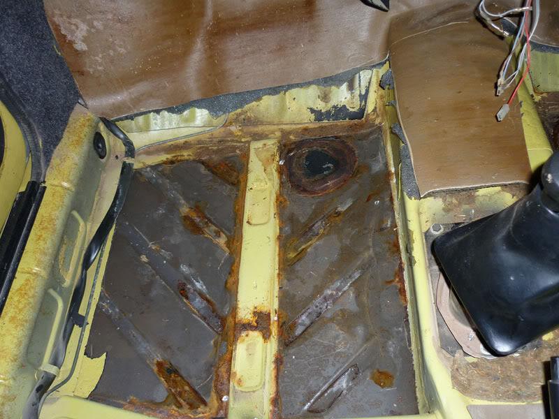

              So i've been out doing some work on it finally, I want to drive it down to DOVW so some tidy up is in order.
              Swapped out the taped up opening 1/4 vents for sealed ones lastnight, much better and much more secure!
              Decided to pull up the carpets and take a look.

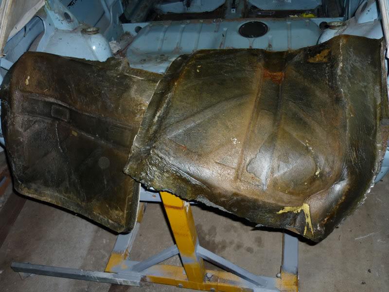

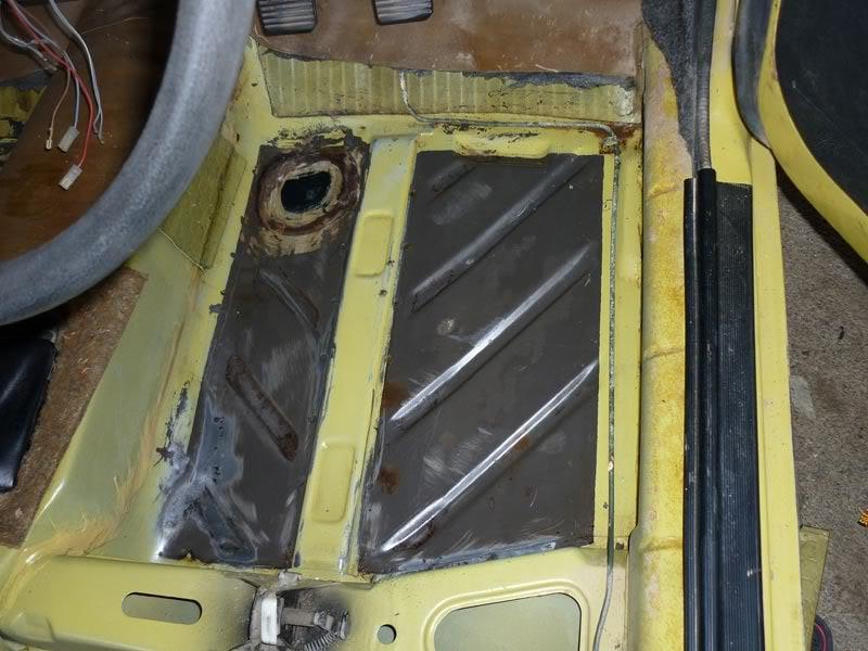

              Wet Carpet: Check!
              Wet undermatting: Check!
              Wet noise sealer stuff: Check!

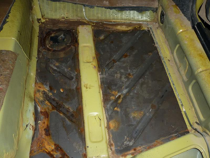

              Rusty Floors?..... nah not really
              There was more mud and dirt under everything than rust.

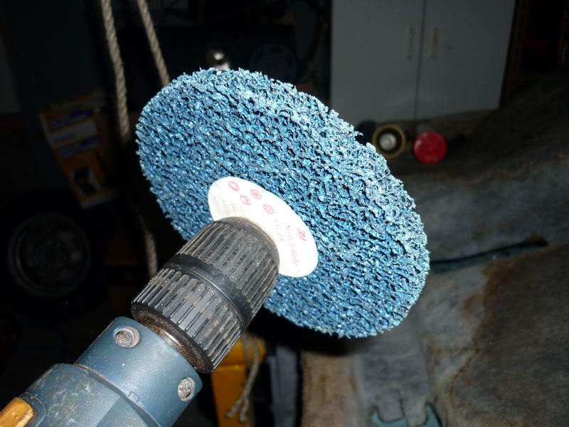

              Gave it a quick hit with this and some 80grit and its all clean still got to clean out some of the mud and rubbish...
              Trying to work out how i want to treat it, can you buy POR15 in a small tin? i've got some rust converter I will put on for starters so it's all good and clean.
              Is that padding just to keep noise out? that stuff holds so much damn water! the passenger side was dripping and this car gets garaged!
              Any alternative to it that are better? Dynamat?
              Got some more work lined up for it, you will have to wait and see, should be looking good for DOVW

                  nice mate, I've been through the redoing of the floors
                  I just painted mine with Stonguard which works well Also you dont really need that sound deadening stuff

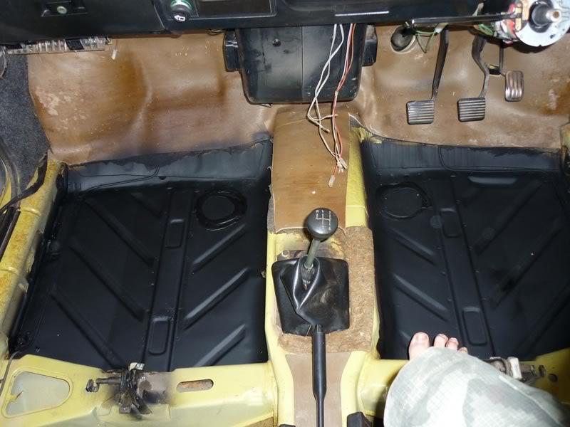

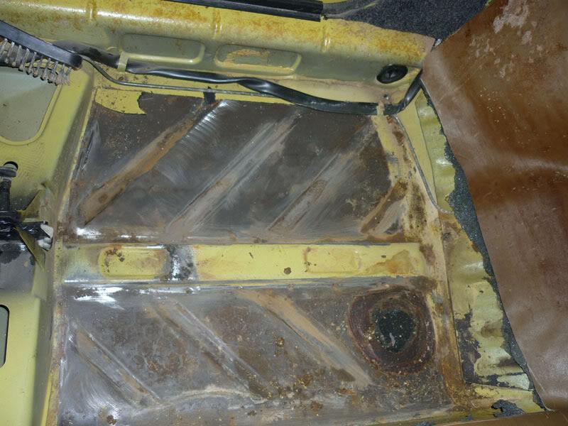

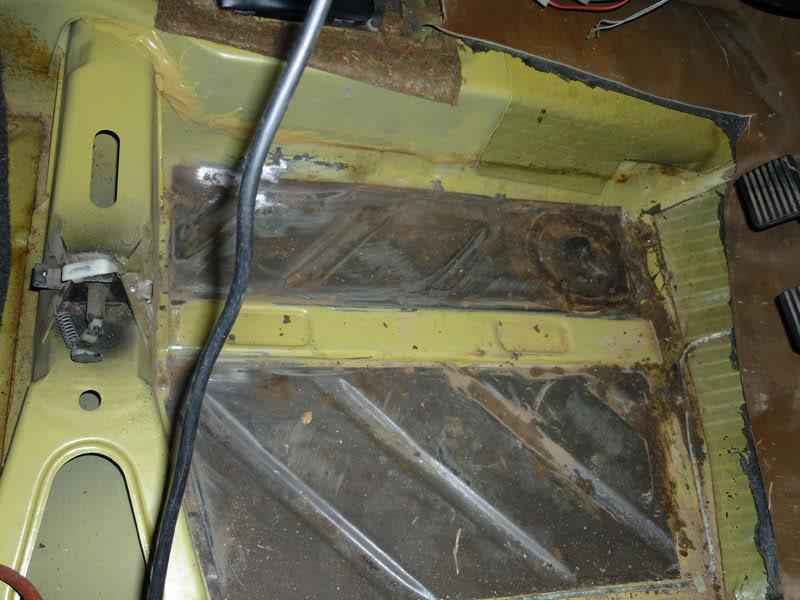

                                Was away most of the weekend but got some work done on Saturday morning. Couldn't get any POR15 so grabbed some other spray on sealing/sound deadening stuff.
                                Cleaned up the area and prepped it for the sealer.
                                Got home yesterday arvo to find it all dry and looking good. ( I did mask it all up, just didnt take a pic of it)
                                I want to pull up all the sound deadening stuff and buy a pack of dynomat to cover it all with. I think I will coat the firewall with the sealer, was easy to use and has a nice thick coating.
